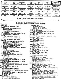

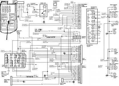

There is a fuel relay in the relay center, make sure the black wire from the relay is grounded,then replace the relay.Jack the car up and check the connector at the fuel pump, making sure it is tight.
Attempt to start and have an helper to listen to the fuel pump through the filler neck,if there is no buzzing sound,I'll suspect the fuel pump.there is no fuel shut off switch to be reset.. Debris in the fuel tank when empty could have cause high resistance in the fuel pump causing it to stop working.Ask your mechanic to clean the tank when installing a new pump.

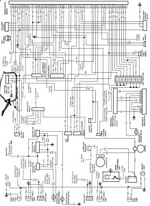

I understand, all relays look same( black boxes) but here is a simple way to test it.switch places with them (move the right one to the middle, the middle one to the left and the left one to the right )then start the car.
check also fuel pump fuse,in the fuse block.(sending the diagram)
Check the connector at the fuel pump underneath.
one thing is for sure"the engine is not getting fuel base on your diagnosis by spraying gas under the hood"
if you have basic tools and think you can replace the fuel pump , I'll guide you.
