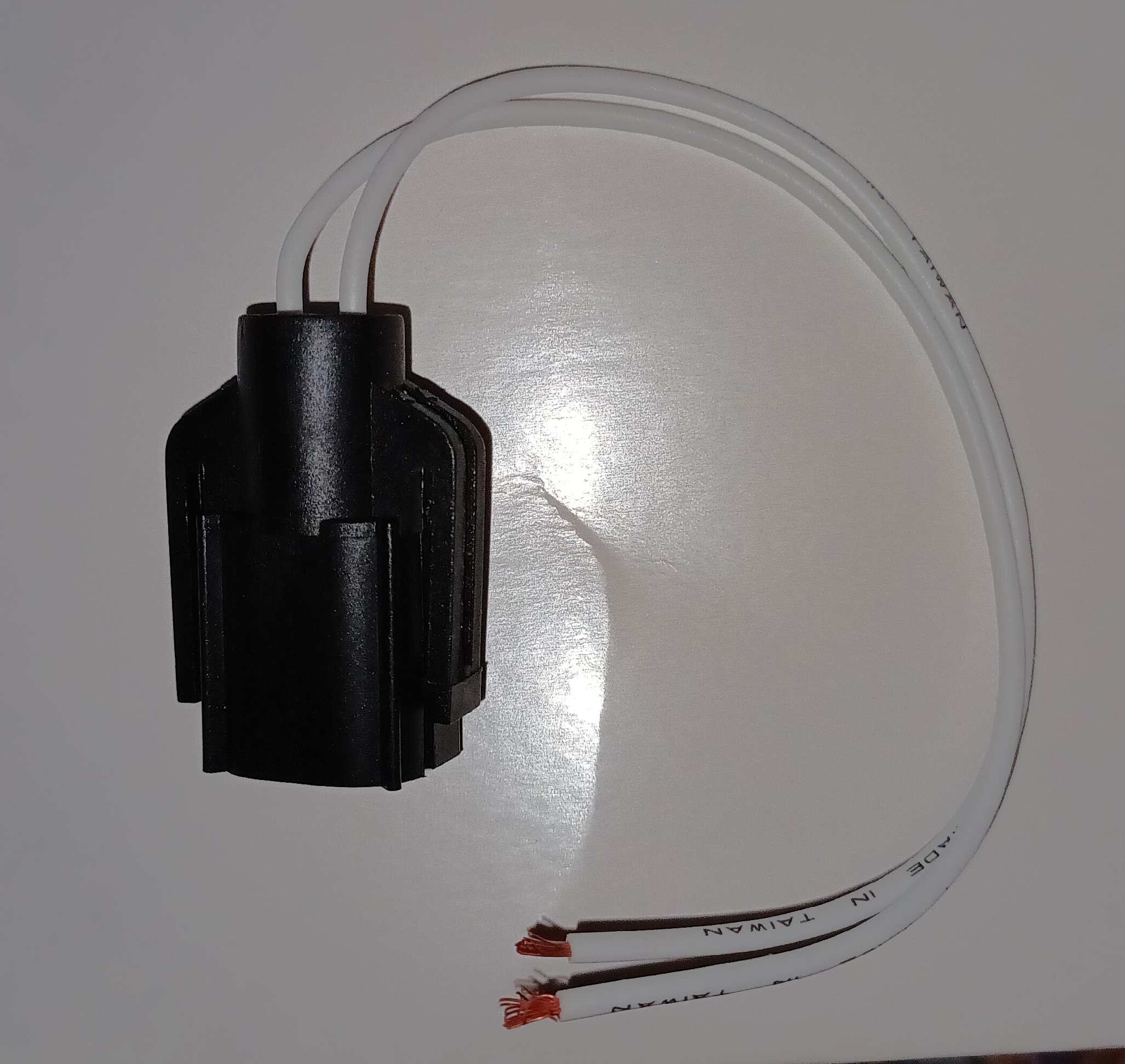

LOL I honestly think they can smell me coming lol I think my next move will be trying and get the connector for the speed sensor replaced. I might as well go for a cheaper option at this time. Who knows it might fix the problem. I do have a question though. Just how bad does a bad speed sensor have an effect on a vehicle anyway? I know it will cause the ABS light to come on of course but since brakes are mechanical doesn't seem like it could cause someone's brakes to be kind of hard to press one min and then spongy the next min. Can it? Sorry to be asking such elementary type kind of questions but I am just trying to get a clear understanding of them is all. I've watched a lot of YouTube videos but none of them seem to get to the point etc. If anybody looking for the part number for the speed sensor connector etc its PT1983 and the gm part number is 88860538 at least that's the part number for now anyway.

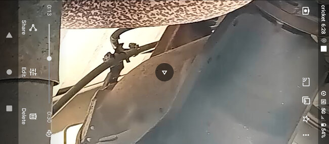

WARREN1814
  • 145 POSTS
Here is the best picture I could get of the speed sensor / connector etc. You may have to download the picture to see if you can see it better. I know it's not too clear, but it's the best I could get. And no, the speed sensor connector hasn't been changed yet. But the speed sensor has (2 times).
Sunday, October 8th, 2023 AT 8:34 PM
  • 109,885 POSTS
I do see it in the picture, but really can't make out too much. Has the new connector been installed or is that the original one?
Sunday, October 8th, 2023 AT 8:40 PM

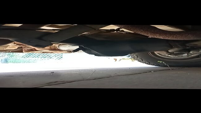

WARREN1814
  • 145 POSTS
Yeah, i kind of figured it would be hard to see. and no, the new connector hasn't been installed yet. The original one is still on there. i was trying to get some pictures of it before having it installed. Maybe this little short video clip i shot may help a little bit. This link is to my YouTube channel. The clips below you won't be able to see it at all. https://www.youtube.com/watch?v=glSFQtqYu-4 If you still can't see it very good i understand... well at least i tried.
Sunday, October 8th, 2023 AT 8:43 PM
  • 109,885 POSTS
I do see it, but really can't notice if there are any issues with it. I'm sorry about that.
