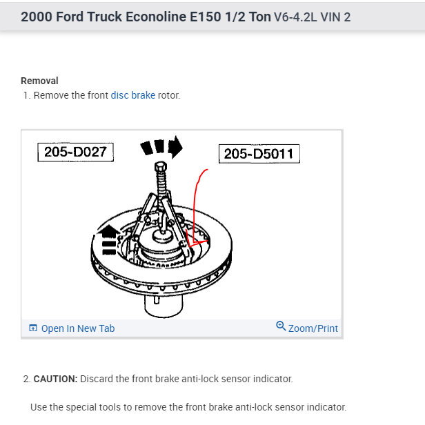

The rear anti-lock brake sensor indicator (tone ring) is attached to the ring gear in the differential. It is necessary to remove the ring gear in order to remove the rear anti-lock brake sensor indicator.
As far as the front, they are mounted on the inside of the brake rotor. See pic below.
Let me know if this helps.
See pic below.

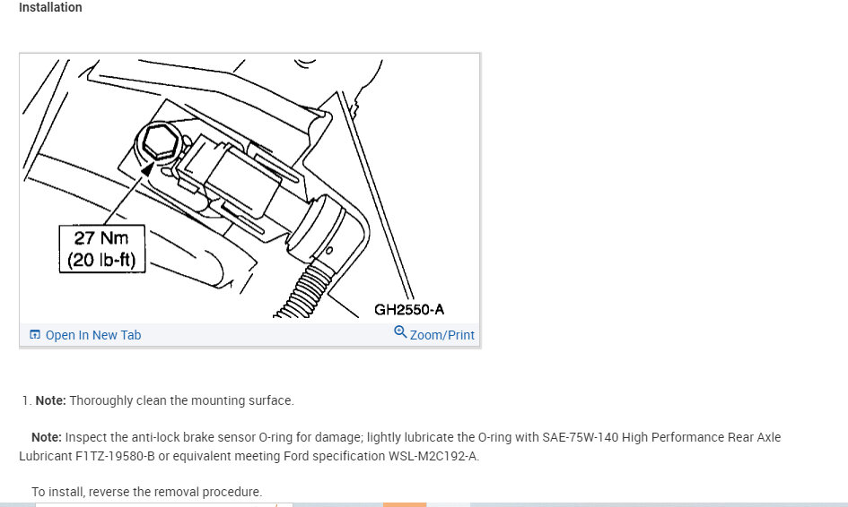

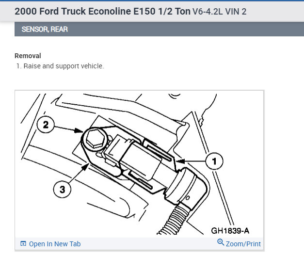

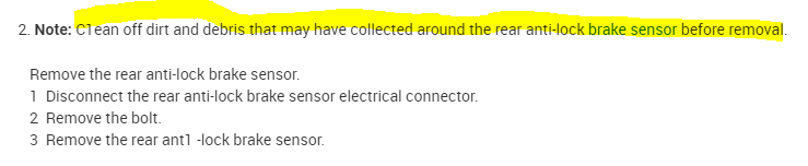

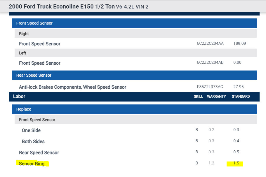

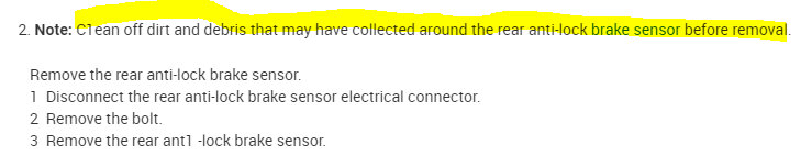

The toner ring in the differential usually doesn't fail. What I have seen happen is they get corroded with dirt. Before taking it to a shop, remove the sensor and see if there is a build-up of dirt on the ring. You may want to consider removing the differential cover and servicing and cleaning everything.
If you look below, I attached the labor (flat rate) time for replacing the ring. It calls for 1.5 hours. It doesn't provide a part number, so I have a feeling you may have trouble finding one.
The remaining pictures are the directions for replacing the sensor. I'm suggesting this because by removing it, (not easily) you should be able to determine if it is a dirt issue. There could be dirt on the sensor or on the ring itself.

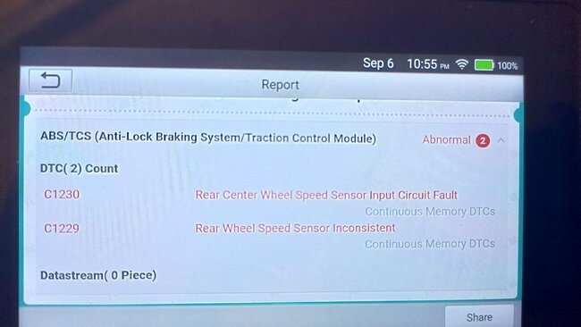

Oh, oh okay. I was wondering how that worked. Well, here is the error code that came up while driving home today. It's not a new code but i took a picture of it and maybe you guys can make sense of what the scanner is saying. It's the same code as before but this time it was scanned with another scanner. Well i will update you guys on the ABS tone ringer tomorrow.
Sep 6, 2023 at 1:16 PM
  • 110,241 POSTS
Based on the scanner, either you have a faulty sensor, the toner ring is corroded/dirty, or there is a wiring problem.
Have you checked the wiring at the sensor on the rear axle? Also, is the connector in good condition and not corroded or damaged?
Just out of curiosity, does the sensor appear new? I remember you saying it was replaced.

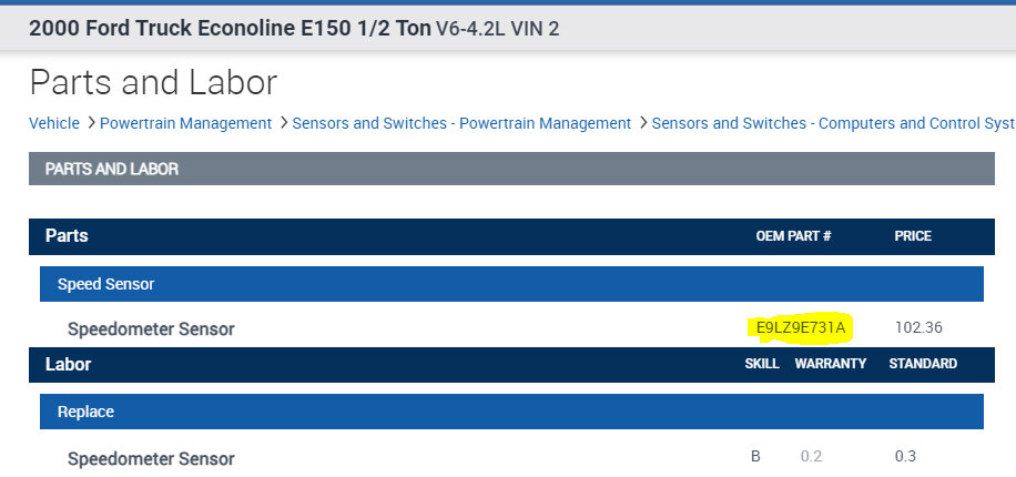

Well, so far i haven't had anybody to check for me to see if the wiring or connectors are bad yet. But i am still working on it.. But i do have a question. Perhaps i should have asked this question from the beginning. How can you tell you have the right speed sensor from the parts store that fits your vehicle? Because i was looking at them online and they have a lot listed but some look very different from others. Most of them on carsparts.com don't even tell you where to install them. Could it be i may have bought the wrong speed sensor for the back of my van etc. Just asking. Reason i ask is because the speed sensor they told me they put on there... the auto repair shop bought the part and i didn't. Normally i buy the part and had it to them. Like i did with the toner ring. When i look up speed senor parts now, I am seeing they have a speed sensor from AutoZone but it doesn't say it goes on the differential. It says transmission or transmission shaft etc. And if it does end up needing a new connector is this the right one to buy. here is the part number from AutoZone. SKU # 739244 and here is what it looks like.
Sep 22, 2023 at 3:42 PM
  • 110,241 POSTS
The best way to determine if you have the correct sensor is to cross reference the OEM part number with the aftermarket one.
I attached the part number below. Let me know if this helps.

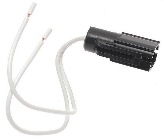

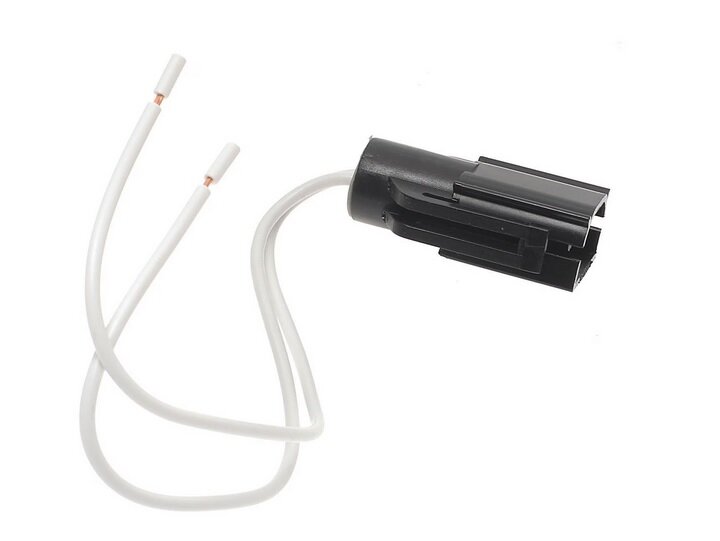

Also, i went ahead and bought the speed sensor connector myself from Oreilly auto. Maybe i can find someone that will put that on for me and it will fix the problem. I do not know if i should go back to this guys repair shop or not. He is a nice guy and all, but he is under staff big time. Anyway, that is the latest update.
