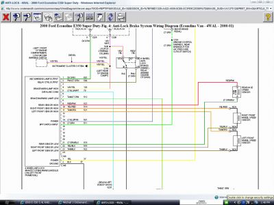

The ABS light is on I hooked up my OTC Genisys scanner and it tells me that it cannot get the code from the PCM. I have to locate a 2 wire connector one side of this is black W/ orange stripe. Which I would then ground the blk/orange wire for 1-2 seconds and read the blink code. The scanner say's the connector is behind the right side of the instrument panel. Can not locate it there. The dealer said it would be in 1 of 2 locations on the passenger side , by the kick panel or behind the glove box. I have checked both places and only found a 3 wire connector. Any ideas?

I don't really know what youre looking for, Ford say to hook up to the DLC and read the codes, Wiring Diagram does not show the colors you mention...
https://images.2carpros.com/forum/automotive_pictures/62217_AntilockE350_1.jpg

with the scanner hooked up it promps me through and say's to locate this connector. This van only has rear ABS. Thanks for trying

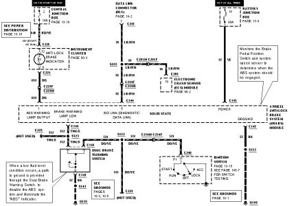

If you have a connector number I can look it up that way...heres another diagram...
https://images.2carpros.com/forum/automotive_pictures/62217_EYM04201_1.jpg

If you go to the abcm you can locate the color wire you need there anr ground it there...
