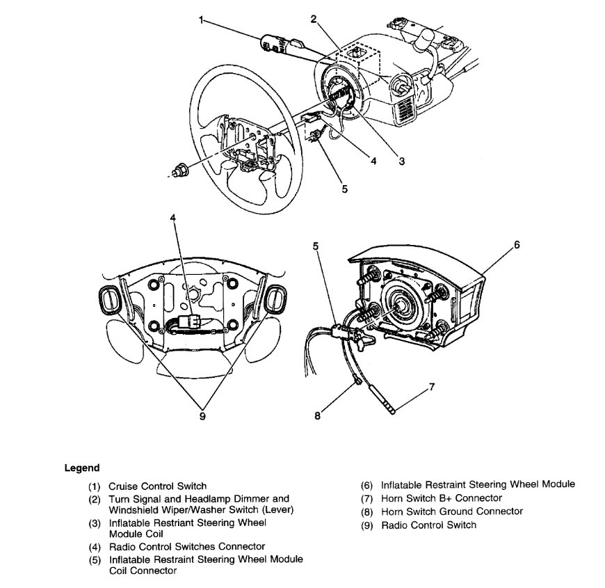

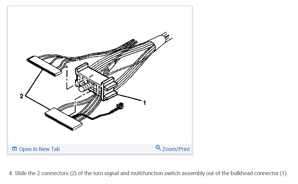

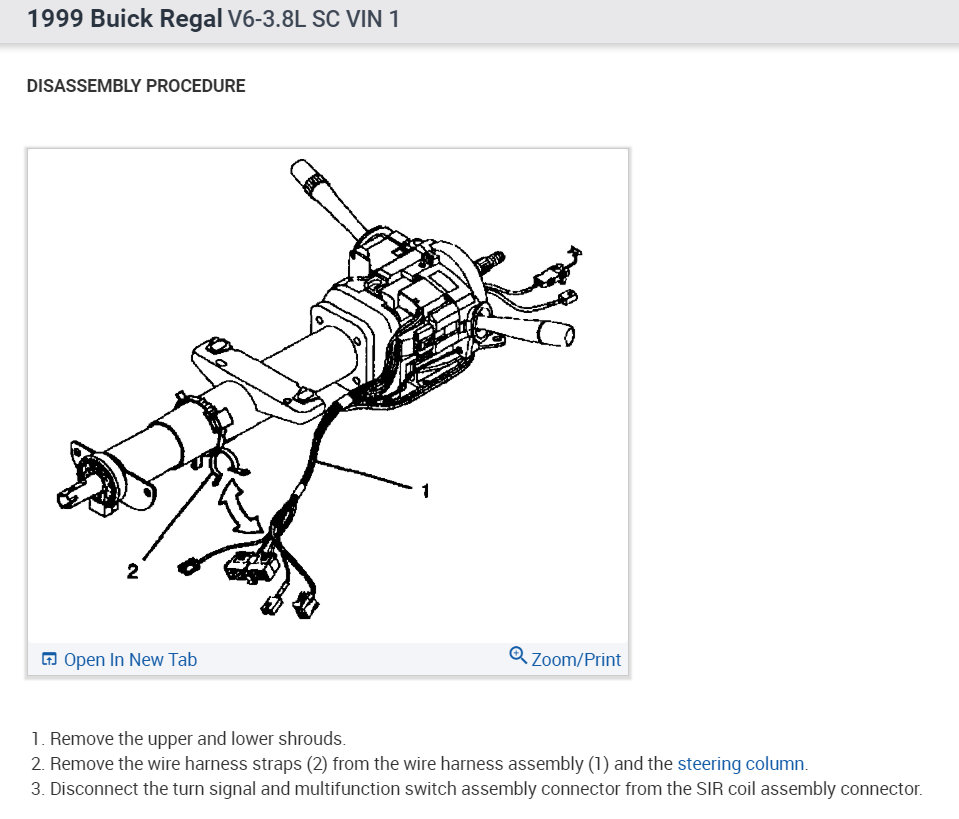

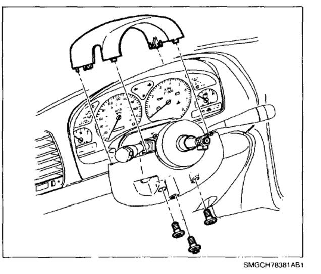

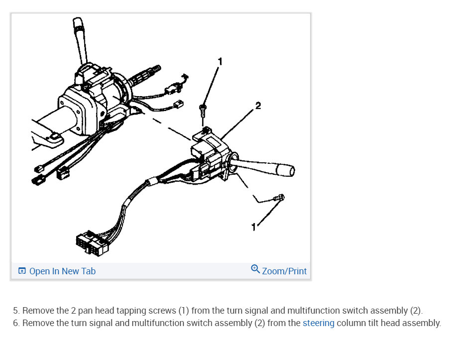

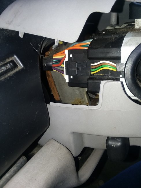

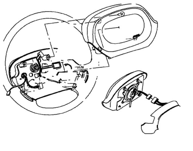

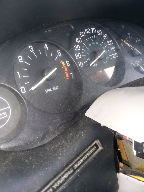

I believe I broke the multi-function switch, I know it will need to be replaced. I took the bulbs out of the headlights high beam. However, I was wondering how to get the light off the dash. It is draining the battery in the mean time. Does anyone know the wiring of the switch? Which cord is just for high beams?
Oct 24, 2018 at 12:28 AM
BOBBIE LYNN
The wires and the light on when the car is off.
Oct 25, 2018 at 1:47 PM
  • 54,840 POSTS
Its better to fix the switch so you have high beams when you need them. Here are diagrams to help you get the job done. Check out the diagrams (Below). Please let us know if you need anything else to get the problem fixed.
