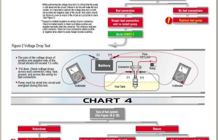

For the life of me i can not think of anything else that would stop the pump from reaching the required pressure. Lets try voltage drop test fuel pump might not be getting enough power
https://images.2carpros.com/forum/automotive_pictures/12900_voltage_drop_1.jpg

That was the first thing i checked befor i changed the fuel pump. It is getting full batt voltage at the pump. Also the pump is, according to the repair manal, pumping the correct amount of fuel. Half a pint in 15 seconds. The pump put out one pint of gas in 21 seconds. So thats why i do not think the fuel pump is the problem. Thanks for guess and PLEASE HELP ME IF YOU THINK OF ANYTHING ELSE. Jay
