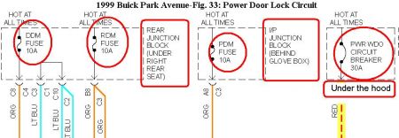

All my doors seem to be dead the power locks and windows dont work and the car dosent even know when the door is open have checked all fuse under back set and pass side door area and under the hood can you help ?

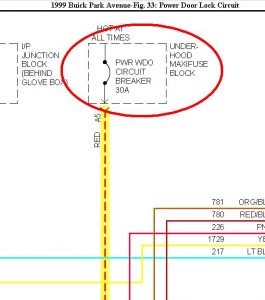

You did say you checked the fuses, but did you check the power window/door lock circuit breaker, under the hood?

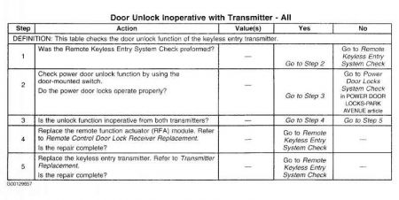

If you have replaced all the fuses and the circuit breaker as displayed,
https://images.2carpros.com/forum/automotive_pictures/55316_99parkavepdl_1.jpg

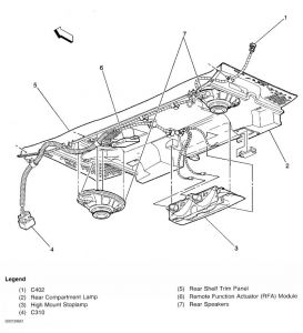

all subsequent tests show that you have to replace the Remote Function Actuator Module
https://images.2carpros.com/forum/automotive_pictures/55316_99parkaverfa_1.jpg
https://images.2carpros.com/forum/automotive_pictures/55316_99parkaverfa2_1.jpg

You might want to check that Remote Actuator Module and make sure the harness is plugged in tight. It can be just that. But based on the diagnostic, you may need to replace the module.
