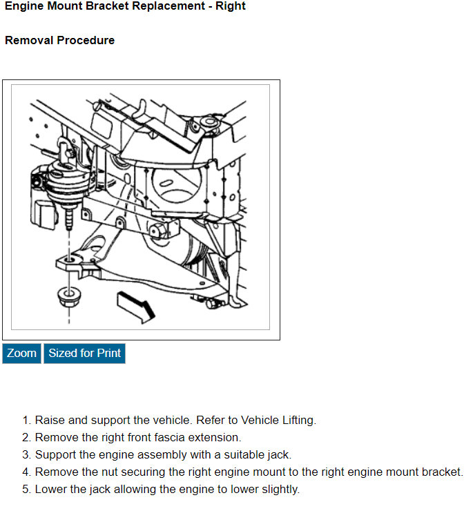

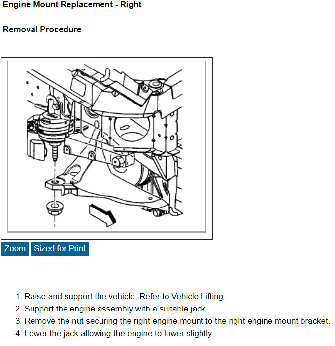

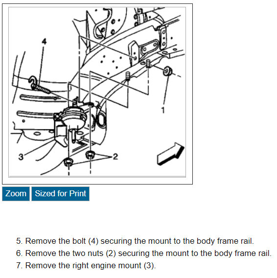

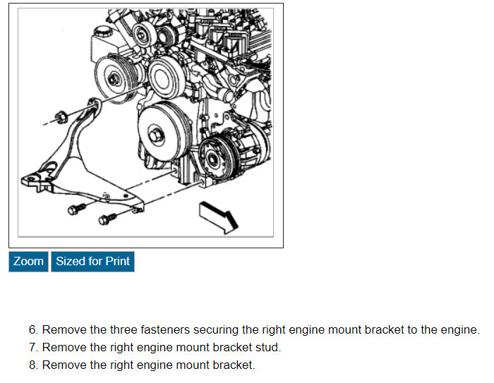

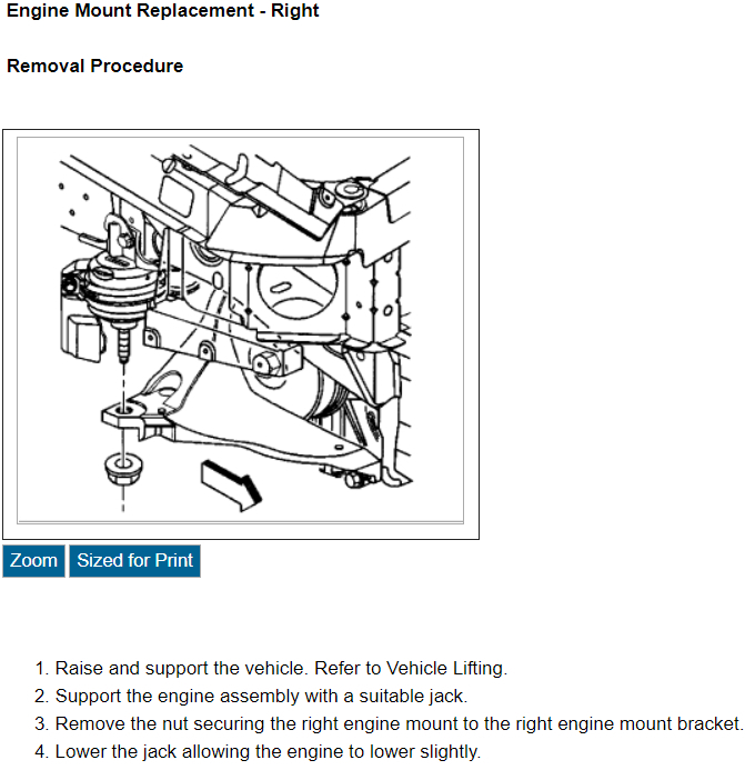

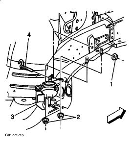

What is the procedure to replacing the front engine mount? Can the mount be purchased at an auto parts store?
Aug 21, 2009 at 4:23 PM
OBXAUTOMEDIC
  • 3,711 POSTS
Hello, When you say front engine mount are you talking front of engine or front of car. Either way they are pretty easy to do. You will need a set of Jack Stands, a Floor Jack and a piece of wood either plywood about 14" x 14" or a 2x6x14" or something to put on the head of the floor jack so you don't damage the oil pan. Once you have the car jacked up and stabilized with the jack stands you will need to use the jack and wood to jack up the engine itself a little so that you can remove the mount. Here is a pic of removing the engine mount at front of engine....
https://images.2carpros.com/forum/automotive_pictures/188069_02lasbrertenginemountremov_1.jpg
Check out the diagrams (Below). Please let us know if you need anything else to get the problem fixed. Cheers
