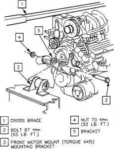

engine mount replacement instructions please?

Fig. 3 Engine Mount.
https://images.2carpros.com/forum/automotive_pictures/12900_e_5.jpg
Disable airbag system as described under MAINTENANCE PROCEDURES/AIRBAG SYSTEM DISARMING then disconnect battery ground cable. Attach suitable lifting equipment to engine, then raise engine slightly to remove weight from engine mounts. Remove accessory drive belt. Remove through bolt from front engine mount, Fig. 3. Lift engine until power steering reservoir touches strut tower cross brace, then loosen bottom two bolts on front engine mount. Remove A/C line clip, then the top two bolts from front engine mount and remove mount. Reverse procedure to install. Rearm airbag system as described under MAINTENANCE PROCEDURES/AIRBAG SYSTEM DISARMING. https://www.2carpros.com/kpages/auto_repair_manuals_alldata.htm

thank you it worked i have grate confidence with your site & will refear to all
