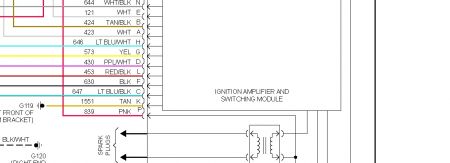

Car still has no spark after the ing module was changed
Wednesday, November 10th, 2010 AT 10:35 AM
JDL
MECHANIC
16,098 POSTS
Check for voltage at the ignition module, pink wire, goes hot when you turn on the key. Also check ground, tan wire.
