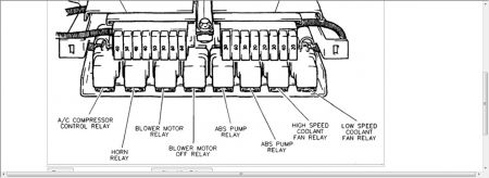

  • 75,992 POSTS
A/C compressor control relay.
https://images.2carpros.com/forum/automotive_pictures/12900_ac_relay_2.jpg

Thanks for the picture. Do you think that the problem lies with that relay?
Aug 24, 2010 at 12:44 PM
RSUKOVICH
  • 84 POSTS
As I told you previously, there are two relays on the left bank below a row of fuses which includes the 30 amp for the A/C. The diagram that you sent me shows a row of eight relays in the center and the compressor control relay is identified as the first one on the left and because there are actually only two relays on the left side, I checked them both and they both checked out okay too, the 30 amp fuse is also good. Where do we go from here?

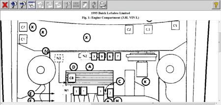

Not exactly. As I mentioned previously, there are two banks of fuses which are left and right. Under the left bank, there are two relays and under the right bank, there are four relays. Since the fuse (30 amp) for the A/C is on the left bank, I am assuming that the relays under those fuses are for the A/C.
Aug 31, 2010 at 3:16 PM
  • 75,992 POSTS
I am using all my references Mit1 and Alldata on this AC relay if this do es not help I am sorry. A/C compressor relay on engine compartment relay center, on right side of firewall. See figure one number three.
