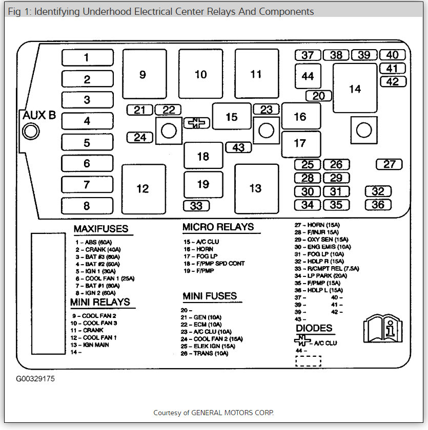

I am still trying to find the problem with my car. I replaced the crankshaft sensor and the car is still cutting off. It is like the key is being turned off after about an hour of driving, and it starts right back up, but will stall again. I also noticed that sometimes it will cut off and lose power for a second and regain power on its own without even starting the car. I think it may be the ignition switch. However, I have another question. I feel as if it has been a chain reaction type of situation, could the ignition switch be the root to all the issues or is it another issue and the ignition switch is now just the next part to get "burnt up"? Fist it was ignition control module, also replace coil packs at the same time, then we replace MAF, purge solenoid, throttle body, throttle position sensor, air filter, fuel filter, now crankshaft sensor after testing it with a voltmeter and a new battery. My husband did install an aftermarket radio, however I am not sure that is connected. What could cause part after part from going bad? The car runs and drive so smooth and lovely and then will just cut off, it could be the ignition switch, but what are the chances of us fixing that and it still cutting off? Our next route of action is going to be replace plugs and wires, ignition switch and the positive battery cable as well as the ground cable from the battery that branches to the trans-axle stud do the the end having a slight greenish blue look to it. I am about to loose my cool. Please help.

KEN L
  • MASTER CERTIFIED MECHANIC
  • 48,363 POSTS
To me it sounds like the engine main relay is overheating and shutting off. Here is a guide and the location of the relay so you can run a test and replace the relay:
