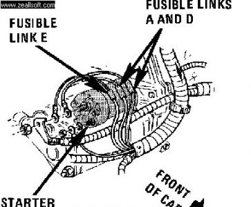

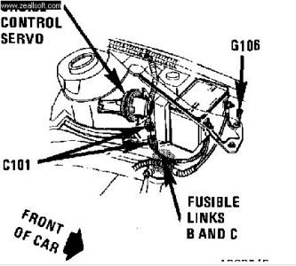

AMYDONTKNOW
  • 1993 BUICK CENTURY
Electrical problem
1993 Buick Century V6 Front Wheel Drive Automatic 62000 miles
We've got a 93 Buick Century and it won't start. At first it would start but wouldn't stay running and now it has no power-no lights, nothing--anyway I was wondering if anyone had any ideas about this? Thanks
+1
Friday, February 15th, 2019 AT 7:07 PM (Merged)
NDDUNC
  • 47 POSTS
First, check the alternator & battery. If you have power, check the battery cables at the starter [pos]&at the engine[neg] how did it sound when running before?
-1
AMYDONTKNOW
I think all that has been checked, I think it's something to do with the electrical at this point. But when we were trying to jump it, it just quit and now it has nothing.
BMRFIXIT
  • 19,053 POSTS
Make sure battery fully charged .
check two locations for fusible links
1.:-- at the starter
2.:-- around the battery positive side cable
https://www.2carpros.com/forum/automotive_pictures/99387_Image_2.jpg
https://www.2carpros.com/forum/automotive_pictures/99387_Image1_3.jpg
good luck
let me know
