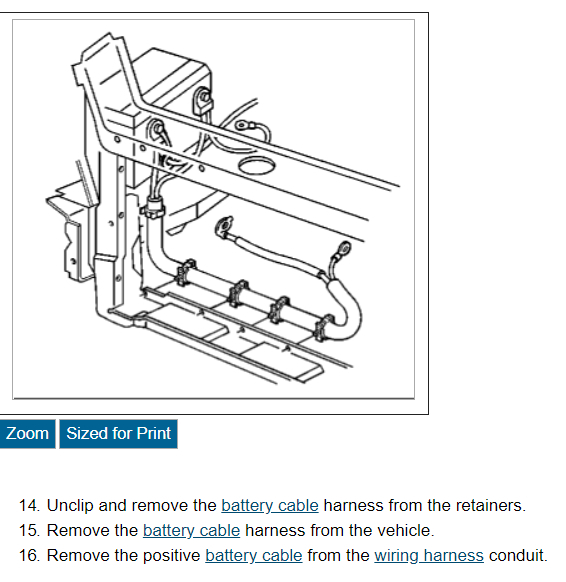

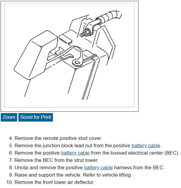

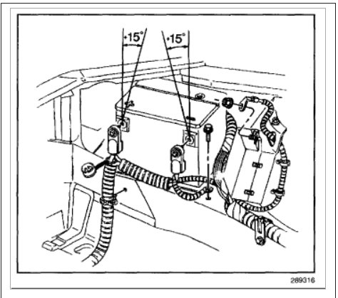

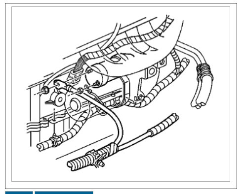

CarPros suggested:
G111 ground being loose(found with exposed wire, not sure if repair correctly).
Replace positive battery cable(have not done yet).

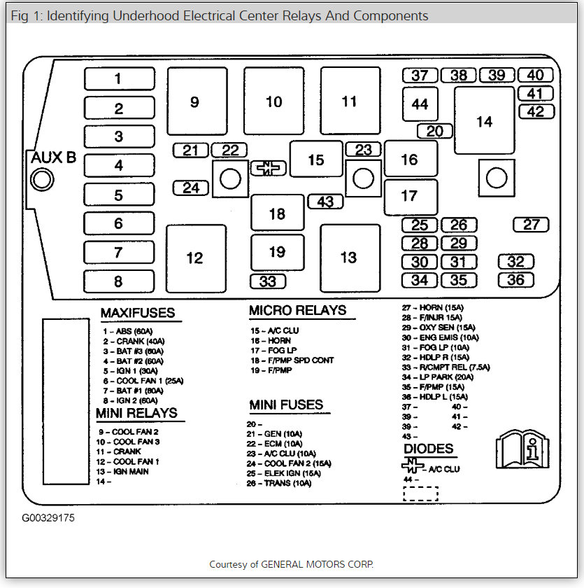

To me it sounds like the engine main relay is overheating and shutting off. Here is a guide and the location of the relay so you can run a test and replace the relay:
Aug 9, 2018 at 2:48 AM
