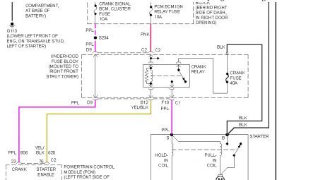

i changed the starter which i dont think was the problem i changed the battery which doesnt seem to help the problem but for some reason when i turn the key over the starter just clicks.it wont crank the car. i changed the starter motor twice still get the same results. can someone please help me its the only car i got...i also checked the wires for corrosion and it came out fine. why wont the starter spin over.

JDL
  • 16,098 POSTS
Maybe a security system issue? I can't be sure what is clicking, check the crank fuse for voltage. Use a voltage tester, should be hot/voltage all the time.
https://images.2carpros.com/forum/automotive_pictures/170934_century_crank_fuse_1.jpg
