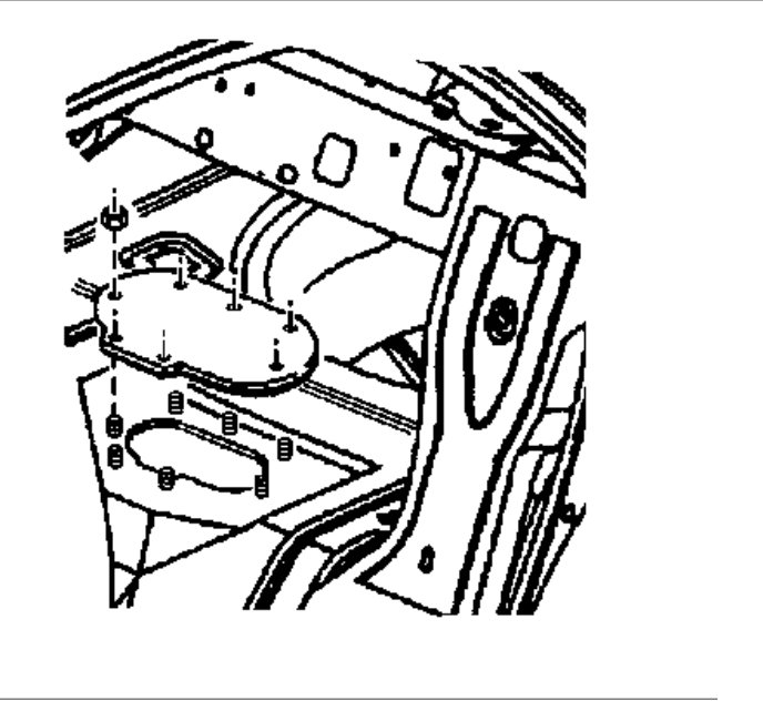

Okay people, there is a trap door in the trunk area, you can pop the back of the backseat off and lift the carpet in the trunk. Take out the 10mm bolts holding the cover on.unplug the fuel pump power and sensor plugs. Use fuel disconnect tool or small flat blade screwdriver carefully to disconnect fuel lines. Use snap ring pliers and pop the snap ring off the top of the sending unit. Pull the unit out. There will be a thin metal arm with a plastic float on the end, that is the fuel level sensor. Press the tabs on the level sensor and unmount it from the pump unit. Follow the two wires and unplug the connector. You can purchase the level sensor with arm separately from the entire sending unit and save a lot of money. Installation is in reverse order..Warning] make sure you get the new big o ring for the unit when you put it back into the tank. Its not required but recommended. Also for those having issues with the odometer and gear selector not working, you can take the cluster out and disassemble down to the circuit board, there will be 4 resistors in the upper right corner of the gauge face side, they fall off or lose connection due to poor solder joints. If they are still there, you can reflow the solder and the odometer will work. If they are missing or fell off, clean the contact pads, and resolder four 150ohm 1/2 watt resistors there and it is fixed.

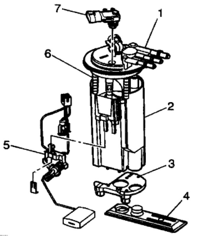

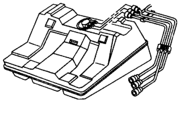

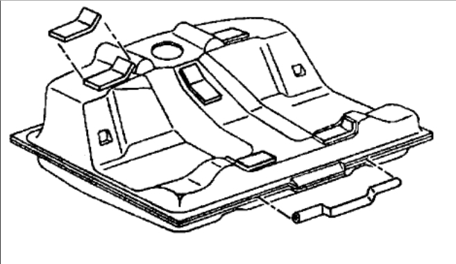

It sounds like you have a fuel level sender that is out which will cause the fuel gauge to have problems. You have a tap door so you can replace the pump easily.
Check out this guide that will let you see what you are in for doing the job.
https://www.2carpros.com/articles/how-to-replace-an-electric-fuel-pump
Here is what it will be for your car (below)
Mar 22, 2021 at 6:13 PM (Merged)

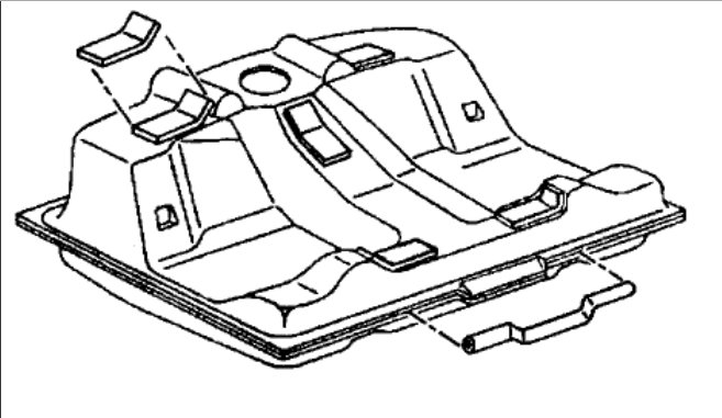

There is a tap door for the fuel pump and fuel sender. Here is a guide that will show you what you are in for when doing the job. Yours will be easier because of the access hole.

The fuel level sensor is located in the gas tank. It could be the sensor going bad. You have to drop the gas tank down and remove the fuel pump and sensor from the gas tank. Make sure the gas tank is empty before you do this. Make sure no one is smoking or open flame near you when you do this.

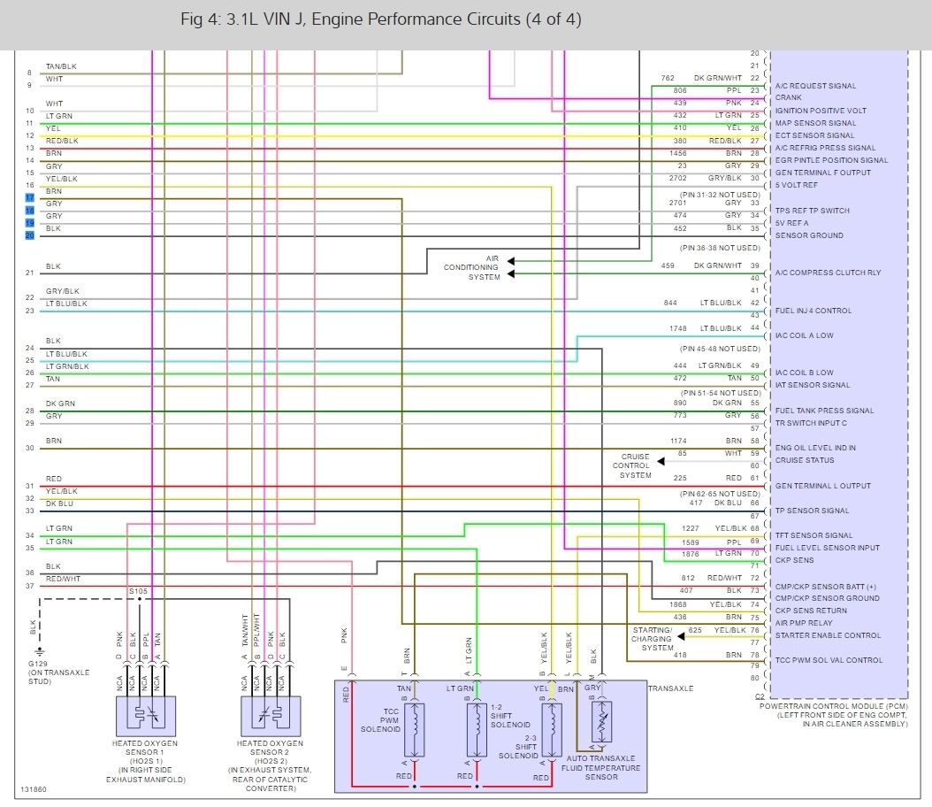

Hey ZAKARIYA,

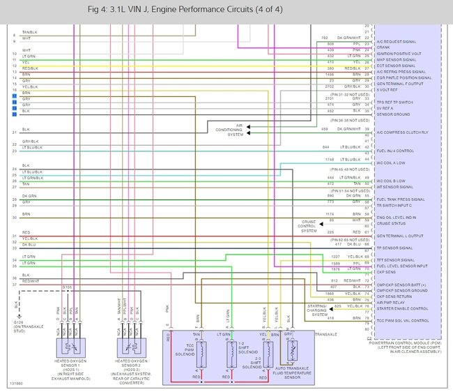

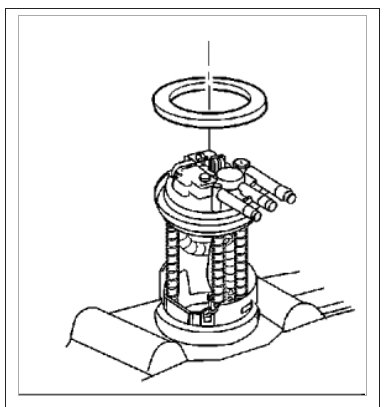

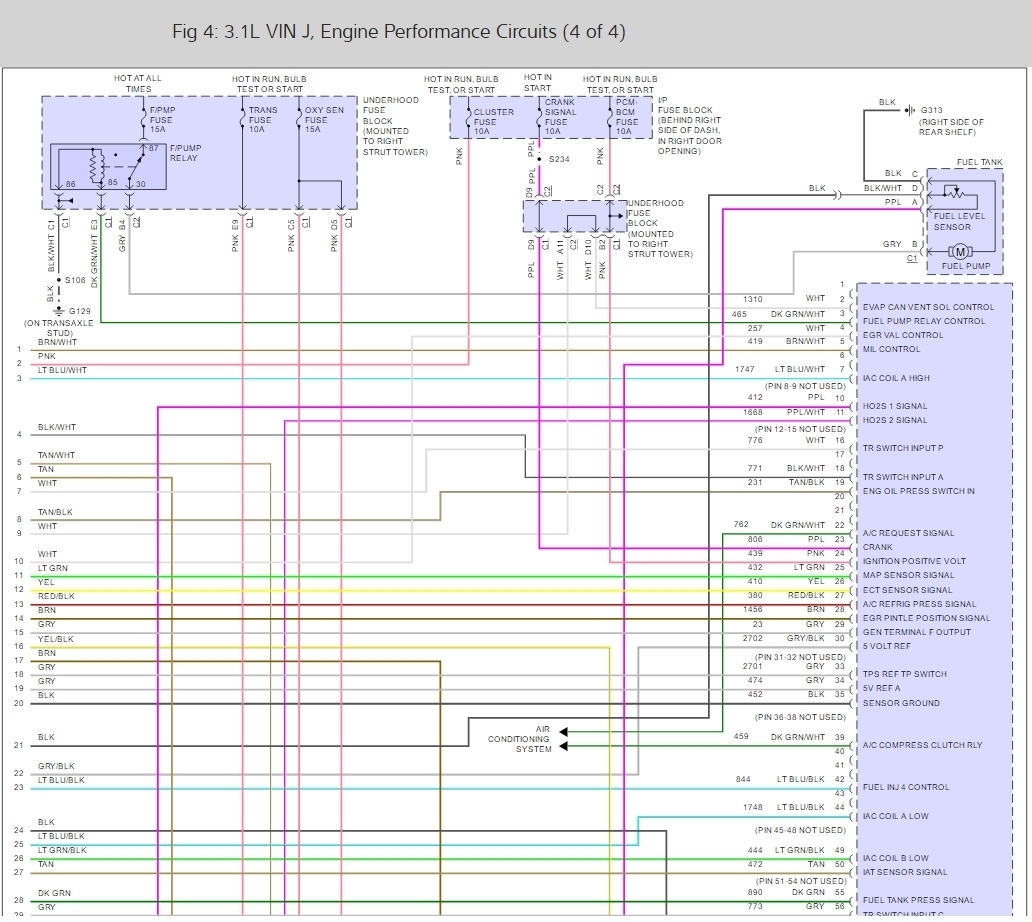

There is a fuel level module which is the BCM that could be bad, let's try to unplug the harness to the tank and see if it drops down to zero. That would indicate a bad sender which is the most common cause.
Here is what you are in for when changing the fuel pump module out.
Here is a wiring diagram that will show how the system works. Please check the sender ground circuit I have seen these go bad he is guide to help.
Please run some tests and get back to us so we can continue helping you.
Best, Ken

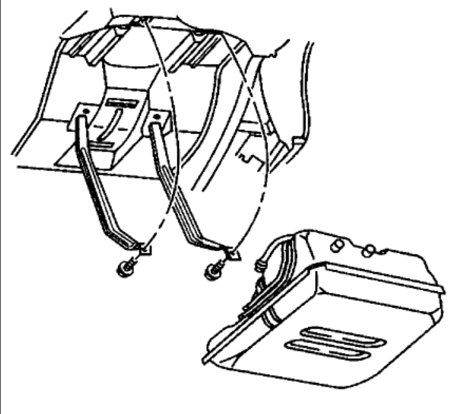

  • 54,840 POSTS

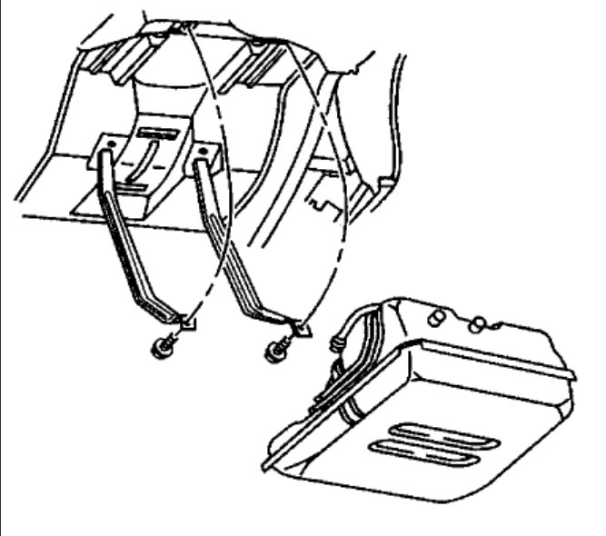

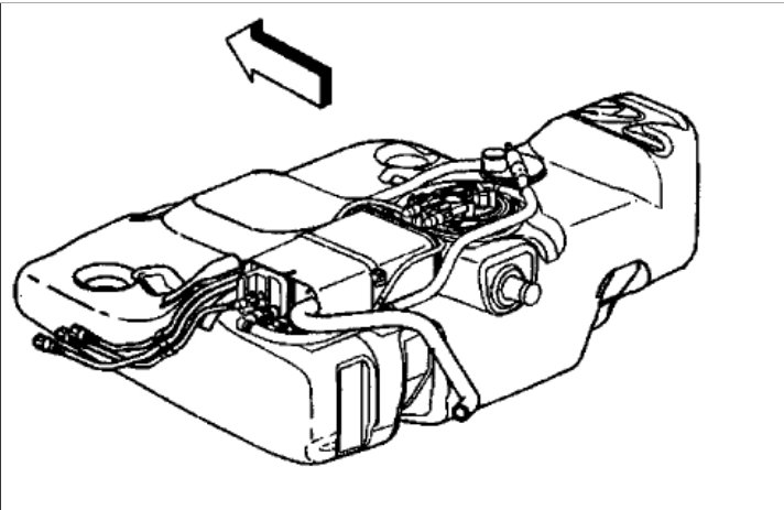

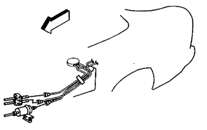

Nine times out of ten it is the sender going bad which is in the tank. Here is a guide to help you see what you are in for when doing the job. You might need to but the fuel pump module to get the sender.
Here are some diagrams of how to do the job on your car (below).
Mar 22, 2021 at 6:15 PM (Merged)

  • 54,840 POSTS
This car does not have an access hole sorry.
