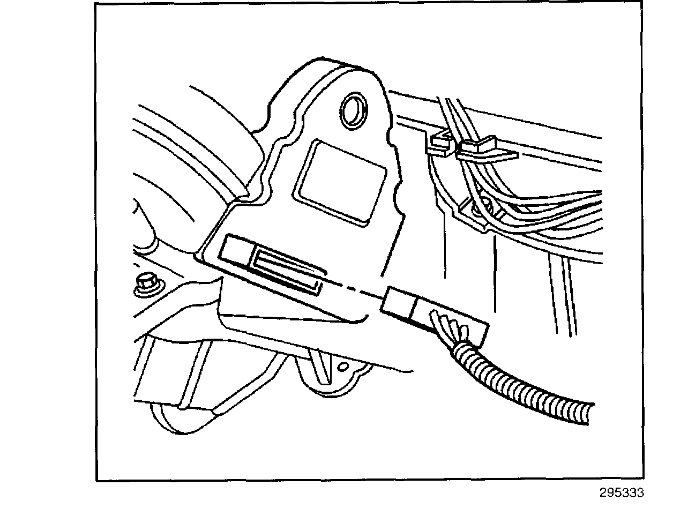

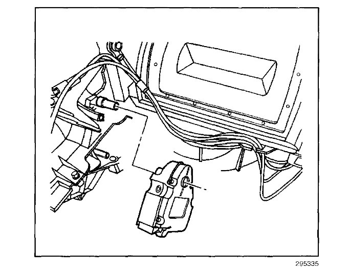

There is a blend door motor on the passenger side that controls the heat and cold command. common issue for this issue.
REMOVAL PROCEDURE
imageZoom/Print
1. Remove the right side instrument panel insulator.
2. Remove the instrument panel compartment.
3. Disconnect the electrical connector from the right air temperature actuator.
imageZoom/Print
4. Remove the screws which secure the right air temperature actuator.
5. Remove the electric actuator.

Correct. It is behind the glove box door when you remove it. It will be a clear shot to get to the actuator.

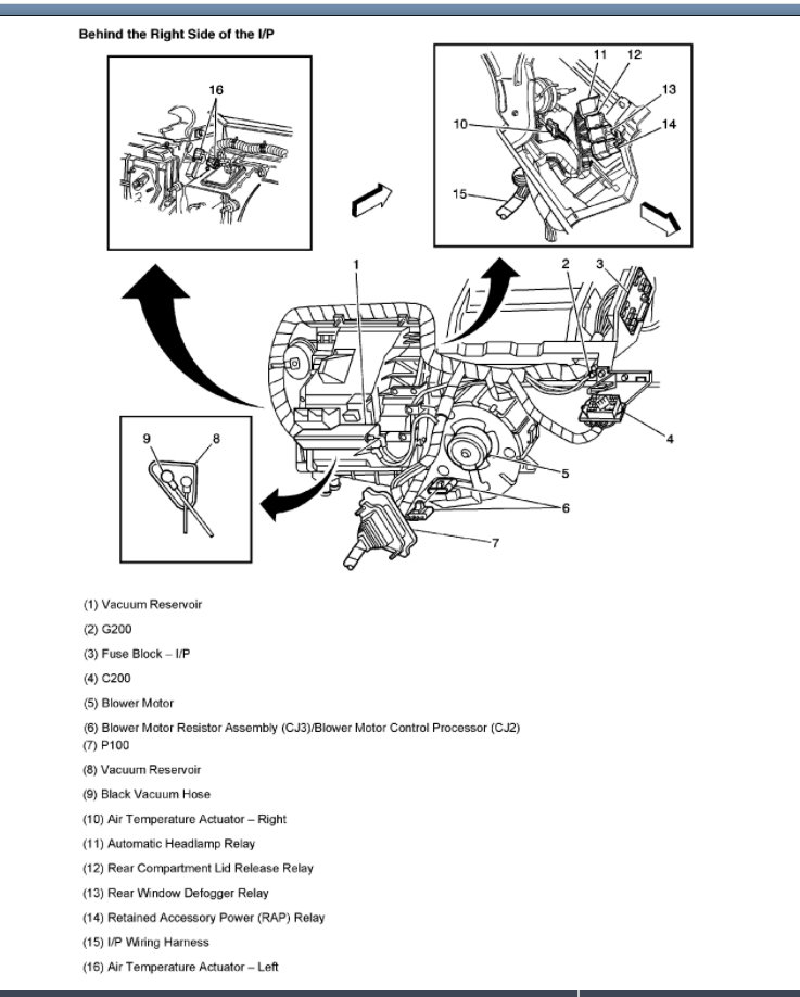

once the failure is determined. there is a blend door motor that needs to be tested to verify that it is bad and not the control.
it is under the dash right side.

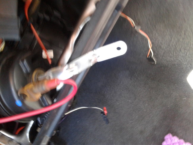

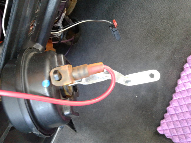

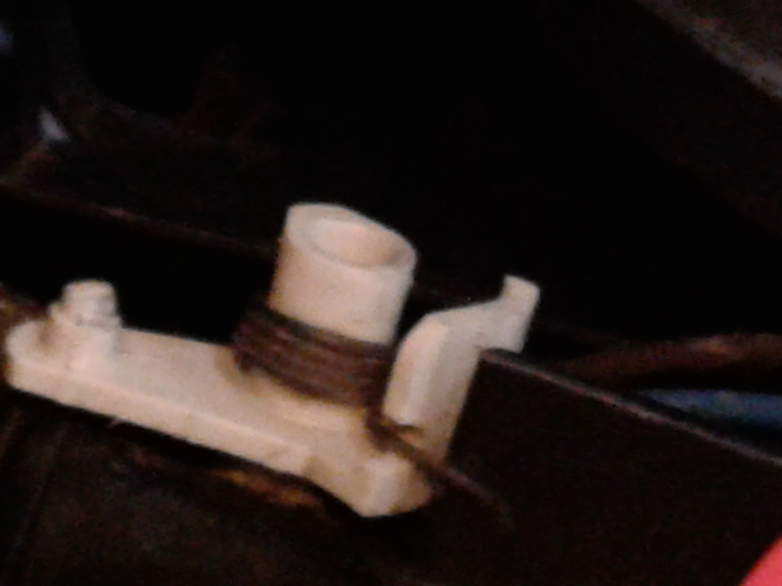

So here is where I am at right now. I went to buy a new replacement actuator for my car and AutoZone sold me the wrong one, return home to put the old one back on and it is taking me forever. I cannot align actuator correctly, but noticed this piece keeps coming off when I turn on AC.
Aug 25, 2020 at 10:16 AM (Merged)
you need to verify the part numbers are exact or it wont work..
It looks like the piece that attaches to the white part has the end broken off.

I was not sure you received this message earlier.
Okay great, that is what we thought. So I was going to head over to Pick-N-Pull and see if I can find that white plastic piece, but I am so having a problem putting the actuator back on to the car I am not sure how it actually went. Also, I read that I can connect the actuator back up to the plug and then adjust the dials on my air conditioner to see if it actually turns is that correct?

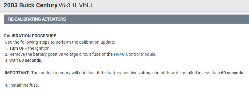

Good evening, do I need to re-calibrate my HVAC if I only removed the blend door actuator and then reinstalled it?
No, not on vacuum actuators. The electric actuators require calibration but not the vacuum control units.

We may be making an assumption on how the actuators are working because I show that these are electric temperature control actuators but the others like mode door are vacuum controlled.
Did you monitor them actually moving the door on the driver side? The fact that you get more heat when driving is another indicator that it is a blend door issue when they are weak.
What I would do is access the driver side and then operate the system in max heat, then see if the door moves. Then remove the actuator and manually move the door to max hot and max cold and see if the temp gets hotter.
This will confirm the actuator is not moving the door to its full travel:
Please let me know if you have questions on this and see the info below on this.

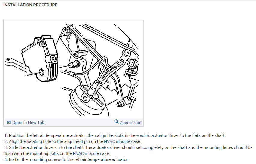

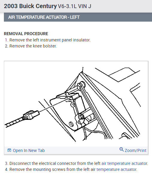

DANNY L
  • 5,648 POSTS
Hello, I'm Danny.

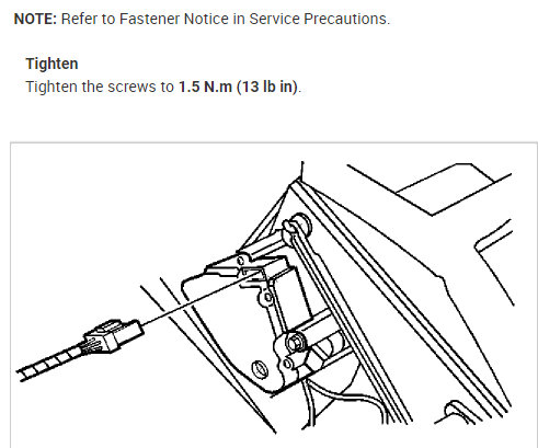

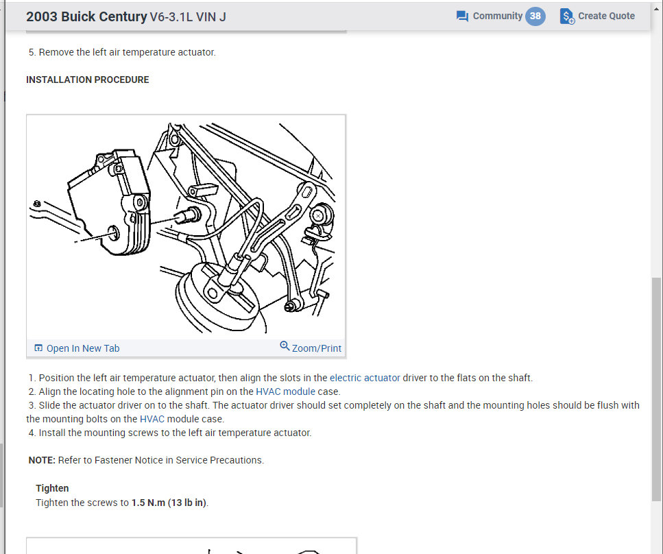

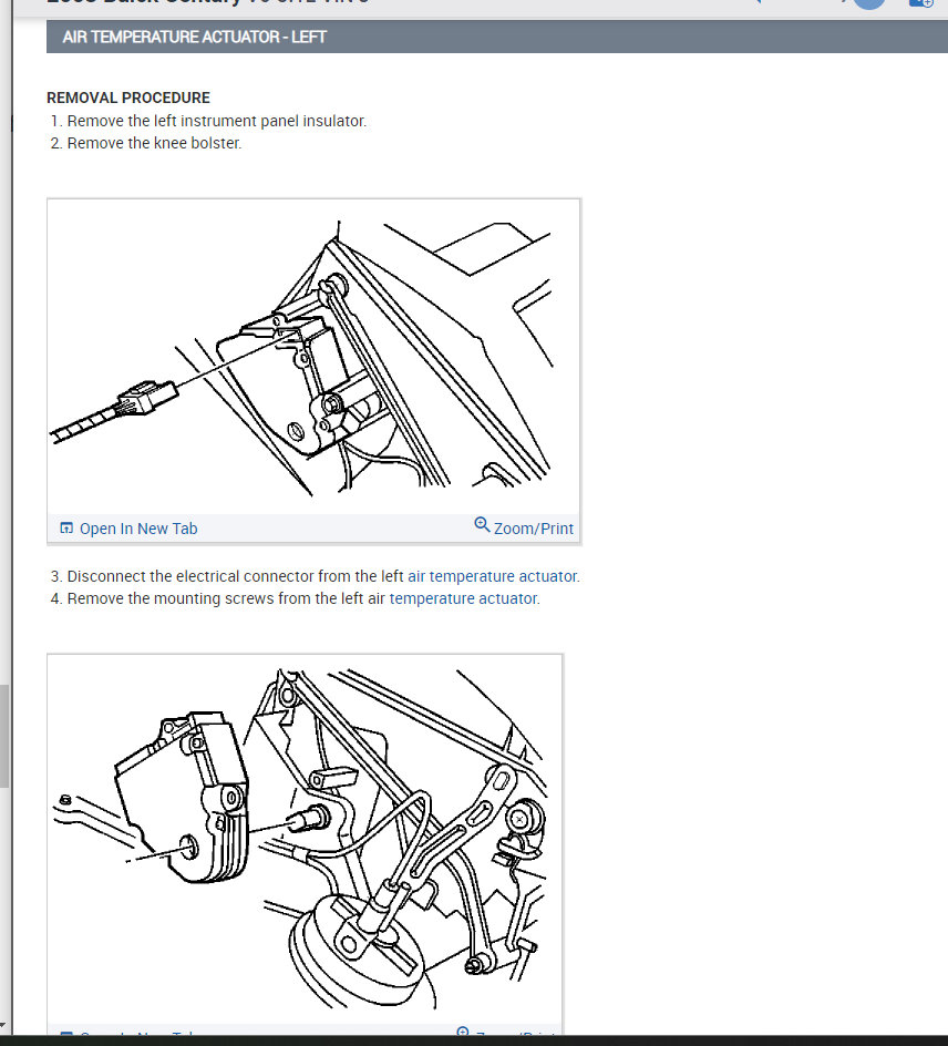

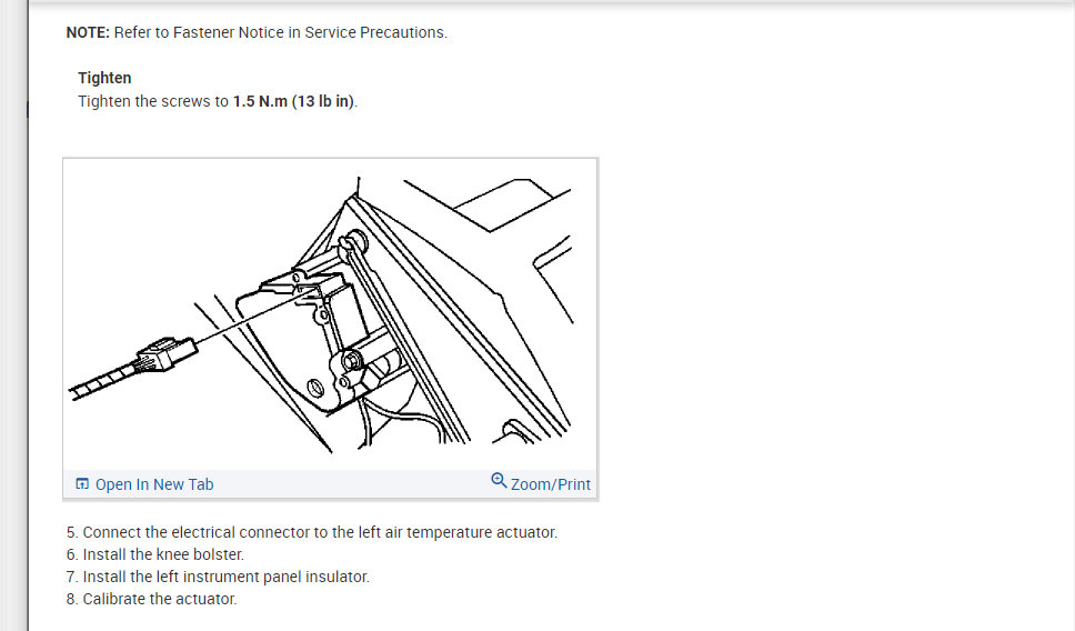

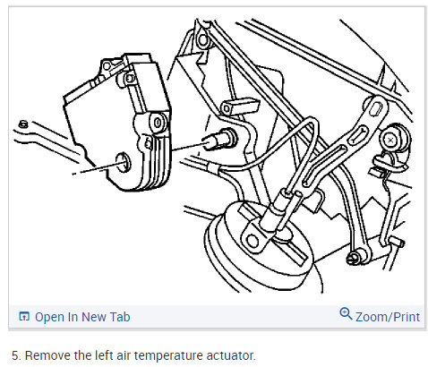

Yes, there are a left and right side air temperature actuator on your car. Here is a basic tutorial showing how to replace a blend door actuator which is similar:
I've attached picture steps below on how to replace the left-driver side air temperature actuator on your vehicle. This is for an automatic HVAC system. I also included the last picture step on how to recalibrate the new actuator after the repair is made. Hope this helps and thanks for using 2CarPros.
Jul 15, 2021 at 11:45 AM
PETER PISACRITA
i removed the actuator and moved the door by hand and did not make a defiance. i can see and feel the actuator move the door. when its on just vent, the air is warmer than what it is outside. on defrost i get cold on passenger side and warm on driver as i do with all the other settings. there must be a door that separates the system. tomorrow i will remove the control panel and check connections and hopefully i will be able to see what's in front of the heater core.
