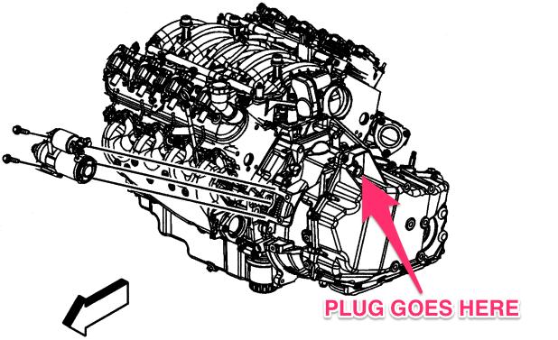

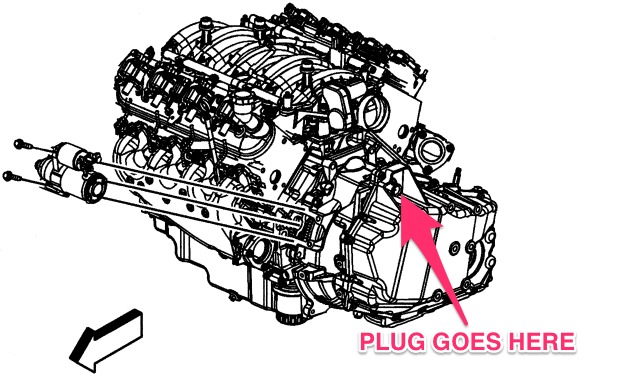

I am looking into the issue of why my Grandfather's Buick won't start. Upon hooking the jumper cables to the battery, we get the everything to turn on. When I go to start the vehicle, it does nothing. No click or anything. After I inspected the engine compartment, I found that an animal had chewed through a wiring harness on the driver side. I am trying to figure out what all is ran through that harness but cannot find a breakdown for it. I have attached an image of where one end of the harness plugs into. Any help would be appreciated.

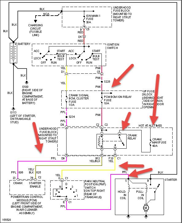

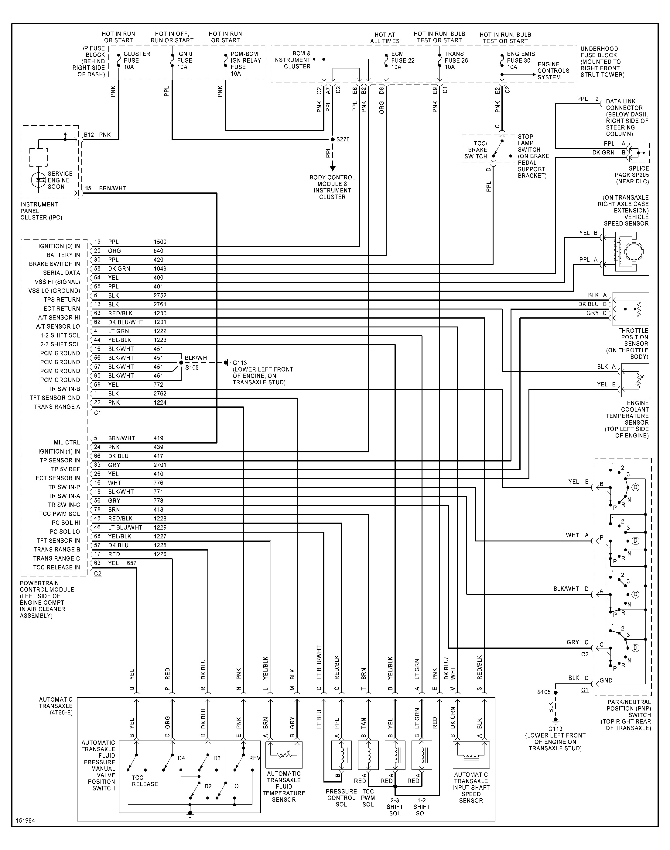

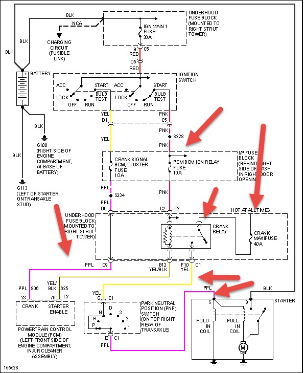

CJ MEDEVAC
  • 11,005 POSTS
I'm not familiar with your vehicle---i mainly mess with old jeeps and fords
I am able to look up stuff for most any newer car in "mitchell i"
I could not identify the connector in "mitchell i"
It looks as though it is on the transmission in your pic
I grabbed this transmission wire diagram for a "century unlimited" for your year, before I gave up
A "custom" may be the same. If my guess was wrong, I will go back and get the custom for you
Lemme know progress
The medic
Thursday, August 29th, 2019 AT 11:26 AM (Merged)
CJ MEDEVAC
  • 11,005 POSTS
Ok. Where'd my diagram go?
I try again
The medic

HMAC300
  • 48,601 POSTS
That goes to the transmission harness and maybe the starter. Check the wires leading to the fuse box and see if any are there. Check the wires and fuse/relay in undrhood box and the wires near where they have been chewed up. When fixing these make sure to use good connectors and solder them as well as use shrink tube to cover the repair where they have been damaged.
