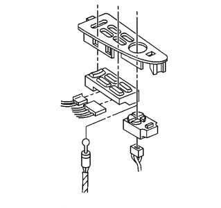

I just bought this car and love it so far, however, on the driver's side power window controls, where the "lock-out" button is, it seems to be broken. It used to "click" when you adjust it and now it just flops around loosely. So now no windows can be put out down unless the driver does it, which is not a HUGE deal but is a bit inconvenient. I'm not a big car buff or anything but I am assuming its a lot of work it get at it or is there an easier way? or am I better off just leaving it alone?

You will need to replace the master switch. It is easy enough to do. Take a small tech driver and get under the front of the switch plate and pry upword to release the clip on the front of the trim plate.once the trim plate is out you will see the clips that hold the switch assembly to it.
https://images.2carpros.com/forum/automotive_pictures/86485_325902_1.jpg
Hope this helps.... Cly
