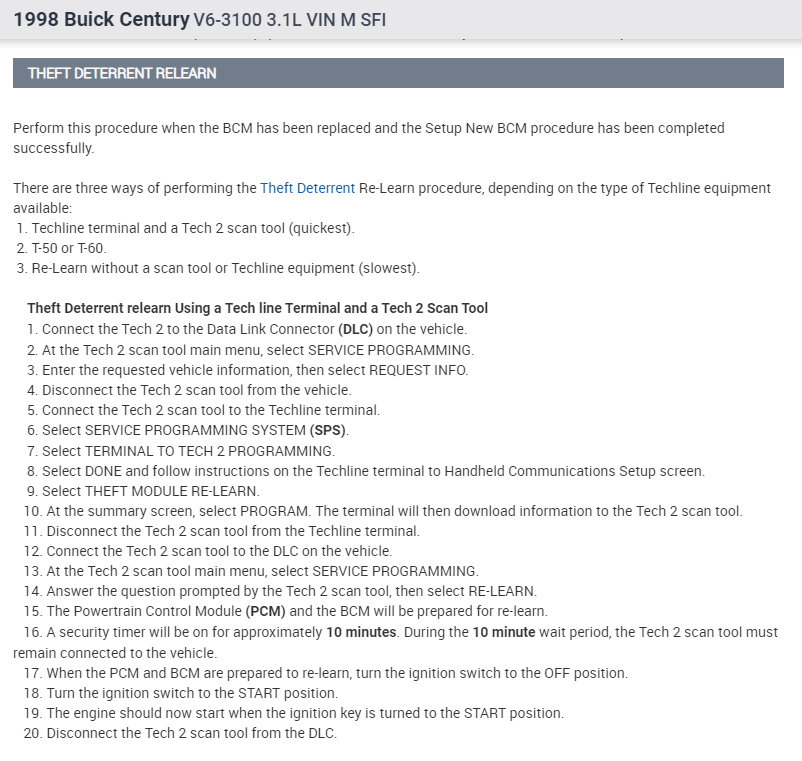

I have a 1998 buick century, 3.1l v6 with 160000 miles. Recently, the car has developed some problems, which all started at the same time.
*car starts when key is turned to the "on" position
*gauge cluster, radio and power windows will not work, but will suddenly come on after driving for various amounts of time.
i believe it is probably the ignition switch, but i'm not sure, so any help is greatly appreciated.

Buickowner39, I have a 1998 Century and it seems I am having the same problem. The car won’t start because the anti-theft is malfunctioning. How did you remove it? Because I am on the verge of junking it!!

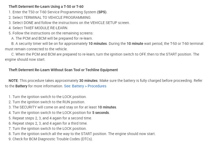

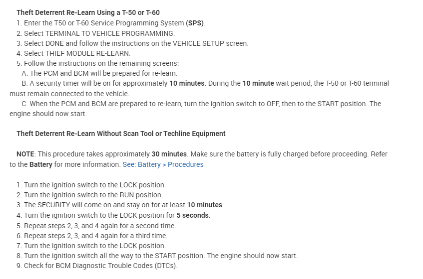

Hey Kevinh235,
Do appreciate you sharing that helpful information.
I have attached the anti-theft relearn process below, just in case someone wants to first try to reset the system rather than just removal.
Please let us know of any questions.
https://www.2carpros.com/articles/how-to-reset-a-security-system
