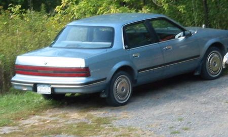

Thanks for the reply jalopypapa I will order one.I can pull the cable from inside the car for now to open the hood.The hose problem I had before is fixed and no more leaks, also had a serpintine belt installed yesterday along with new drums and rear shoes and rear cylinders.Cost $513 is that about right?
https://www.2carpros.com/forum/automotive_pictures/120627_my_car_1.jpg
