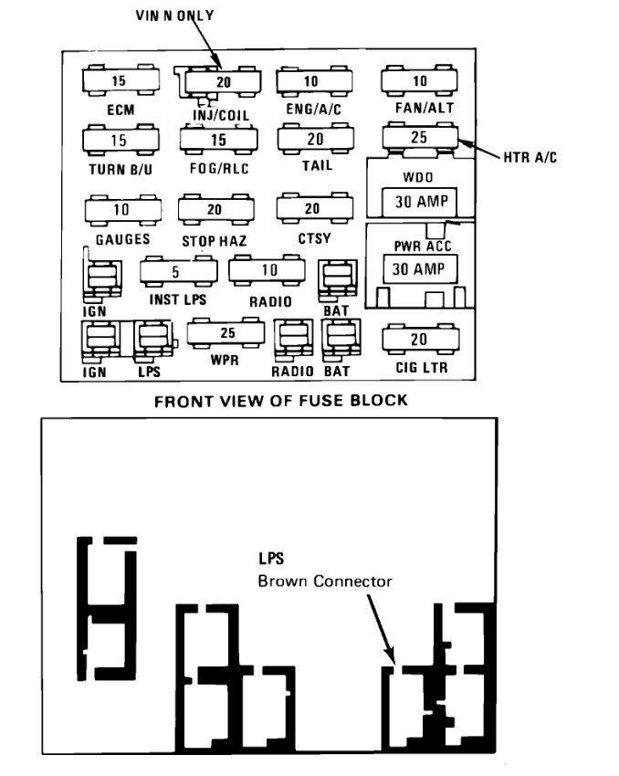

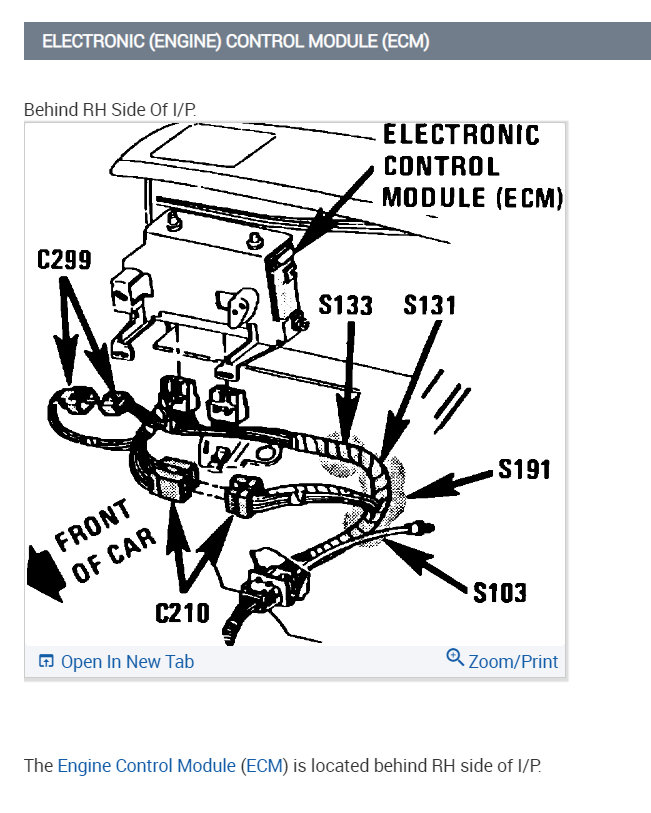

1990 buick 3.3 no start. No injector pulse. I have 12v at injectors. I have replaced crank sensor, ICM and ECM. Ohmed all wiring from crank sensor to ICM and all wiring from ICM to ECM all good. Checked all power and grounds at ECM all good. Yesterday I lost spark during testing. Im stumped.
Saturday, March 6th, 2010 AT 7:00 AM
BLACKOP555
  • 10,371 POSTS
I would check all fuses to see if they are good this guide will help with the fuse location in the diagrams below. If they check out I have senet he PCM go out and cause this problem as well. Lets run the codes also to see what comes up.
and
Check out the diagrams (Below). Please let us know what you find. We are interested to see what it is.
