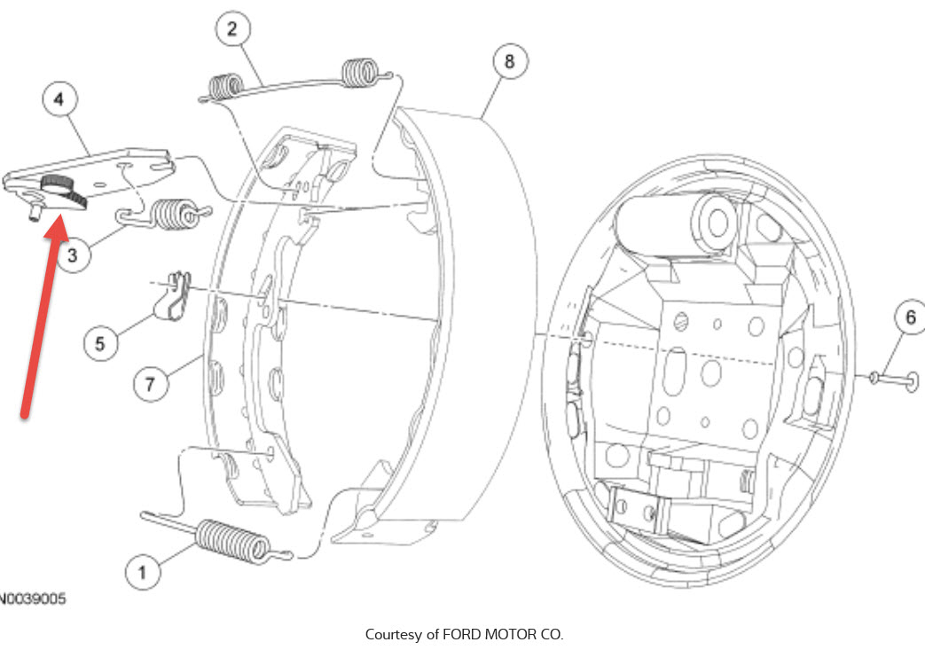

In order to save myself some money, which is now debateable, I changed the rear brake drums on my car. The reason for the change was that while driving one day recently, the rear of the car started to sway as if fishtailing. When taking of the left rear wheel and drum, it was clear that the bearings were shot. In addition, the race and other components of the bearings had melted to the spindle. In an effort to fix my car, I decided to replace both rear drums as well as spindles. This included replacing the brake shoes as well.
Removing all of the items in questions was fairly straight forward. Putting them back together was a different story. The spindles both went on with ease. I also replaced the ABS line going into each spindle on the back as well. This was easy as well.
The brake shoes were not bad in getting them on but took a little longer. I looked at several diagrams and pictures I took from before I removed them for guidance.
The issue arises when I tried to put the new drum over the new spindle. Most resources stated that these should slide right on. This was not the case. I triple checked that the parts I bought were the correct ones, and it appears they are. That being said, it took a rubber mallet, and basically the same amount of energy it took to get the old ones off, to get the new ones on.
The new brake shoes were always in the way. On both sides it took several attempts, of putting on and pulling off the new drums until I got what I thought was right. In the first attempts, the wheel would not even move when I got the drum all the way on. I had to use a hammer to get them off again, and actually had to purchase a new drum again because I do not have a press and purchased drums with wheel bearings included. These were damaged when pulling off the new drum, probably pulling it off crooked.
At any rate, none of the articles I used mentioned an adjuster, which I did nothing with.

more than likely you probably forgot or did not know to back off the adjusters on both sides and brake shoes were to large for the drums you also when disconnecting brake lines you need to rebleed the system. the best thing for you to do now is to take to a mechanic so he can open all the valves on the ABS unit and bleed and adjust the brakes that you have installed that should take care of it. see picture.

You replaced a brake line ,there is air in system,needs to be bleed The adjusters are normally accessed through the inside of backing plate, a small slot that the brake spoon fits into, They are usually adjusted so drum slightly drags with wheel installed, Where new bearings repacked and installed properly with castellated nut and cotter pin, wrench torqued,then backed off to hand tight,cotter pin installed.

Hey JEFFCLANDERS,
Yep it sounds like you got the rear brake show adjustment off, here is a guide to show you how to do the job.
https://www.2carpros.com/articles/how-to-replace-rear-brake-shoes-and-drums
Please let us know happens so it will help others.

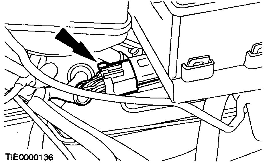

Most often when the brake pedal goes to the floor, it is one of two problems. First, check the brake fluid level. If it is empty, refill it and apply the brakes. Check for leaks due to a bad brake component, rusted steel brake hose, or a blown rubber brake hose at the caliper.
If the master cylinder has fluid and isn't low, suspect a bad master cylinder. What happens is the plungers in the MC allow fluid to bypass them. The result is the pedal goes to the floor. Take a look through this link:
https://www.2carpros.com/articles/brake-pedal-goes-to-the-floor
Now, if there are no leaks and you need to replace the brake master cylinder, here is a link that shows in general how it is done:
https://www.2carpros.com/articles/how-to-replace-a-brake-master-cylinder

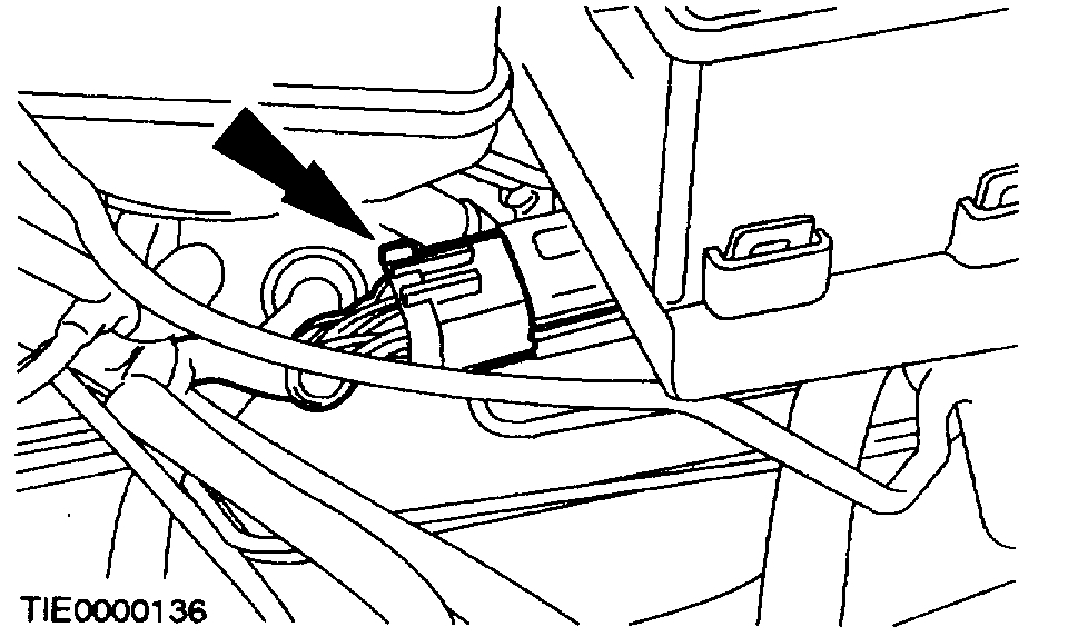

Here are the directions specific to your vehicle for replacement. The attached pictures correlate with these directions.
Brake Master Cylinder
Removal
All Vehicles
1. CAUTION: If brake fluid is spilt on the paintwork, the affected area must be immediately washed down with cold water.
Disconnect the battery ground cable.
Picture 1

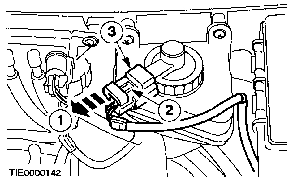

2. Disconnect the electrical connector from the filler cap.
1 Pull back the tab.
2 Depress the clips.
3 Disconnect the electrical connector.

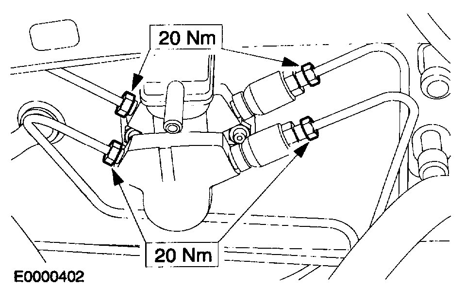

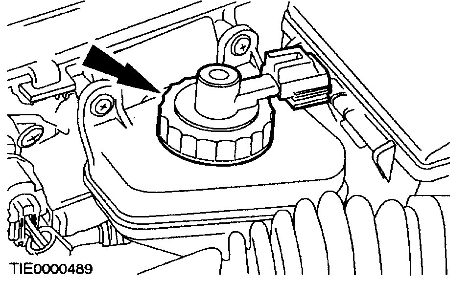

Picture 2
3. CAUTION: Make sure the filler cap does not become contaminated.
Remove the brake fluid reservoir filler cap.

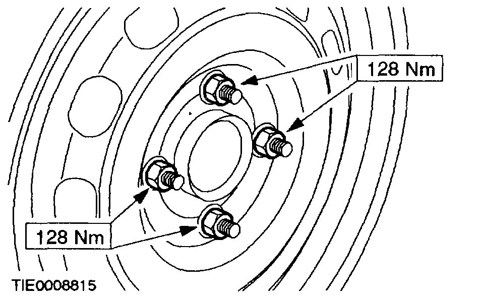

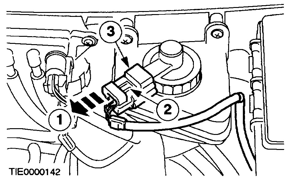

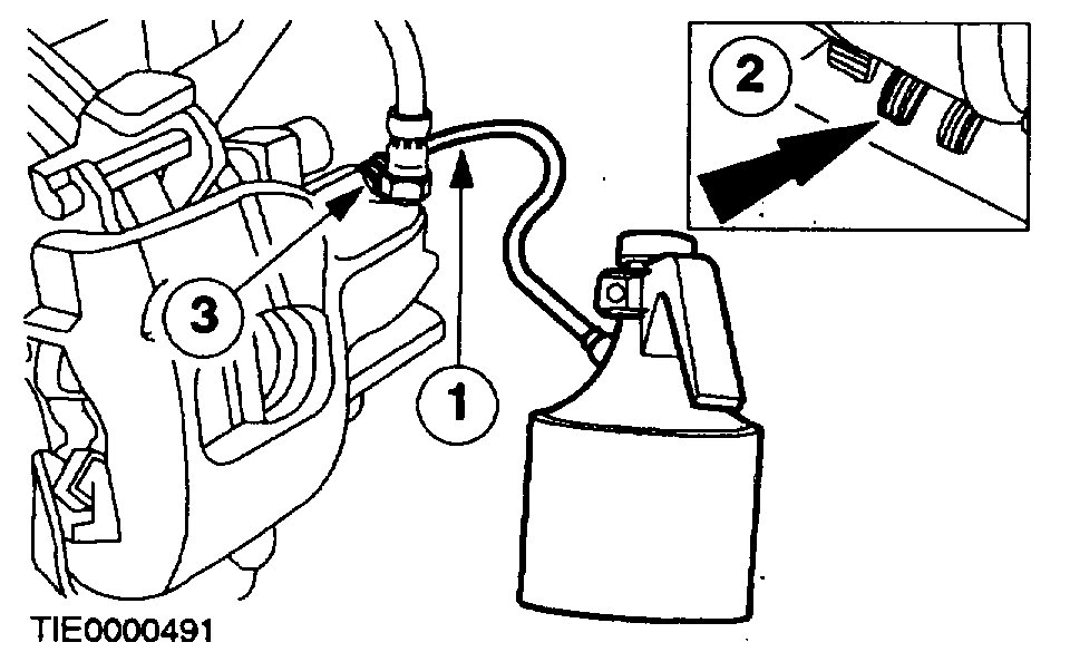

4. Loosen the wheel nuts of both front wheels.
5. Raise and support the vehicle.
6. Remove the front wheels.
Picture 3

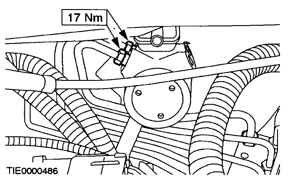

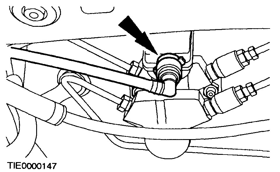

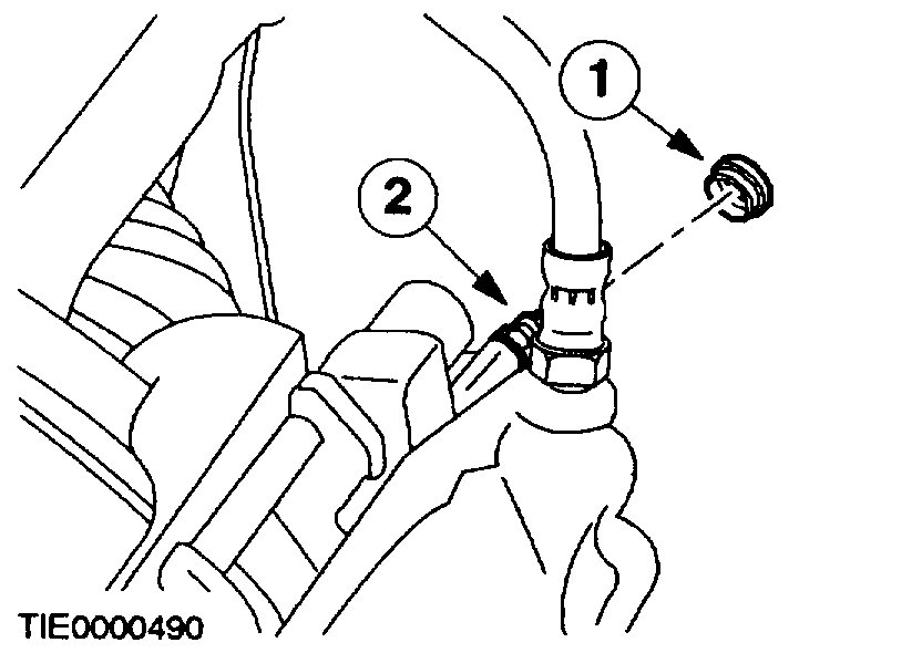

7. Loosen the bleed nipple.
1 Remove the dust cap.
2 Loosen the bleed nipple.
Picture 4
8. NOTE: Carry out this process on both the front brake lines.
Drain the brake fluid reservoir.
1 Connect a bleed tube to the bleed nipple and into a suitable container.
2 Pump the brake pedal until no more fluid is expelled.
3 Tighten the bleed nipple.

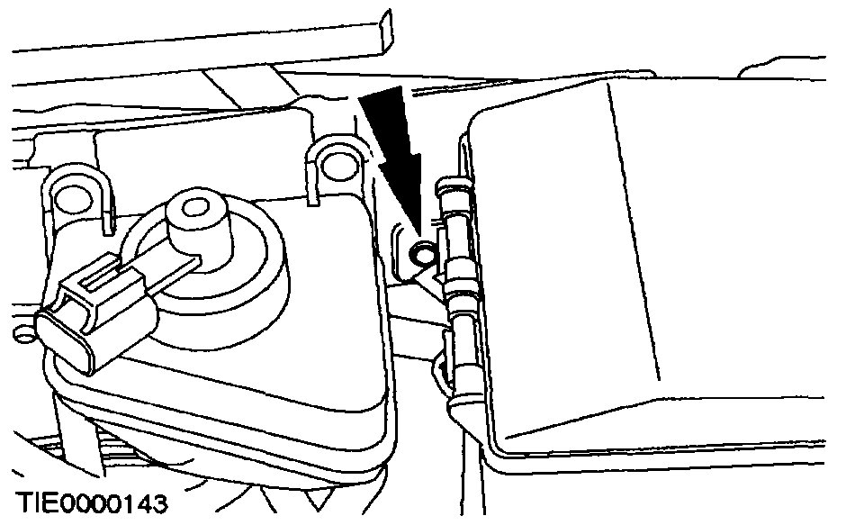

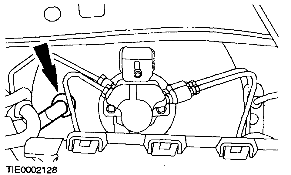

11. Remove the air cleaner.
12. Remove the air cleaner outlet tube.
Picture 5

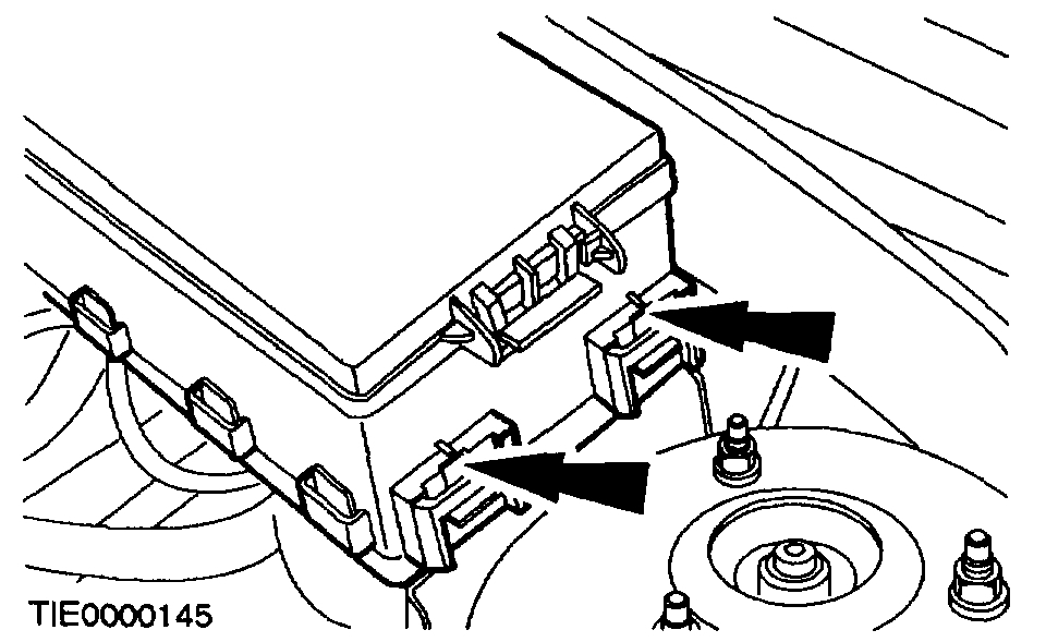

13. Disconnect the central electrical box electrical connector.
Picture 6
14. Remove the central electrical box retaining screw.
Picture 7
15. Detach the central electrical box.
^ Relocate to the air cleaner position.

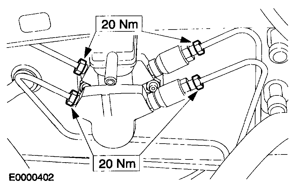

17. CAUTION: Cap the brake tube connections to prevent fluid loss or dirt contamination.
Disconnect the brake tubes.
Picture 10

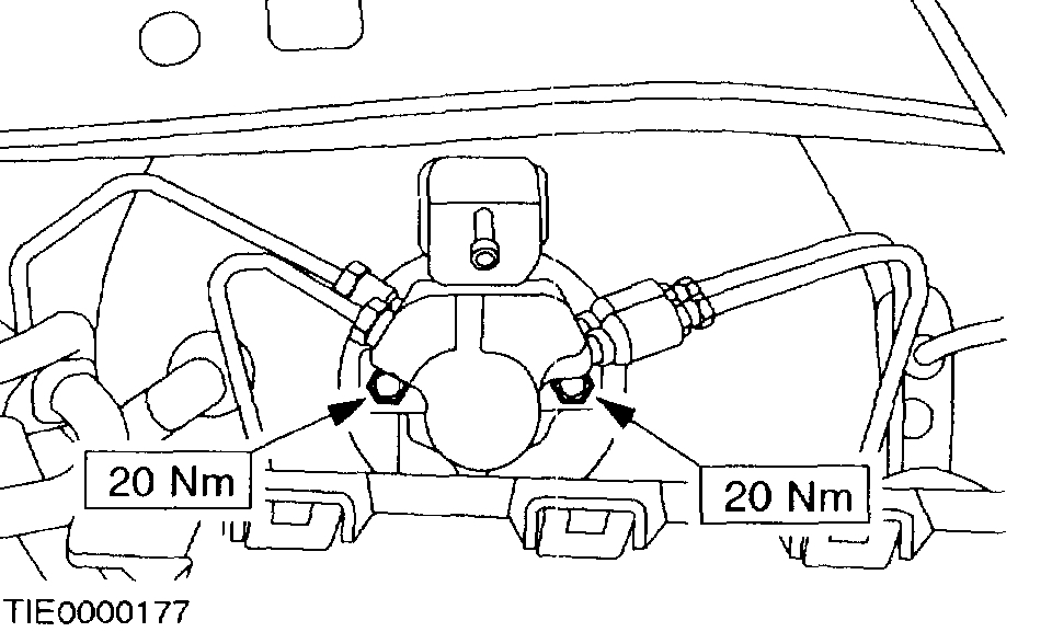

20. Remove the master cylinder.
Installation
Picture 13
Picture 14
All Vehicles
1. CAUTION: Before installing the master cylinder make sure that the vacuum seal is in place and that the mating faces are clean.
NOTE: After installation, bleed the brake system.
To install, reverse the removal procedure.
