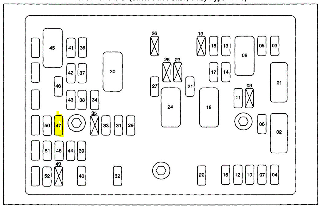

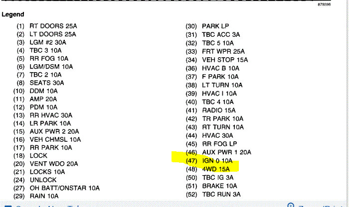

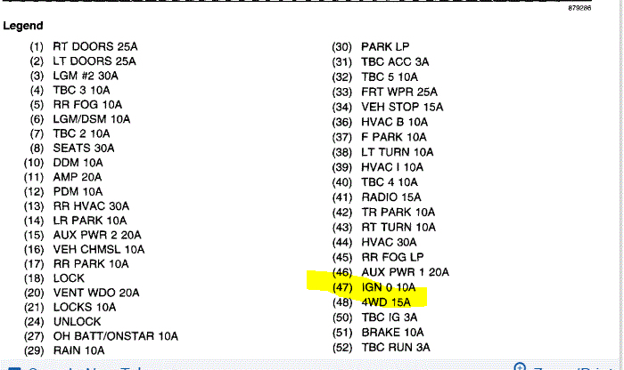

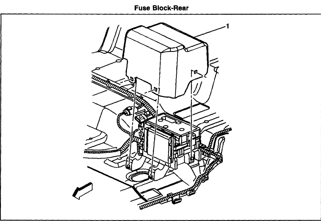

The first thing I need you to check is an ignition fuse located in the rear fuse box. I attached three pics. First shows the box, second fuse allocation, and third is the fuse location in the box.
Here are a few links you may find helpful:
Let me know if this helps and what you find. Also, I need to know if you hear anything when you try starting the vehicle and if the head lights are on, if they dim when you turn the key to the start position.
