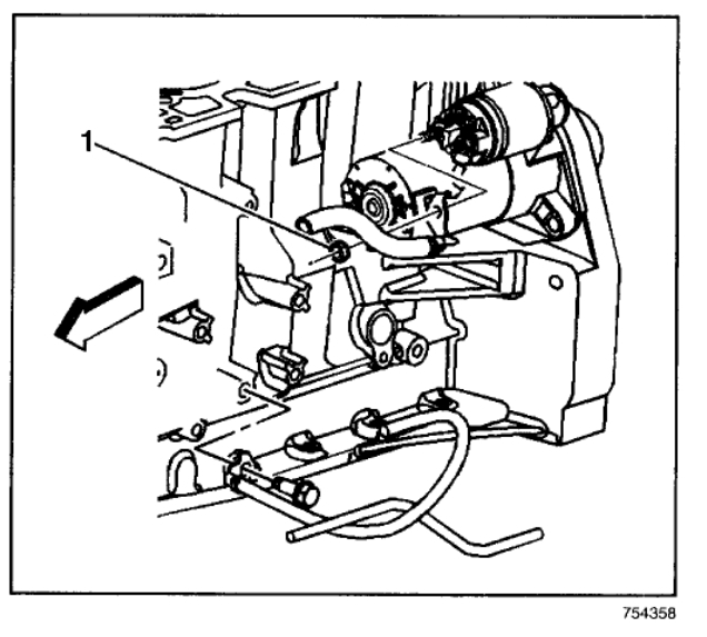

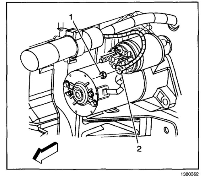

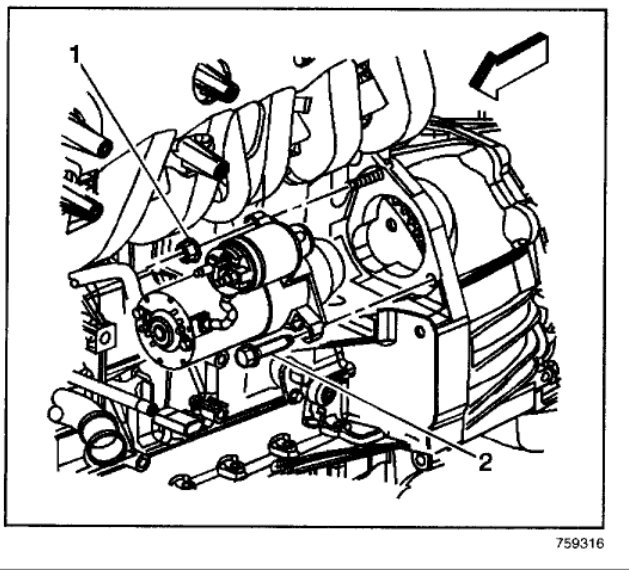

  • 55,433 POSTS
I believe it was the starter motor that was bad in this case. Here is a guide that will help you see what you are in for when doing the job.
You will need to raise up the car.
Here are some diagrams for what it will be like for your car. (below).
