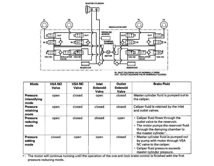

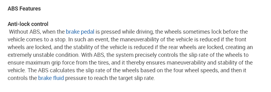

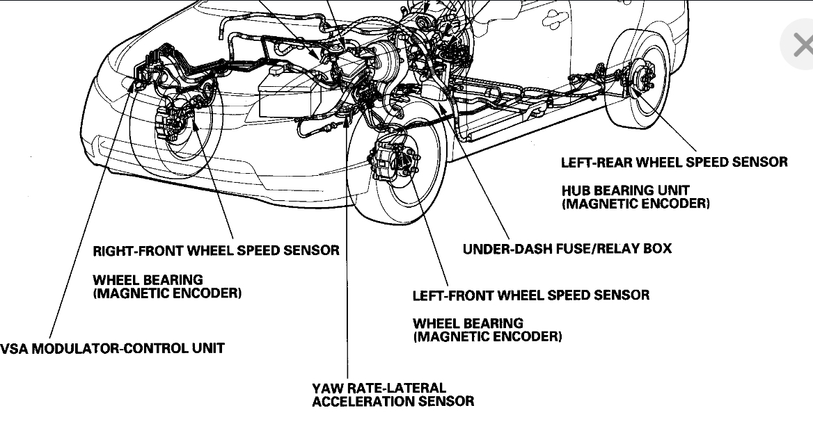

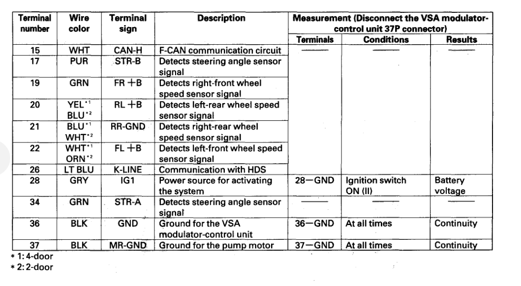

When I brake pulls right
2008 HONDA CIVIC
300,000 MILES • 1.8L • 4 CYL • 2WD • AUTOMATIC
MARKSILVA88
Just replaced all brakes and brake calipers. Suspension and tires about two months old.
May 22, 2019 at 9:48 AM

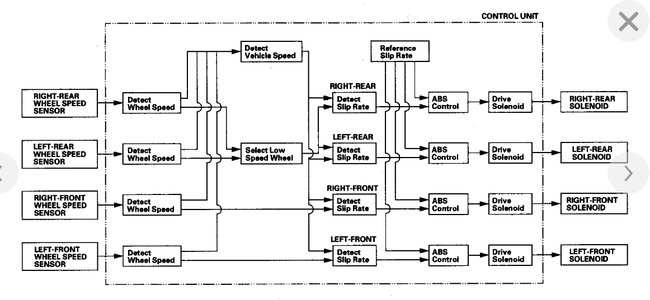

SCGRANTURISMO
  • 4,897 POSTS

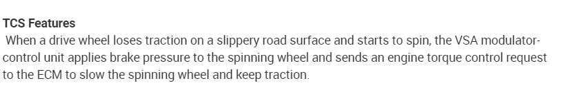

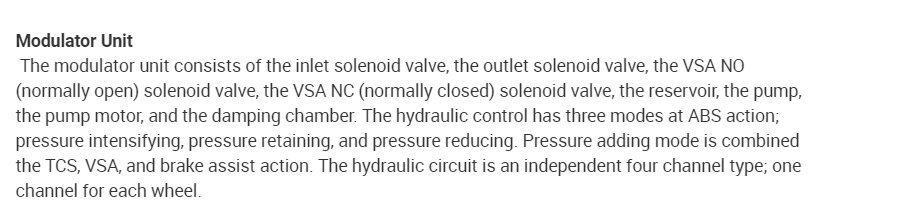

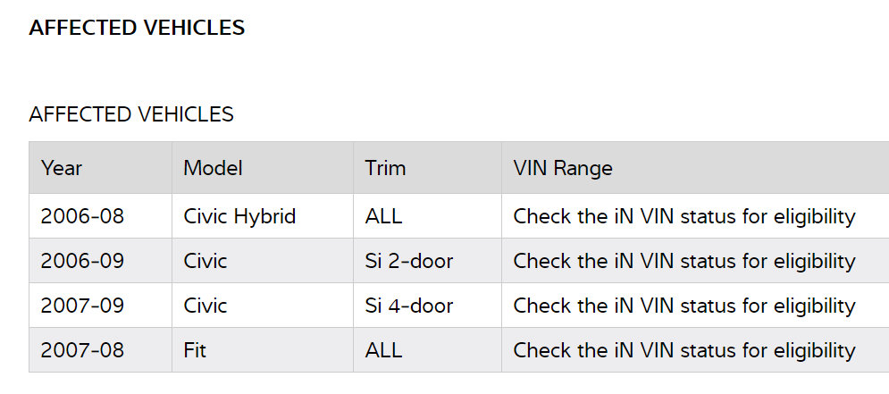

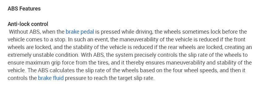

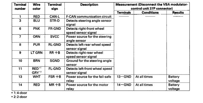

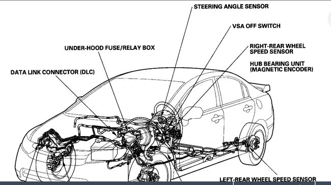

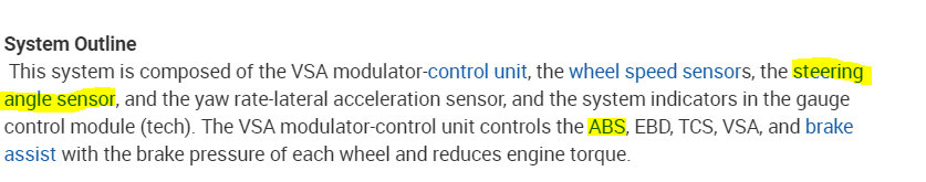

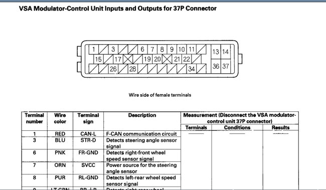

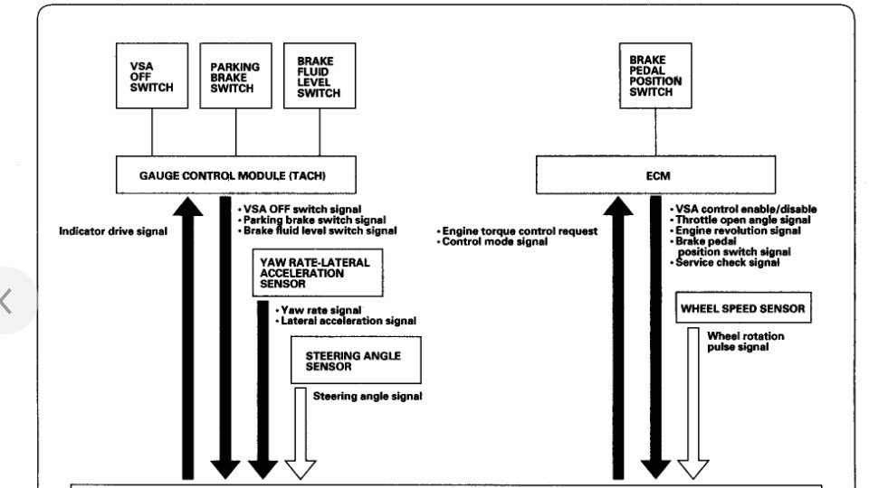

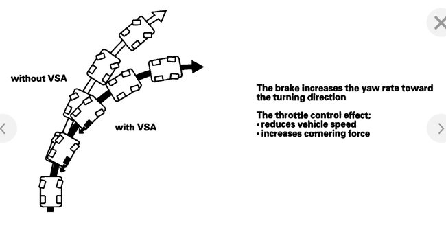

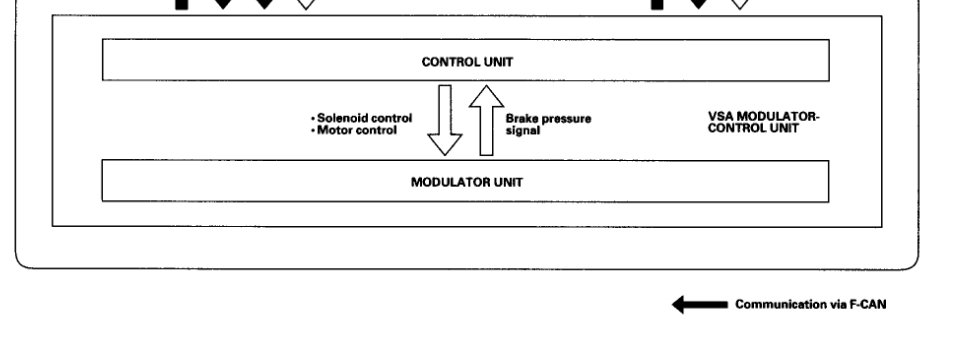

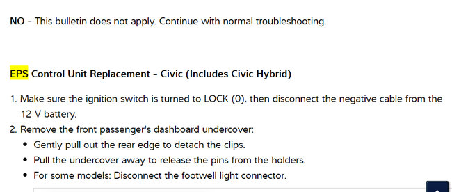

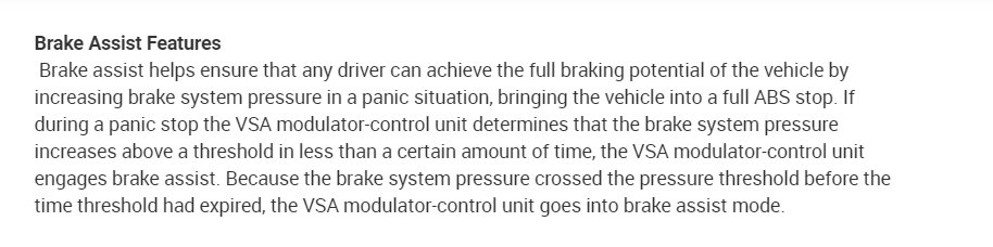

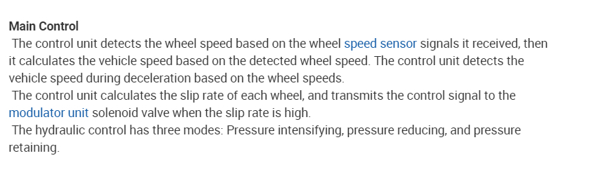

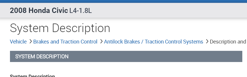

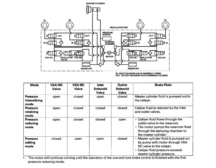

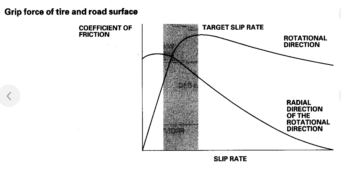

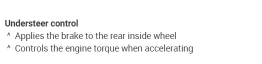

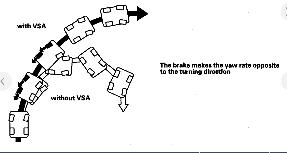

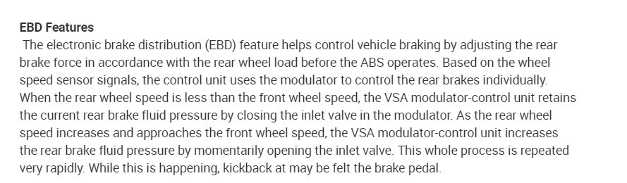

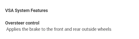

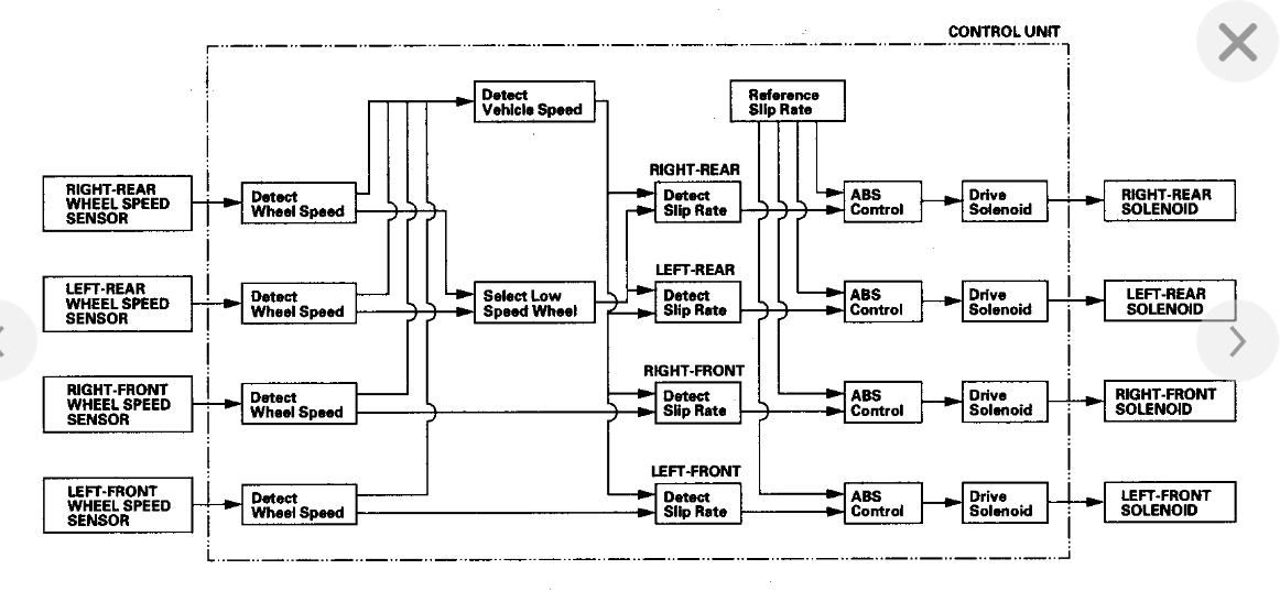

Hello ,
This could be a problem with your vehicle's Vehicle Stability Control Unit (VSA). It control not only the brake system but the steering system as well. I have included an exploded diagram of the VSA system and a description of it's operation in the diagrams down below. Please go through the information and get back to us with what you are able to find out.
Thanks,
Alex
2CarPros
May 23, 2019 at 3:59 PM

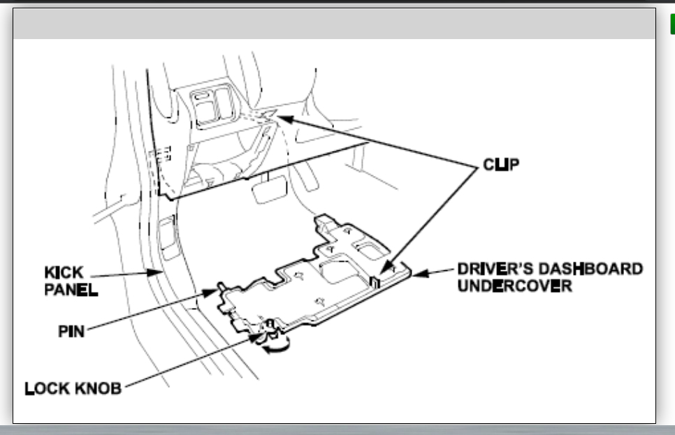

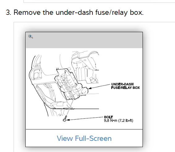

MARKSILVA88

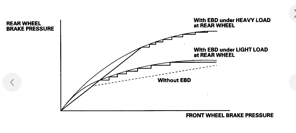

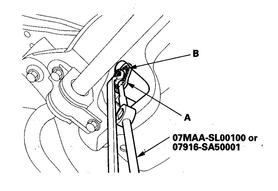

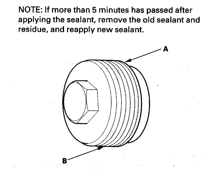

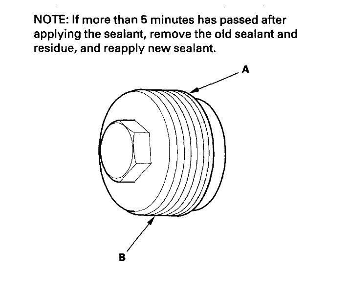

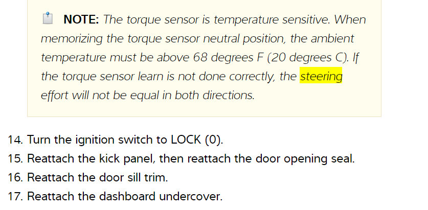

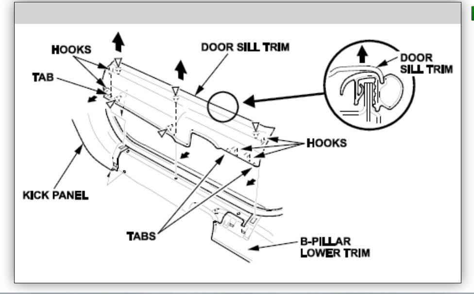

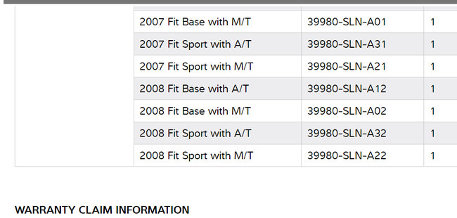

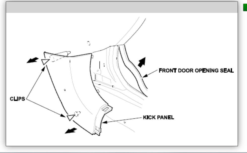

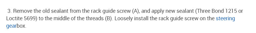

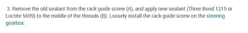

Brakes are mushy when brake pedal is applied. Going to bleed brake system this weekend to see if that helps. Also noticed that with the car off the ground in jack stands I can fairly easy move my wheels left and right with the car turned off. How do I fix the issue I am having ?
May 26, 2019 at 5:40 AM

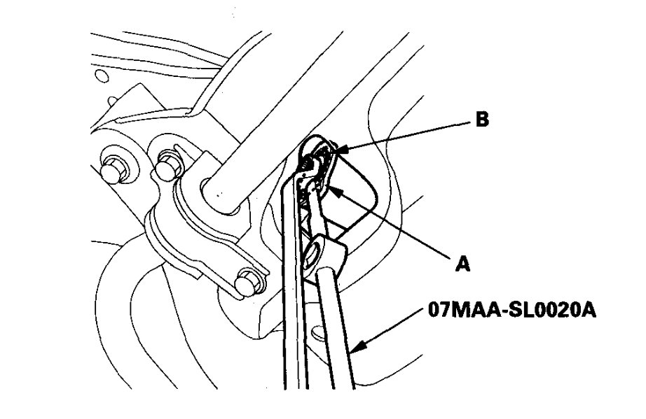

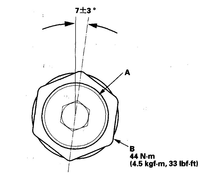

SCGRANTURISMO
  • 4,897 POSTS

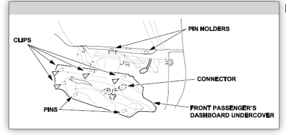

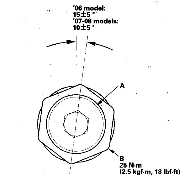

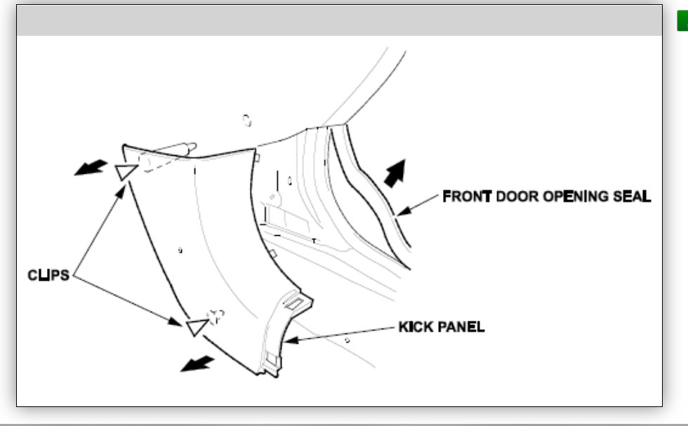

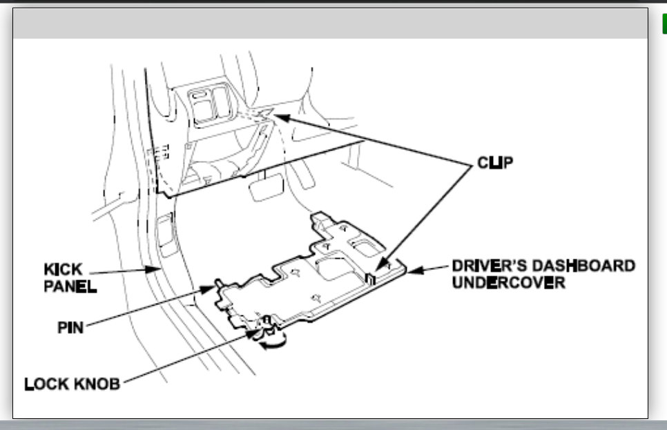

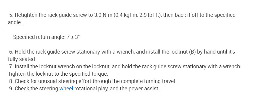

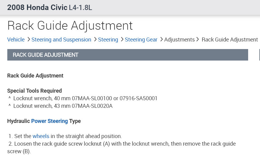

Hello again,

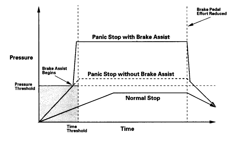

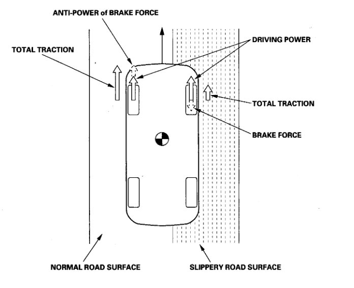

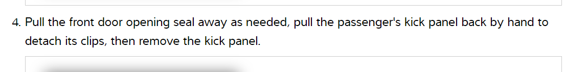

I have included the information that you required in the diagrams down below. It requires the use of a 40mm and 42mm lock nut wrench though. I have also included a Technical Service Bulletin (TSB) that may be of use to you. I'm not sure if your vehicle is included and the time has run out by a couple of months but if your vehicle is an affected one, you might be able to have the service manager repair it for you under customer loyalty so you wouldn't have to pay for it. A phone call can't hurt, all they can do is say no. Anyway get back to us with how things turn out.
Thanks,
Alex
2CarPros
May 26, 2019 at 8:04 AM

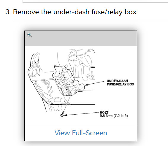

FREEMBA
  • 1,152 POSTS
Try bleeding the brakes. It's likely that air got into the system when the brakes were done. If that's the case it seems that the right front caliper is applying but the left one is not (or at least not enough). This will cause a pull to the right when the brakes are applied.
** You must bleed all four brakes; even-though you only changed the front brakes because each piston in the master cylinder controls one front and one rear brake. The master cylinder has 2 pistons.
** Brake bleeding begins with the rear passenger side wheel, followed by the rear wheel on the driver's side. Then, the front passenger side wheel and lastly the drivers side wheel.
** You may need to repeat the process if it's not satisfactory at first.
One question: When you say that the steering wheel goes left (when you hit the brakes), do you mean that the steering wheel is turning clockwise or counter-clockwise?

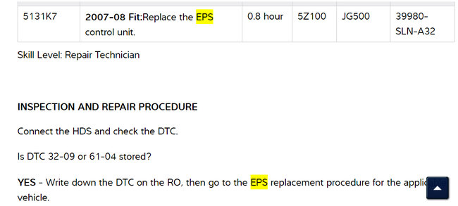

CARADIODOC
  • 34,381 POSTS
Tires can cause a pull but so can a misalignment problem. Caster is not adjustable on your car and changing it won't cause or correct a pull.
The first question is did this just start suddenly or has the pull been there for a while? The only way to know if the alignment is off is to have it checked. The mechanic is going to inspect the steering and suspension system components first. Worn struts and lower control arm bushings will cause a pull too due to changed alignment. He will also "read" the tire wear patterns for clues to the cause of a problem.
May 29, 2020 at 4:15 AM (Merged)

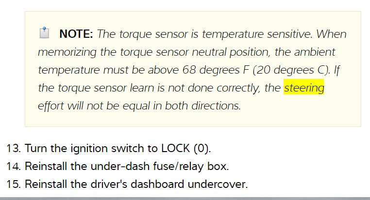

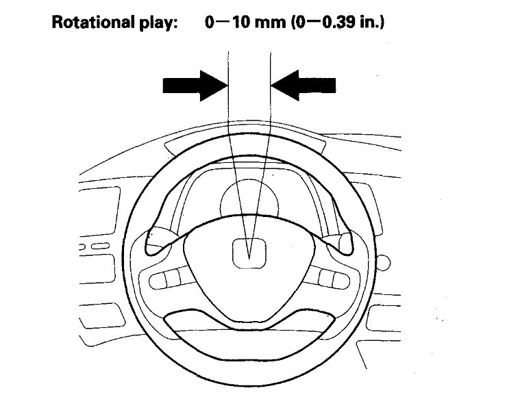

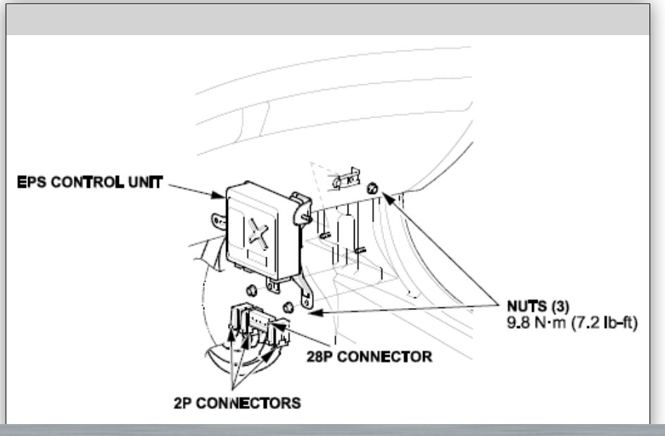

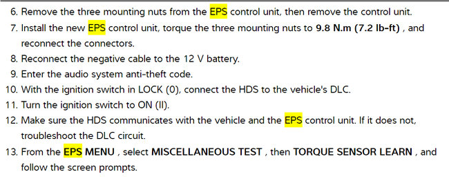

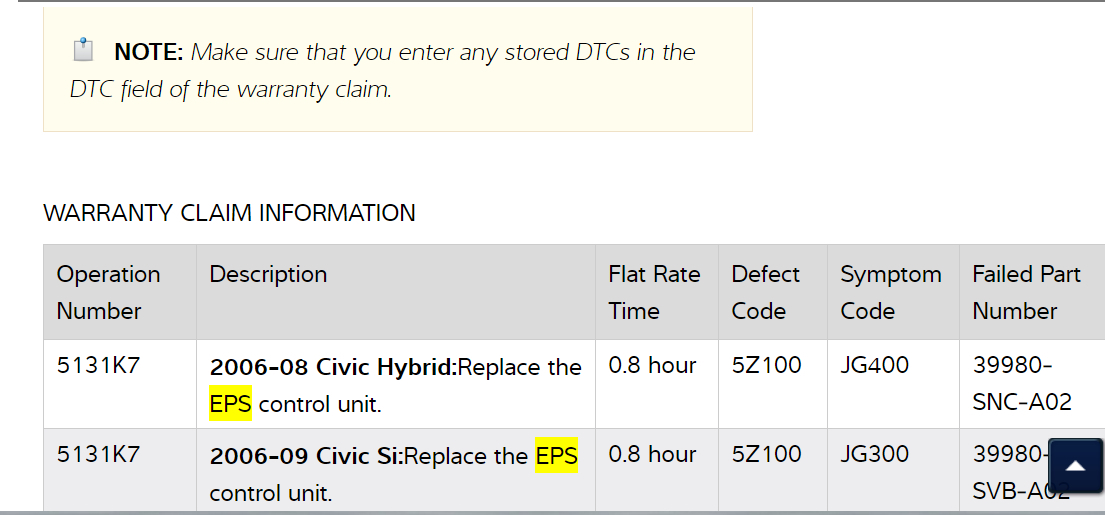

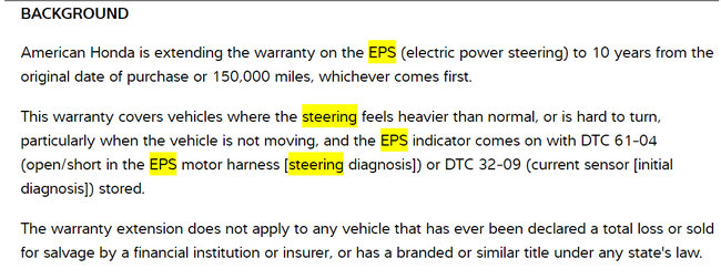

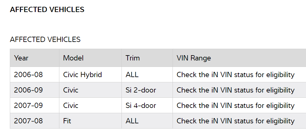

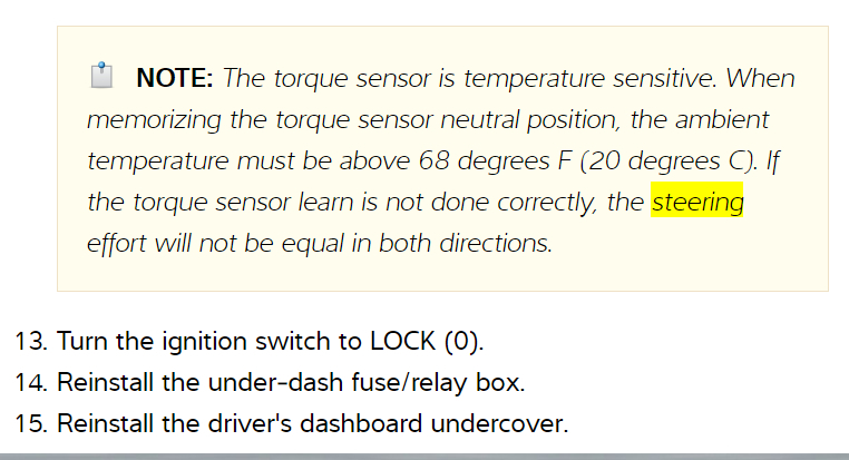

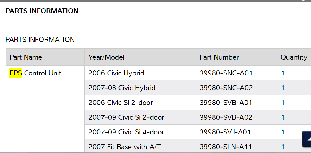

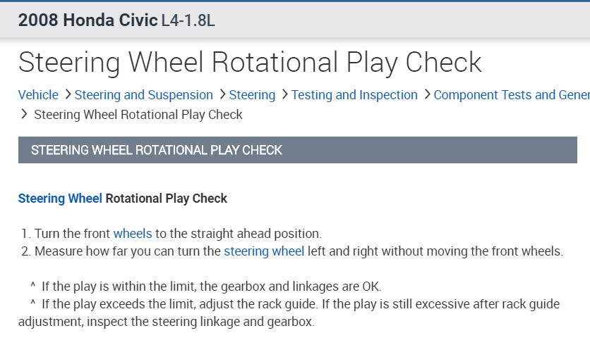

COOKY101
Thanks for the response.

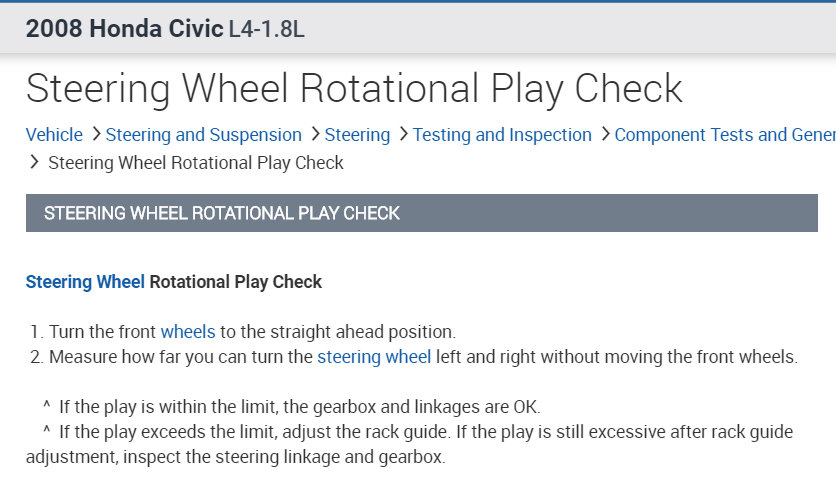

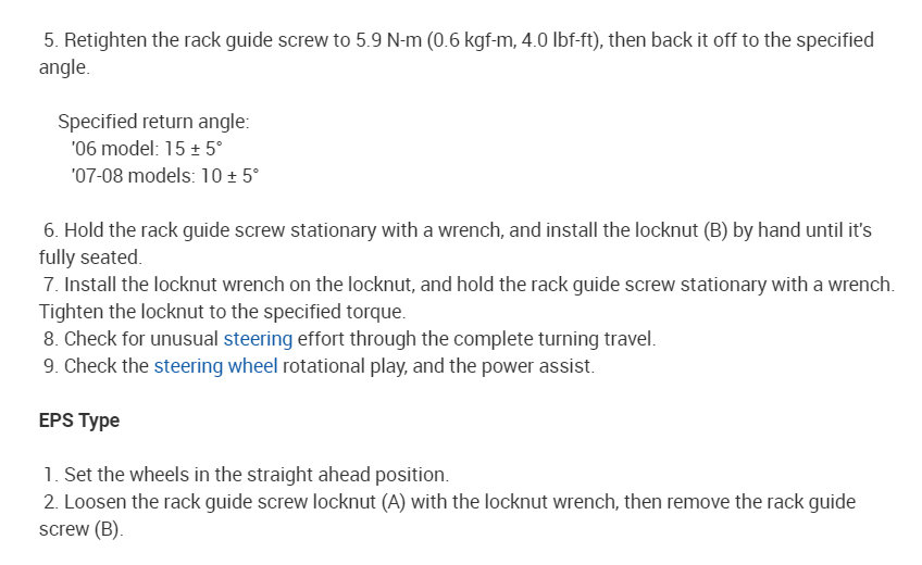

I took the car to a specialist in alignment on the weekend.

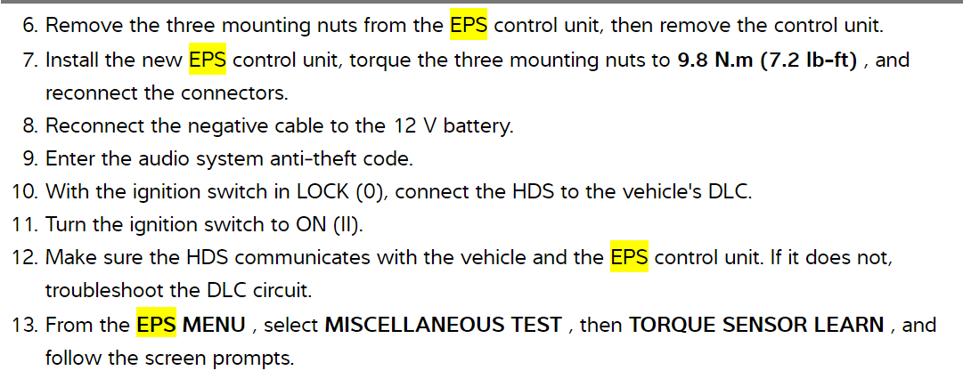

He did adjust it - very accurately - but even he accepted that there was some bias to the right hand side. He checked the bushes and the suspension and the rack.
He noticed there is a little play in the rack, suggested that this could be the issue?

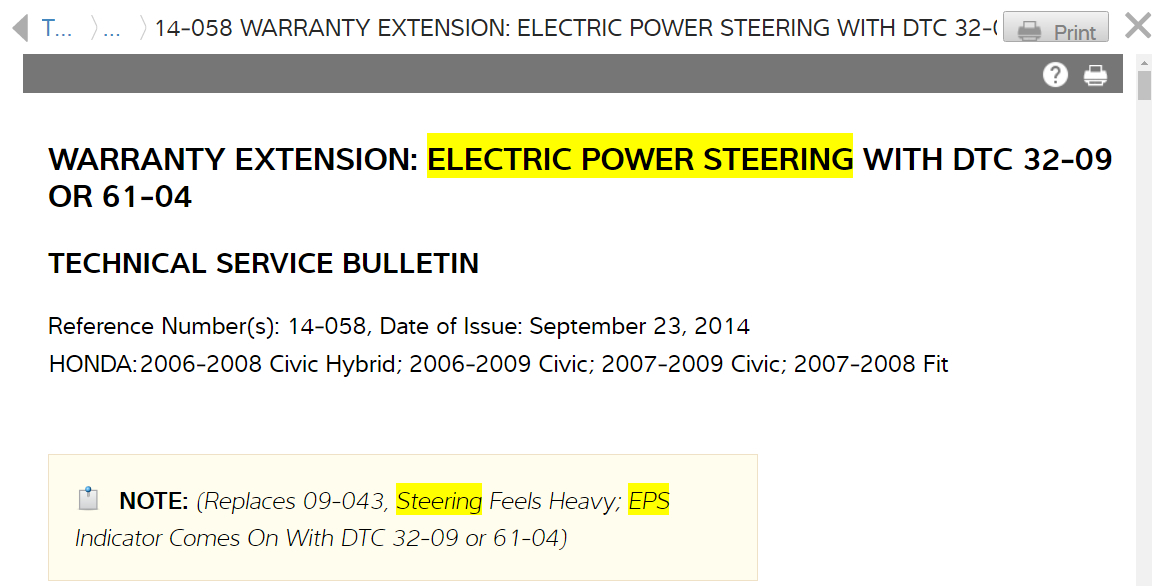

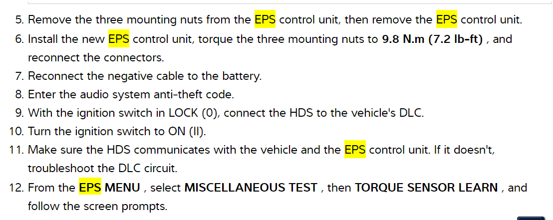

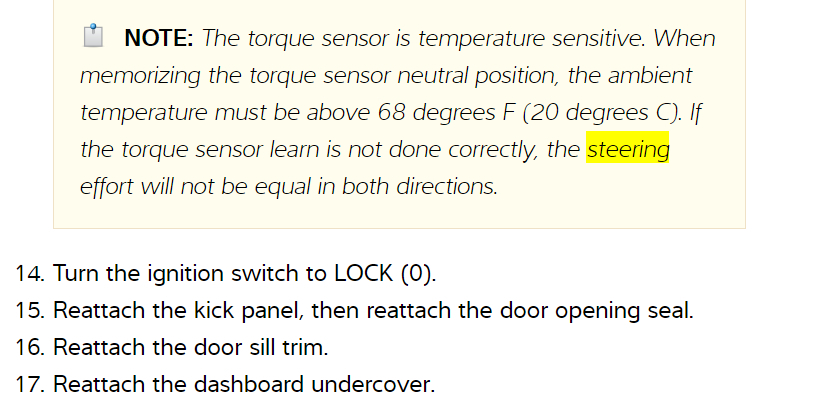

The main issue is the steering effort - it is biased to the right! only slightly, but I can feel it all the time.

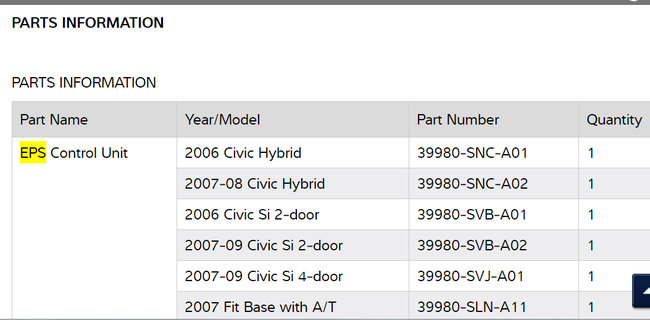

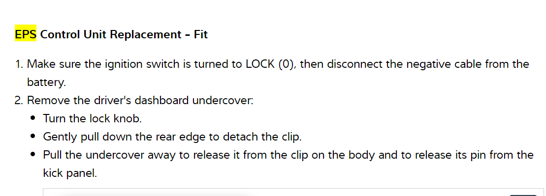

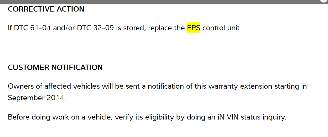

These things have EPS - could the torque sensor or rack ecu have any input in this? - I am stumped - so are all the mechanics I've tried :-(
CARADIODOC
  • 34,381 POSTS

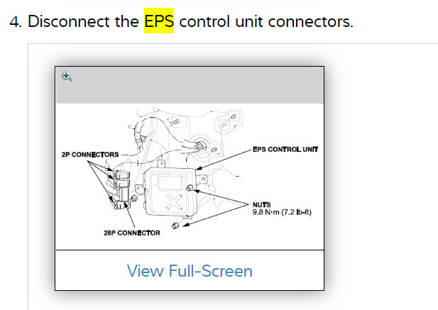

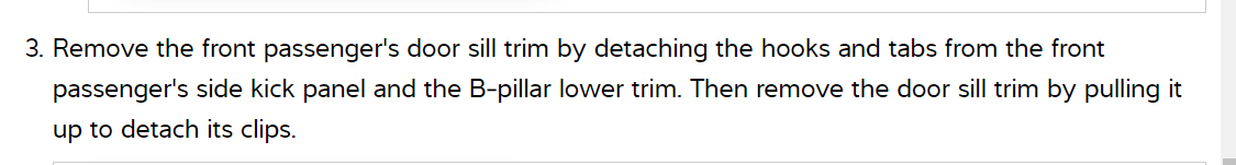

One thing to try is to disconnect everything electronic associated with the steering. It doesn't matter which circuit or system it is, adding a computer to it greatly increases the cost, diagnostic time, unreliability, and frustration, but the engineers have somehow determined that's what we want. With the electronic portion disabled, treat the steering just like on any other car. It would be helpful if you would post the readings for "caster" and "camber" for both front wheels. Normally caster is not adjustable on front-wheel-drive cars because it has such little affect on pulling compared to on rear-wheel-drive cars, but still, as it increases, steering effort gets harder. That is what provides the road feel and stability too.
Unequal caster, which causes a pull on rear-wheel-drive cars, can be offset by a similar offset of camber. While the car will go straight on level roads, the two tires will be pulling equally in opposite directions to offset each other, but for different reasons. (Think of putting a ten-pound weight on your right shoe, and a ten-pound weight in your left hand. You'll be in balance as long as you're standing still with your hands to your side). Your steering will be in balance as long as you're on a level road with no bumps. No roads are level. Most slant down to the side you're driving on so rain will run off.
Since caster is non-adjustable on your car, if it is not equal on both sides, the mechanic may need to adjust in a little difference in camber to offset it. While that can make the car go straight most of the time, you'll still have a higher steering effort in one direction. (In this case, think of a 50-pound child at the end of a teeter totter, and a 100-pound person halfway out on the other side. That will also be in balance, but to move either one of them individually, it would take more effort to move the 100-pound person up and less effort to pull him down).
I'm not sure what you mean by "bias". If you're experiencing a difference in steering effort from one way to the other, observe how the steering wheel returns too. When caster is unequal, you will typically find, (for example), the steering wheel turns easier from centered to the right than from centered to the left, but you would also find it RETURNS from left to centered easier than from right to centered. If you find it turns harder from centered to the right AND from left to centered, that points to a problem in the rack and pinion assembly.
Other things to consider are a tight ball joint and binding upper strut mounts. Most of the time those just cause harder-than-normal steering at all times, but that can be aggravated by having more weight on one side of the car.
