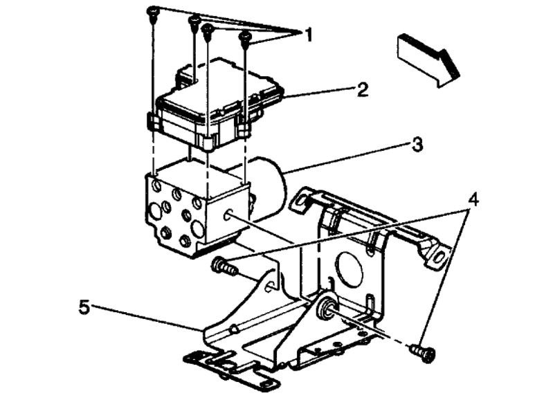

You know I just remembered that abs module is from another20 03 Sonoma is that a problem.
Wednesday, February 24th, 2021 AT 11:13 PM
  • 52,797 POSTS
The module must be programmed to your VIN number in order to work.
The module will not cause a little or no brake pedal.
https://www.2carpros.com/articles/abs-warning-light-on-easy-repair-guide
Neither code is listed for your truck. Get the module programmed and see what happens.
Electronic Brake Control Module (EBCM) Replacement
Removal Procedure
Important: After installation, calibrate the new EBCM to the tire size that is appropriate to the vehicle.
Important: Thoroughly wash all contaminants from around the EHCU. The area around the EHCU must be free from loose dirt to prevent contamination of disassembled ABS components.
1. Disconnect the electrical connectors from the EBCM (2).
2. Remove the four T 25-TORX mounting screws (1) that fasten the EBCM (2) to the BPMV (3).
3. Remove the EBCM (2) from the BPMV (3). Removal may require a light amount of force.
Important: Do not use a tool to pry the E13CM or the BPMV.
4. Clean the BPMV (3) to EBCM (2) mounting surfaces with a clean cloth.
Thursday, February 25th, 2021 AT 2:09 AM
