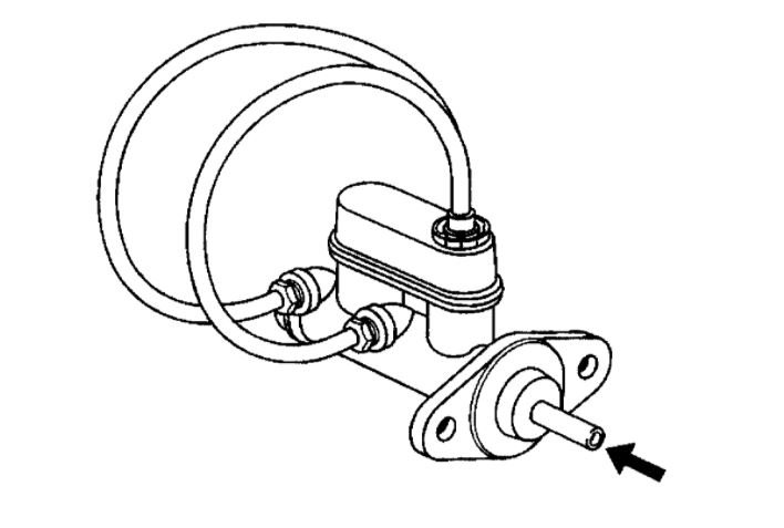

New master cylinder. I have bled with air comp assist just get little bits of fluid not a solid column of fluid. Also did auto bleed with scanner. Nothing! Prob fans proportioning valve. But don’t what to do with that.
Feb 5, 2021 at 3:27 PM
Just to be clear, you replaced the master cylinder and now you cannot get brake fluid to the rear? If this is the case, did you bench bleed the master? If not we should do that now and just start fresh.
You can do it on the vehicle, just take the lines off and get a bench bleed kit from a parts store that basically just routes the fluid back to the reservoir. They should be clear tubes so that you can see it is a solid stream coming out of each chamber.

Good afternoon,
If you have ABS, there is an automated process to bleed the ABS module. If you have air in the system, this must be done.
I posted it below for you along with the procedure for bench bleeding the master cylinder.
https://www.2carpros.com/articles/how-to-replace-a-brake-master-cylinder
Master Cylinder Bench Bleeding
Notice: When adding fluid to the brake master cylinder reservoir, use only Delco Supreme 11, GM P/N 12377967 (Canadian P/N 992667), or equivalent DOT-3 brake fluid from a clean, sealed brake fluid container. The use of any type of fluid other than the recommended type of brake fluid, may cause contamination which could result in damage to the internal rubber seals and/or rubber linings of hydraulic brake system components.
1. Secure the mounting flange of the brake master cylinder in a bench vise so that the rear of the primary piston is accessible.
2. Remove the master cylinder reservoir cap and diaphragm.
3. Install suitable fittings to the master cylinder ports that match the type of flare seat required and also provide for hose attachment.
4. Install transparent hoses to the fittings installed to the master cylinder ports, then route the hoses into the master cylinder reservoir.
5. Fill the master cylinder reservoir to at least the half-way point with Delco Supreme 11, GM P/N 12377967 (Canadian P/N 992667), or equivalent DOT-3 brake fluid from a clean, sealed brake fluid container.
6. Ensure that the ends of the transparent hoses running into the master cylinder reservoir are fully submerged in the brake fluid.
7. Using a smooth, round-ended tool, depress and release the primary piston as far as it will travel, a depth of about 25 mm (1 lbs.), several times. Observe the flow of fluid coming from the ports.
As air is bled from the primary and secondary pistons, the effort required to depress the primary piston will increase and the amount of travel will decrease.
8. Continue to depress and release the primary piston until fluid flows freely from the ports with no evidence of air bubbles.
9. Remove the transparent hoses from the master cylinder reservoir.
10. Install the master cylinder reservoir cap and diaphragm.
11. Remove the fittings with the transparent hoses from the master cylinder ports. Wrap the master cylinder with a clean shop cloth to prevent brake fluid spills.
12. Remove the master cylinder from the vise.

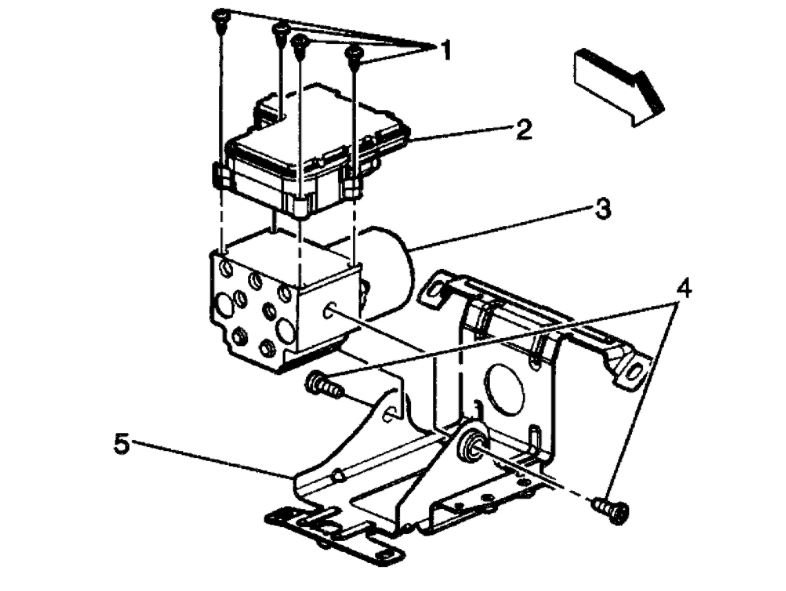

Also found trouble code c0222 and c0226. something about missing it front speed sensor. Would that cause ABS light and no pedal?
Feb 24, 2021 at 6:54 PM
DOOB
  • 72 POSTS
You know I just remembered that abs module is from another20 03 Sonoma is that a problem.
Feb 24, 2021 at 11:13 PM
The module must be programmed to your VIN number in order to work.
The module will not cause a little or no brake pedal.
https://www.2carpros.com/articles/abs-warning-light-on-easy-repair-guide
Neither code is listed for your truck. Get the module programmed and see what happens.
Electronic Brake Control Module (EBCM) Replacement
Removal Procedure
Important: After installation, calibrate the new EBCM to the tire size that is appropriate to the vehicle.
Important: Thoroughly wash all contaminants from around the EHCU. The area around the EHCU must be free from loose dirt to prevent contamination of disassembled ABS components.
1. Disconnect the electrical connectors from the EBCM (2).
2. Remove the four T 25-TORX mounting screws (1) that fasten the EBCM (2) to the BPMV (3).
3. Remove the EBCM (2) from the BPMV (3). Removal may require a light amount of force.
Important: Do not use a tool to pry the E13CM or the BPMV.
4. Clean the BPMV (3) to EBCM (2) mounting surfaces with a clean cloth.
