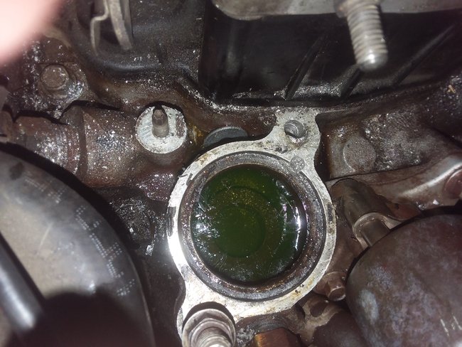

Got a problem changed out my thermostat discover I have small hole right next to where my thermostat sits. I had a small leak now I know where my water was going. what is best to seal the hole? I had to add a little water every now and then. what do you recommend?

Can you upload a pic of the hole so I can see what you are dealing with? If it is aluminum you are dealing with, the right way is to mig weld. They make products for metal repairs, I don't know how well they can take the pressure.

You will have to blow it up to see the hole it's to the right of the bolt hole the hole is not all the way though it's just enough to cause a leak.

There is a bunch of sealants epoxy's out there like JB water weld an others I been told that gorilla glue got some stuff out that might work I just don't know which one I sure go with. I know in time I will have to replace the intake but maybe I can prolong it until it starts getting warmer and I have more funds.

I decided to just go ahead an get me a new manifold an b done.
Aug 27, 2020 at 11:31 AM
  • 110,248 POSTS
Actually, that is the best thing to do. Let me know when we can get back the brake issue.

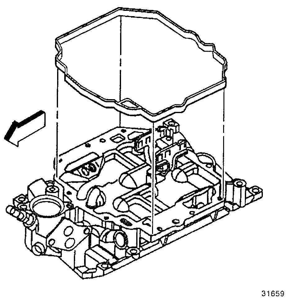

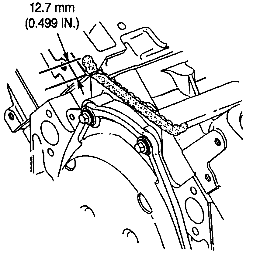

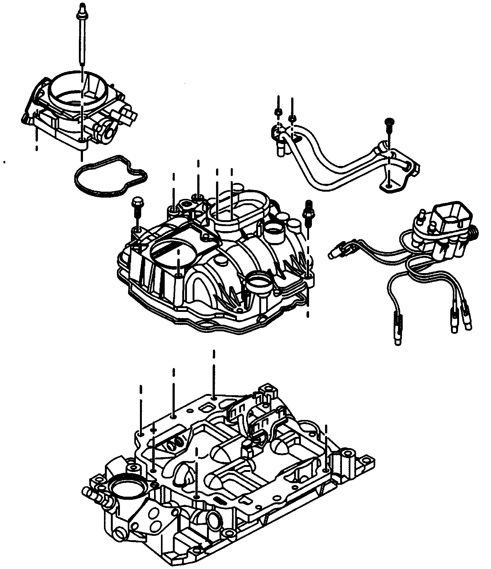

1996 Chevy Truck S10/T10 P/U 2WD V6-4.3L VIN W
Intake Manifold Replacement (Upper)
Vehicle Engine, Cooling and Exhaust Engine Intake Manifold Service and Repair Procedures Intake Manifold Replacement (Upper)
INTAKE MANIFOLD REPLACEMENT (UPPER)
Upper Intake Manifold And Components
pic 1
Upper Intake Manifold Installation
pic 2
REMOVE OR DISCONNECT
1. Negative battery cable.
2. Drain the engine coolant.
3. Air cleaner inlet duct.
4. Wiring harness connectors and brackets.
5. Throttle linkage and bracket.
6. Fuel lines and bracket at the rear of the lower intake manifold.
7. Brake booster vacuum hose.
8. Ignition coil.
9. PCV pipe and vacuum hoses.
10. Purge solenoid and bracket.
11. Upper intake manifold bolts and manifold. Mark the location of the bolts for proper reassembly.
INSTALL OR CONNECT
1. New upper manifold gasket with sealing lines facing up.
2. Upper intake manifold. Do not pinch the injector wires between the upper and lower intake manifolds.
3. Upper intake manifold bolts and studs noting the marks made during disassembly. Tighten the bolts in two steps:

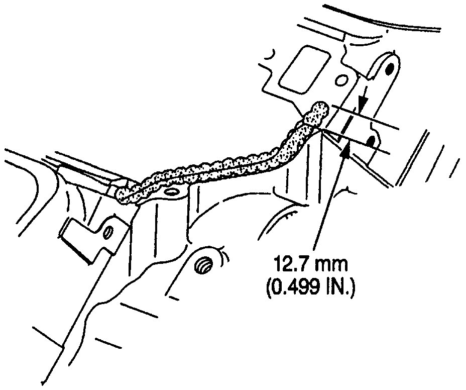

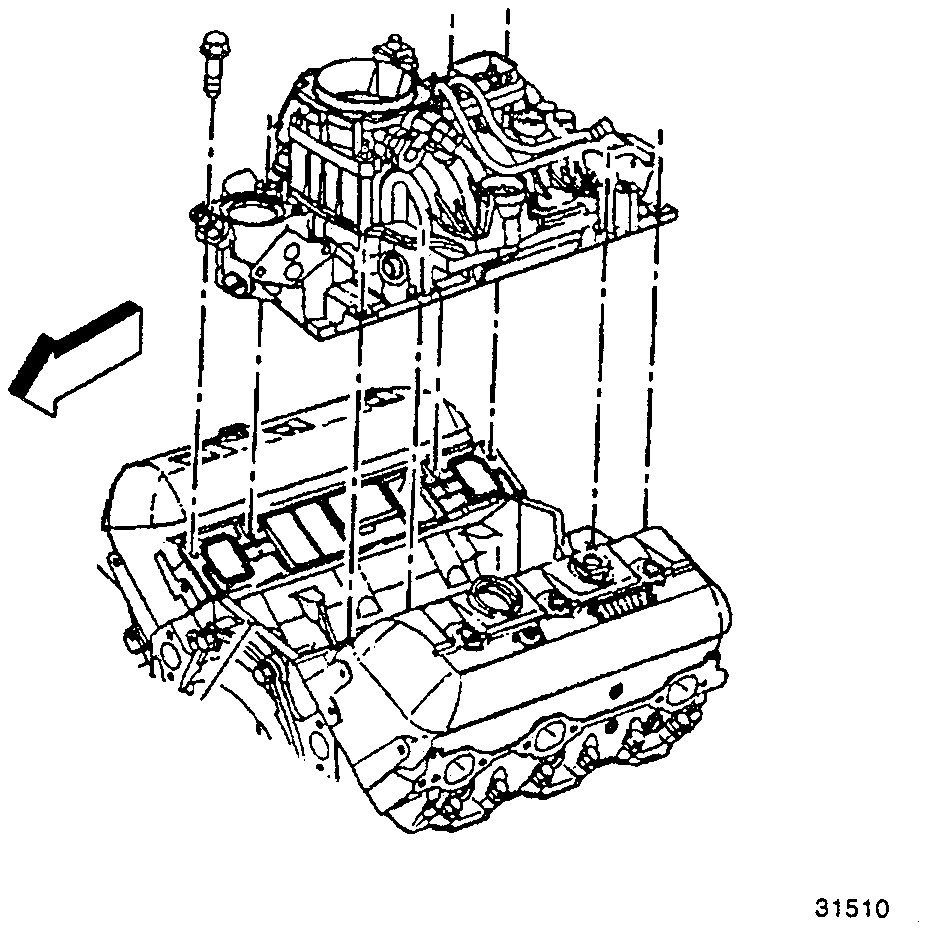

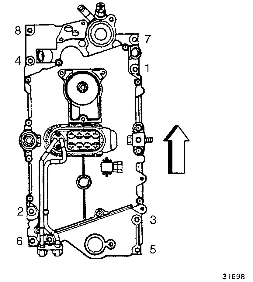

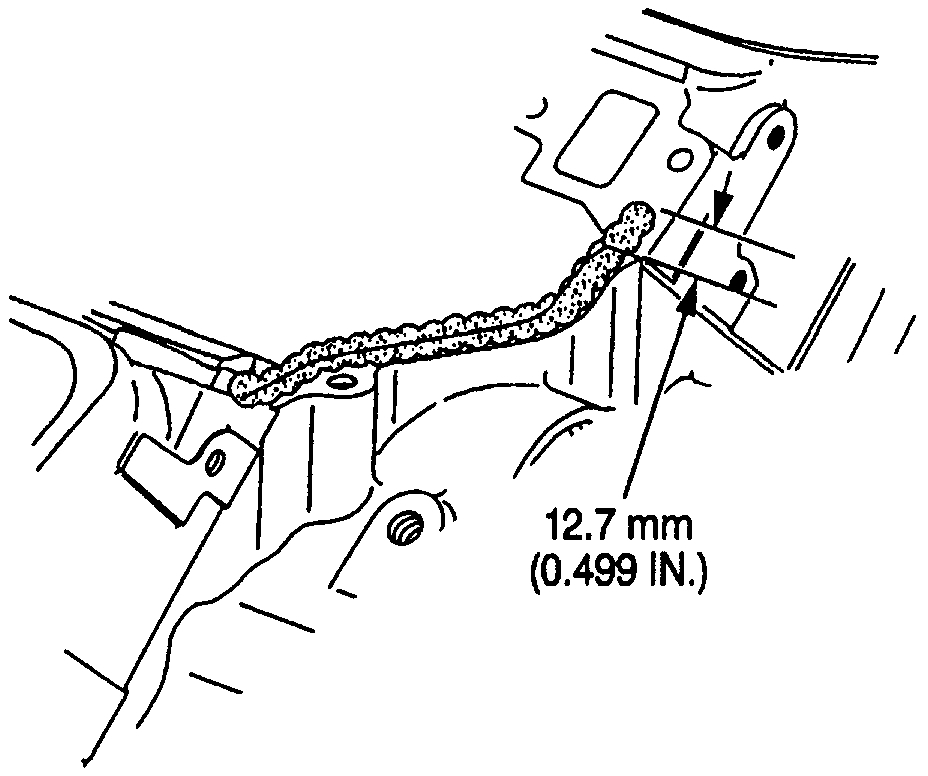

Intake Manifold Replacement (Lower)
Vehicle Engine, Cooling and Exhaust Engine Intake Manifold Service and Repair Procedures Intake Manifold Replacement (Lower)
INTAKE MANIFOLD REPLACEMENT (LOWER)
pic 3
Applying Sealant To The Rear Of The Block
pic 4
Applying Sealant To The Front Of The Block
pic 5
Tightening Sequence
pic 6

1. Gaskets onto the cylinder head with the port blocking plates facing the rear of the engine and the "This Side Up" stamping facing up.
2. Apply a 5 mm (1/4 inch) thick bead of Wacker T-330 RTV, GM P/N 12346192 to the front and rear sealing areas of the engine block and intake manifold. Extend the RTV bead 13 mm (0.499 inch) up the cylinder head in order to seal and retain the gaskets.
3. Lower intake manifold to the engine and apply sealer to the lower intake manifold bolts.
4. Install the lower intake manifold bolts. Tighten bolts in sequence and in three steps:
a. First sequence to 3 Nm (27 in lbs).
b. Second sequence to 12 Nm (106 in lbs).
c. Final sequence to 15 Nm (11 ft lbs).

I got Permatex steel and metal weld and going to put a threaded stud in the bolt hole an fill it with Permatex steel an metal weld and let it sit and dry good overnight and put some in that little hole. maybe this will buy me some time. I will see how it goes an go from there.
  • 110,248 POSTS
Sounds like a plan. Keep me in the loop. Hopefully that will buy you some time. However, I feel really confident you will be able to replace the manifold when you are ready.

The permatex held long enough for a text short drive an that was it. It started leaking. So I found a self tapping bolt so I am good now.
