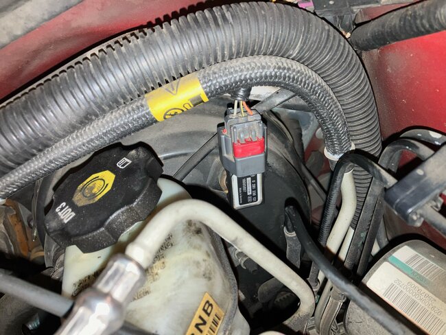

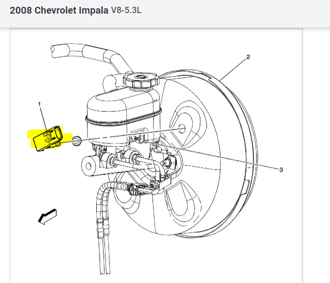

  • 110,248 POSTS

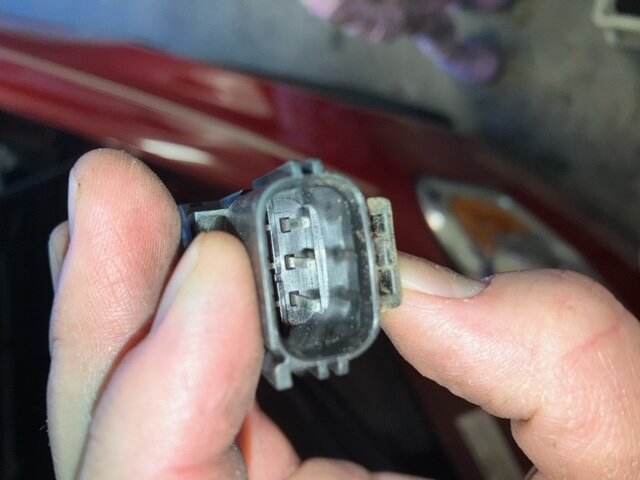

There is a brake booster pressure sensor mounted on the vacuum brake booster under the hood. (see pic below).
Do me a favor. Check the electrical connector on that sensor. Remove it and inspect the connector pins to make sure there is no damage or corrosion that may be causing an issue.
See pic below.

Sorry for late reply. I will definitely look into this. I looked up a video of a guy on YouTube who changed out this part and he said he was experiencing the same vehicular symptoms as me. Wouldn't a bad brake booster sensor cause a stiffer brake pedal though?
Feb 25, 2024 at 3:00 AM
  • 110,248 POSTS
The sensor can cause a stiff pedal or one that is too soft.

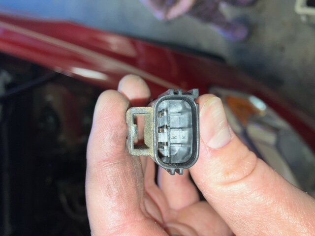

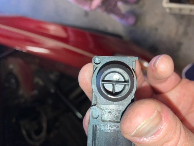

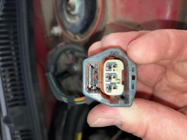

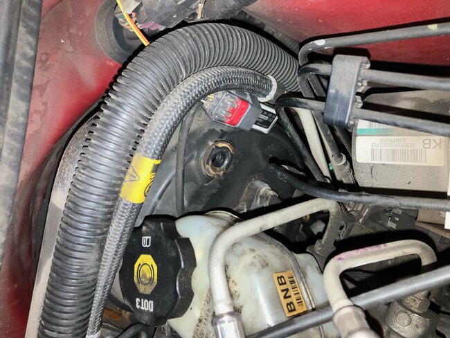

Okay, so I think I found what could be this issue. I took the sensor out, but it looked fine. I will have pictures below. No corrosion that I could see on/in any of the sensor or the wires. However when I removed it, it seemed to leak booster pressure a bit too easy. Just by rotating the sensor to loosen it, I could hear pressure releasing. When I put it back in, the bottom right of the hole was loose. I took a picture of the hole and I can't tell if it is a washer seal issue or an issue with the threads in the hole of the booster. I will attach a picture of the hole and you can zoom in on that bottom right to see what I mean.
Feb 26, 2024 at 12:49 AM
DMHUGGINS26
  • 24 POSTS
Here is a larger image of the hole.
Feb 26, 2024 at 12:55 AM
  • 110,248 POSTS
Where the sensor mounts doesn't look out of the ordinary. Also, when you turn the sensor, it releases pressure, and you will hear the vacuum. It could be the sensor itself.

Okay. Well, I suppose I am going to replace that sensor. I saw they typically come with a new rubber grommet too. How sure do you think the sensor is the issue? Just double checking because it looks a bit pricey. Lol Because the problem has been so intermittent, it also will take me a while to tell if that fixed the issue.
