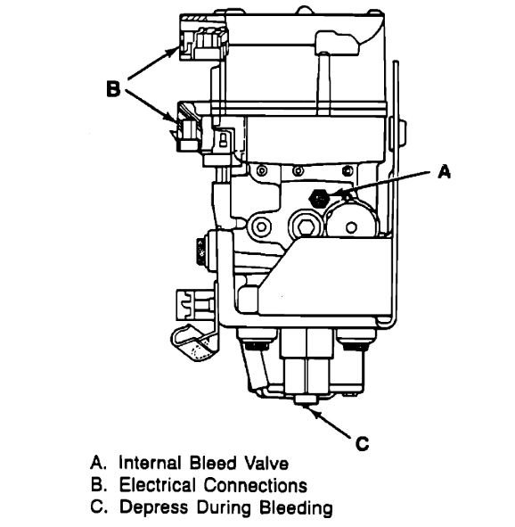

Do you mean the ABS brake module? you are not getting any fluid out of or do you mean the caliper itself? I would check the bled valve they can clog up
Feb 22, 2021 at 5:32 PM (Merged)
CHOPPED53
Just on of the valves on the ABS module where it goes to the left front.
AL514
  • CERTIFIED EXPERT
  • 5,465 POSTS
Sounds like the solenoid may be stuck closed inside the ABS module. Have you tried unplugging the electrical connector to the module? that will tell you if the solenoid is staying energized or if its just stuck closed. The solenoid should be open unless the ABS unit is energized. As you said the others are bleeding okay.

HMAC300
  • CERTIFIED EXPERT
  • 48,601 POSTS
have a professioanl use their scanner to open ABS unit and bleed system properly.

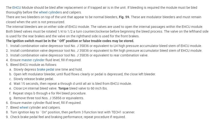

  • CERTIFIED EXPERT
Good evening,
Convention bleeding on a truck rarely works. There is not enough pedal push to get the air out.

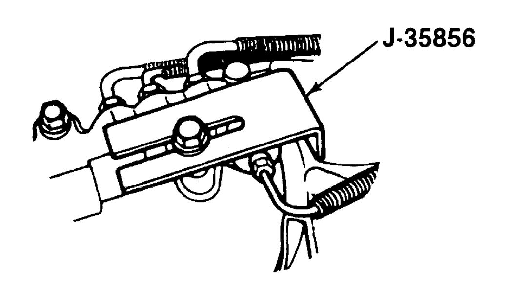

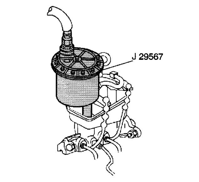

you need to power bleed the system. That is where you attach a cover to the top of the master cylinder and the air is applied to the master. Then you open the bleeders in sequence until the air is gone.
a side note. If you have ABS, you will need to do the other procedure I attached as well. Convention and pressure bleeding does not get the air out of the ABS unit.
Pressure Bleeding
Note: The pressure bleeding equipment must be of the diaphragm type. It must have a rubber diaphragm between the air supply and the brake fluid to prevent air; moisture, oil, and other contaminants from entering the hydraulic system. Also adapters are needed. depending on the type of master cylinder used.
Tools Required:
J-29567 Brake Bleeder Adapter (Plastic Reservoir)
J-35856 Combination Valve Depressor
Note: It is very important that the correct master cylinder bleeder adapter be used to avoid possible damage to the master cylinder reservoir.

2. Use J-35856 to depress and hold the valve stem on the combination valve during the bleeding operation.
a. Install the bleeder adapter so the leg with the release valve is towards the cowl.

4. Connect the hose from the bleeder to the adapter at the master cylinder.

8. Open the bleeder screw on the Isolation/Dump Valve (vehicles with power brakes only).
a. Allow the fluid to flow until no air is seen in the fluid.
b. Close the bleeder screw.
9. Check the brake pedal for "sponginess", repeat the entire bleeding procedure if this condition is found.
10.Remove J-35856.
