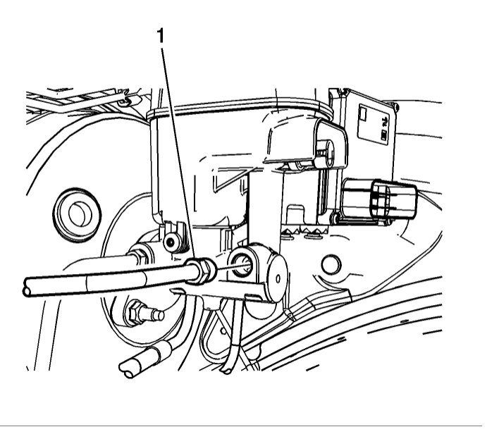

Bought the car a few days ago. Car was driving and stopping fine. The next day I was driving slowly in traffic and tried to stop. The car slowly came to a stop. While at a stop the brake pedal seemed to start going further down on its own and the car started to slowly move. I had to press the brake down further and harder to get the car to stop moving. I have never experience this before and it has happened several times since with no warning. It sometimes does it when the car is on the highway at a speed of fifty five to sixty mph.I have to be extremely forceful to get the car to stop. I have had the brake fluid checked and the rotors. I was told that it was because i was short? Shortness does not cause a brake pedal to start slowly moving on its own. Help please.
Jul 12, 2017 at 12:44 AM
  • 55,743 POSTS

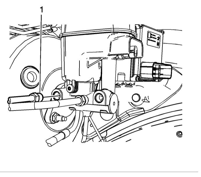

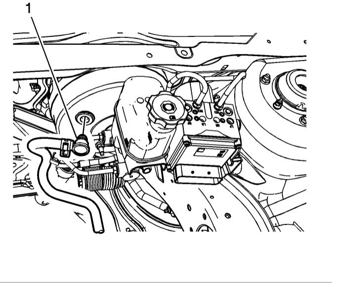

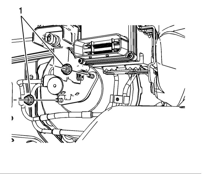

It sounds like you have a bake master cylinder that is going out allowing he fluid to bypass internally. Here are the master cylinder installation instruction you have requested. Here is a guide to help you step by step with instructions in the diagrams below to show you how on your car.
https://youtu.be/WDxvEQrMkBg
and
https://youtu.be/w7gUsj2us0U
and
https://www.2carpros.com/articles/how-to-replace-a-brake-master-cylinder
