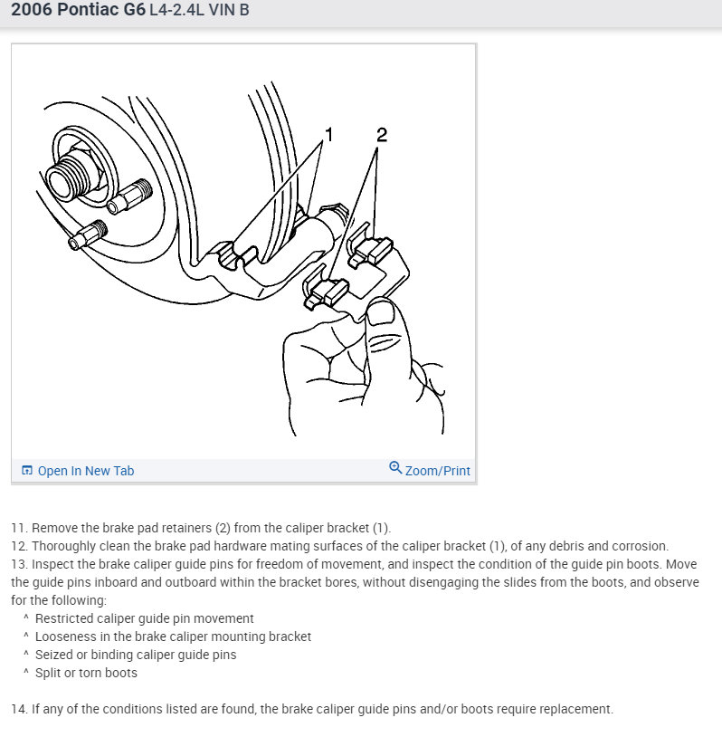

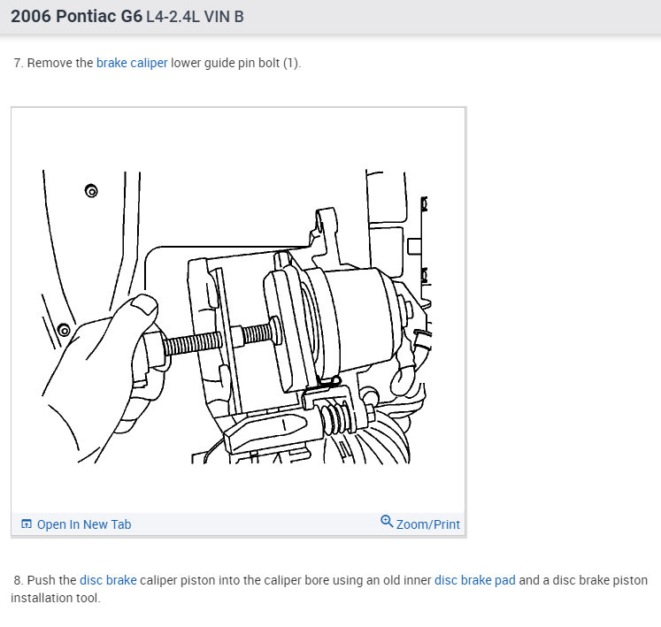

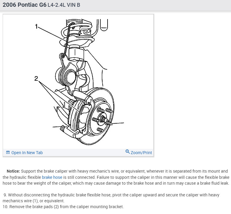

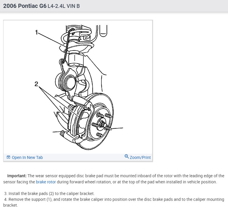

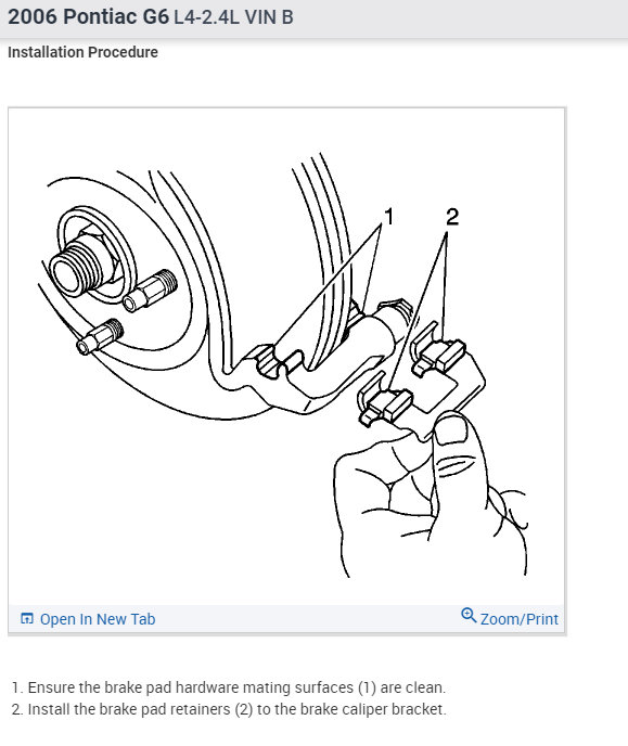

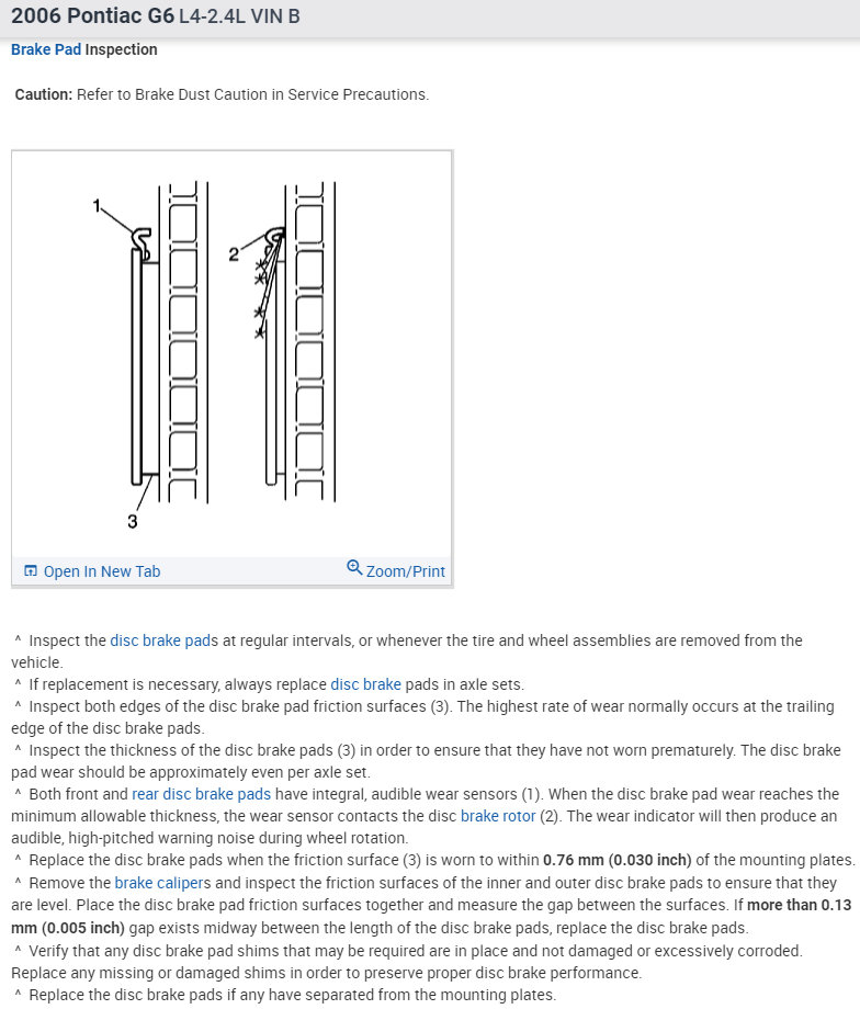

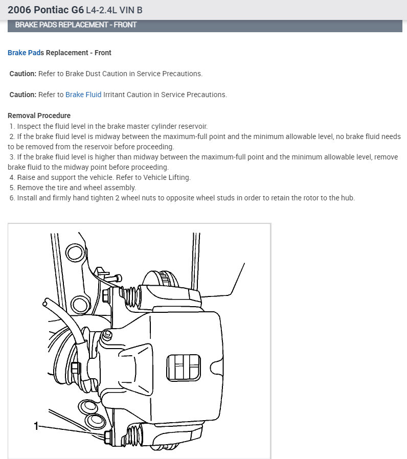

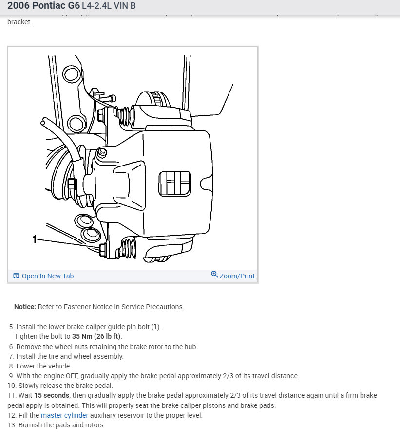

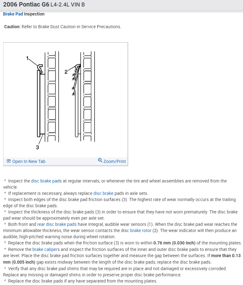

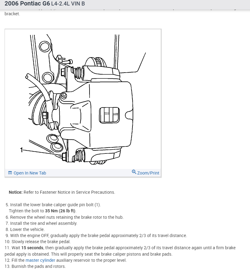

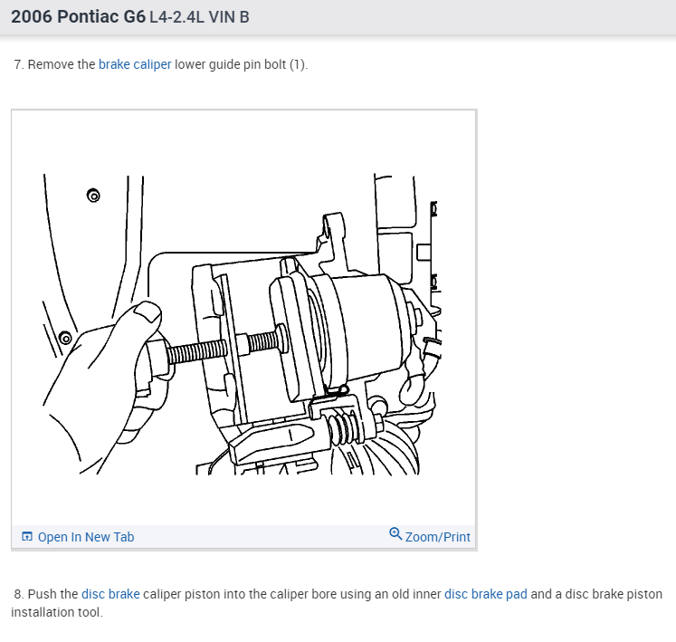

how to change brake pads on the front?
Jan 31, 2009 at 11:35 AM
SQM
  • 6,383 POSTS
The brake pads can be replaced using basic hand tools and in a relatively short period of time, depending on your comfort level.
Here is a helpful article:
I have attached the brake pads replacement procedure below.
