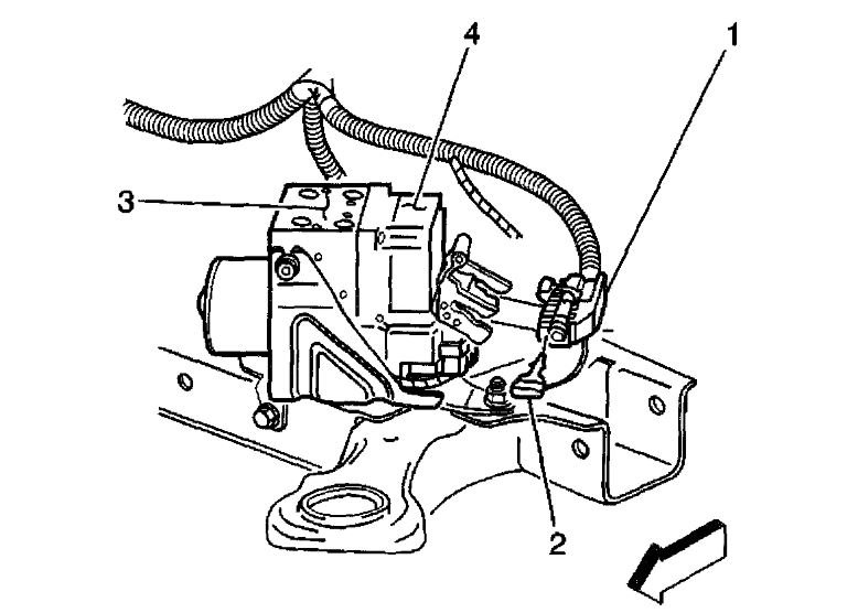

I'm trying to figure out exactly where the ABS modulator is located on a 2001 Cadillac Seville?
Feb 21, 2019 at 2:43 PM
Left front on the sub frame.

Gm.i locate the ABS module, traced the brake lines and found out it's the lines coming out the ABS unit that are leaking. Just wondering how to actually get to the ABS unit to remove lines/replace. is there some engine components I must remove to make it more accessibly? And will I still need scanner tool to bleed after the repair is done since its downstream from the ABS?
Feb 22, 2019 at 3:54 AM
You can get to them from under the car. You will need to lift the front end up for you to access the unit and the lines.
Yes, you need to do the automated procedure I posted back in the beginning.
