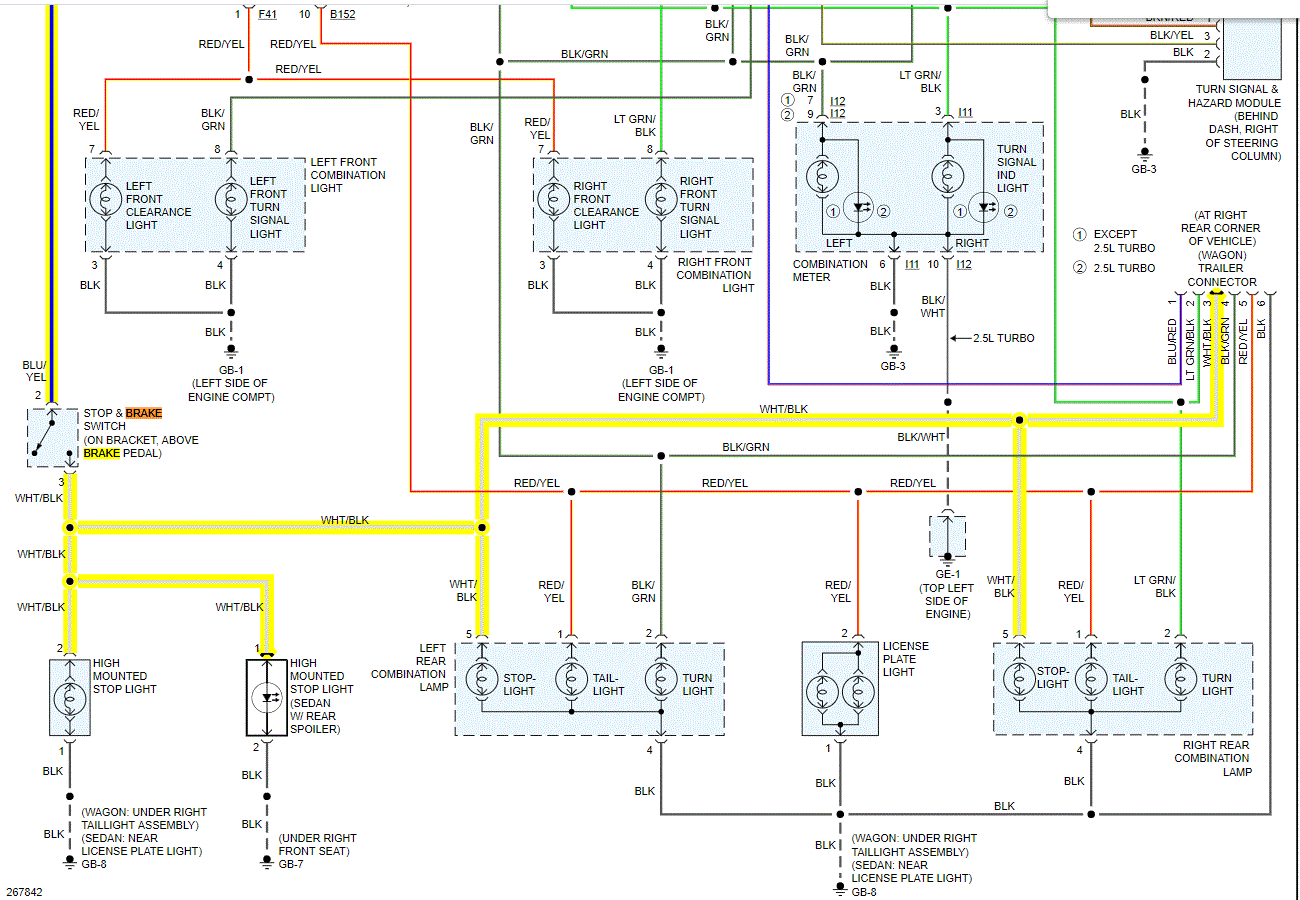

I am unable to get my brake light to go out. I replaced the brake light switch and they still sat on. I tested it prior to reinstalling, so i know it is not an adjustment issue.
How do I check for the issue? Voltage check? Do you have a wiring diagram?

If the light will not turn off, even with the brake light switch disconnected, chances are you have a short to power. Basically, power is being supplied to the brake lights via an unknown power source.
I attached the entire schematic below for the exterior lighting system. To help, I highlighted all the wiring related to the brake lights.

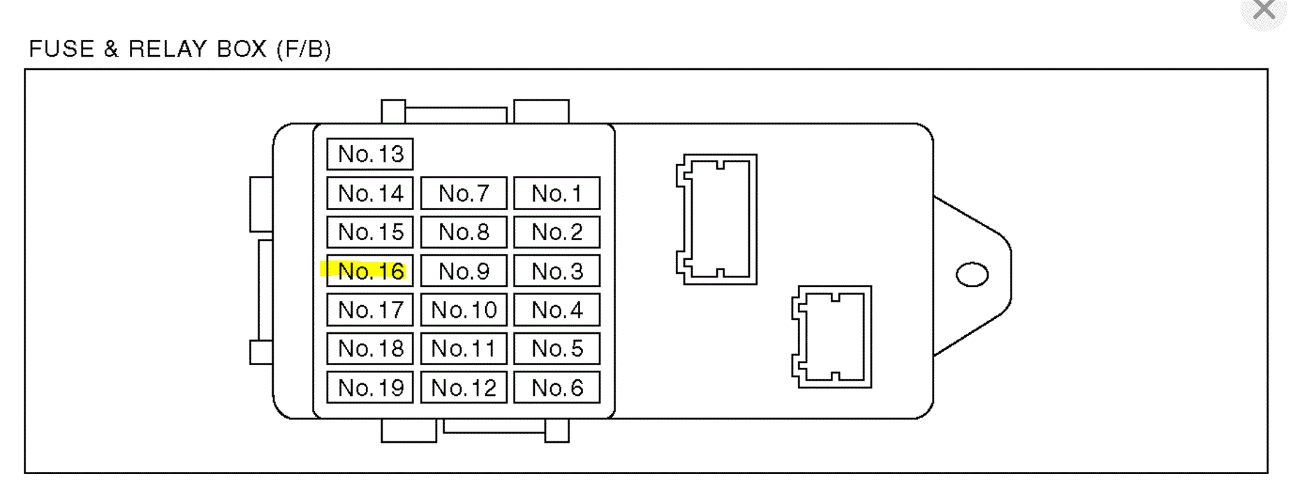

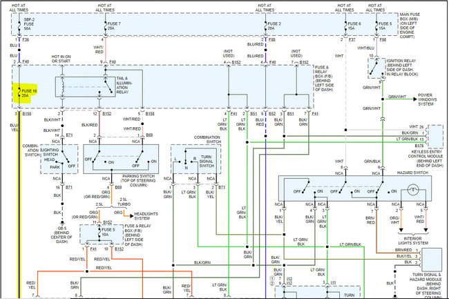

Here is what I suggest. If the lights are on, first remove the fuse for the brake lights. It is in the vehicle, left side under dash. See pic 3 below for location.
If the lights refuse to turn off with fuse 16 removed, then remove one fuse at a time near that fuse while a helper watches to see if the lights turn off. If they do, then we need to focus on the circuit of the affected fuse.
