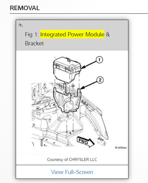

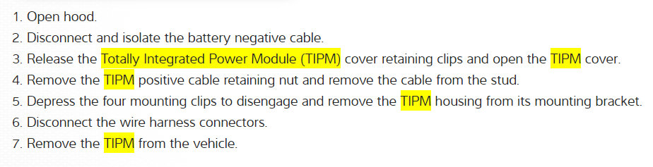

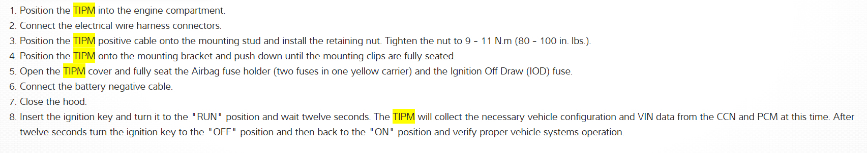

Attached are the instructions to replace the TIPM, these only work with a new unit though. There are places that rebuild them for less than new but you would be better off looking for those in your area.
