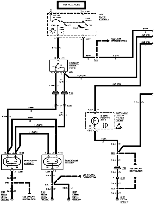

Inside the head light switch is a circuit breaker that where you get the flickering, you have a short from the headlamp switch to the head lamp dimmer switch (the dimmer is high and low switch), Follow the wire leading to the dimmer switch there is a short in there

I have a 2003 gmc sonoma with 59985 miles and the brake lights on the bed of the truck dont work. I have replaced all bulbs, fuses, and the switch on the brake pedal. The cab light comes on when the pedel is pushed. Everything else works what can I do and were should I start to fix this

If you have replaced these parts, you need to trace the wires. Is the check engine light on? If so it may have store a "B" for body code, if not on could be a wire...
https://www.2carpros.com/forum/automotive_pictures/62217_RearLamps_1.jpg
Might be damaged at trailer hitch area...
