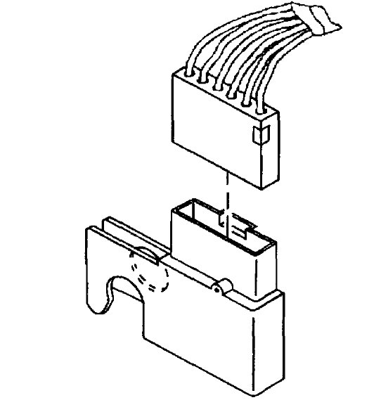

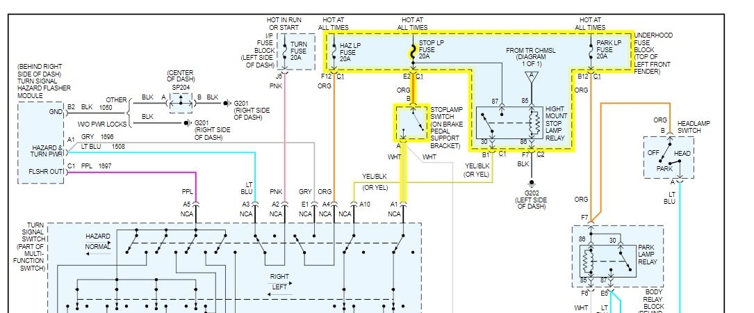

All three of my brake lights do not work. I have replaced the bulbs in the tail lights with no luck. Suggestions?
Dec 8, 2018 at 8:15 PM
Good morning,

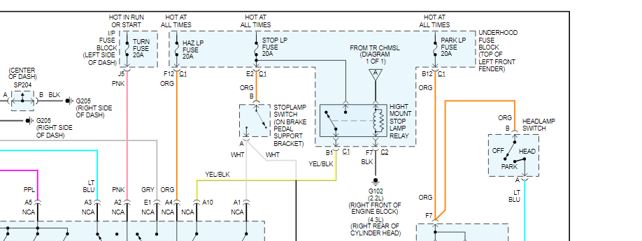

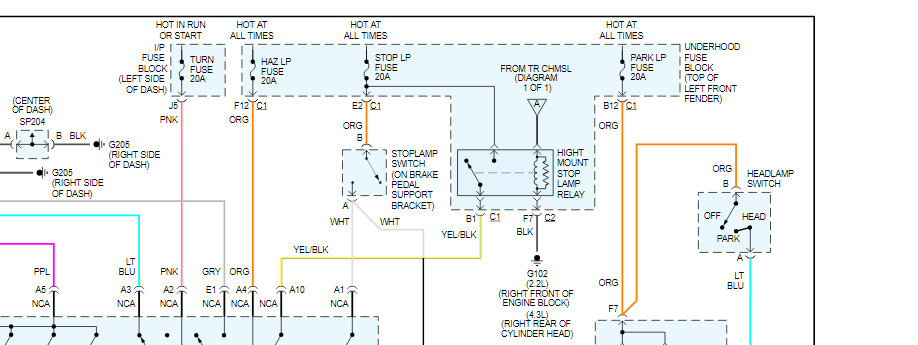

I would start by checking the fuse for the brake lights. I attached a wire diagram that identifies the fuse for all three lights. You will need a test light or voltmeter to test for power on both sides of the fuse.

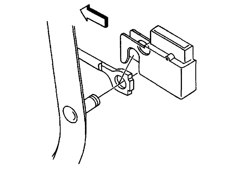

It could also be the brake light switch as well. You need to verify power to the switch .
Below are some pictures of the switch. You can get it at any parts store.
Dec 8, 2018 at 10:23 PM

Most likely you have a bad brake switch you need to have power going out when you step on pedal and when you release pedal there should be nothing. So you need to locate that switch it will be at top of brake pedal will have power in all the time and power out when brake pedal is pressed.
Dec 9, 2018 at 6:51 AM
Did you verify the powers as in the diagrams I sent you?
Make sure you have available power to the switch.

Good evening,

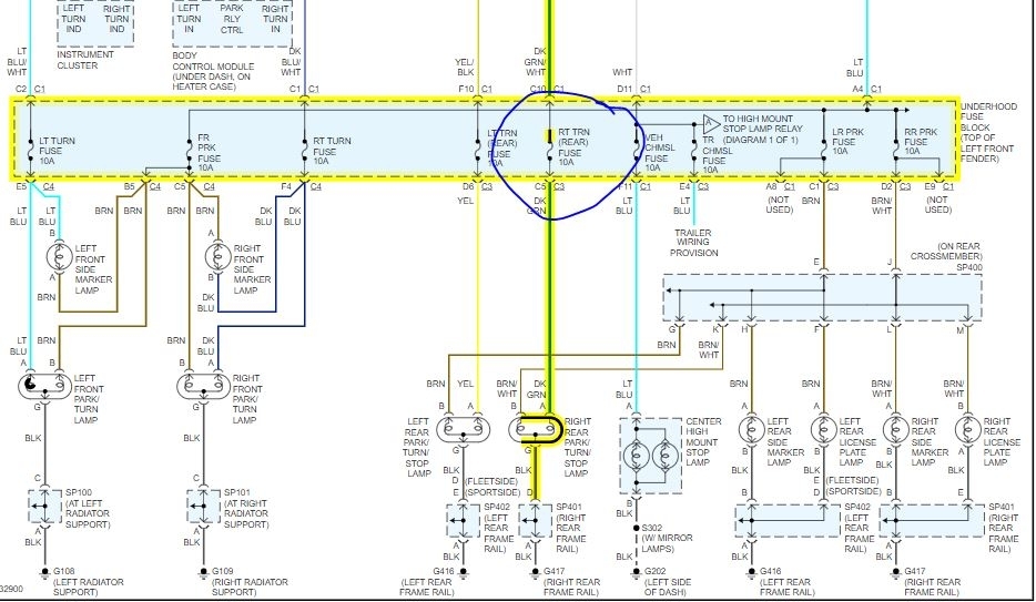

I attached a diagram for you. There is a separate fuse for the right rear brake light.
Test that fuse with a voltmeter or test light for power with the brake pedal pushed down. You will need 2 people for this test.

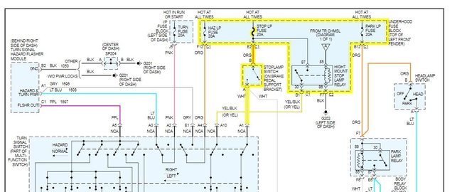

Good afternoon,
I attached a wiring diagram for you to view. You will need a test light to check for voltage to the stop light switch.

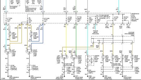

I have a 2000 sonoma that the break lights on the bed do not work but the break light on the cab does have check all fuses and traced the wireing from the back of the bed to the fuse block under the hood with no luck
Mar 10, 2021 at 10:47 AM (Merged)
BLUELIGHTNIN6
  • 16,542 POSTS
hello and thanks for donating
check the brake light switch, it is located under driver dash near brake pedal.
BULLDOG10
have already changed the break light switch did not fix it
BLUELIGHTNIN6
  • 16,542 POSTS
if fuses, wiring, bulbs and brake switch is good then suspect faulty turn signal switch. circuit shares signal with brake lights so signals may work but brake lights could fail separately. high mount brake light uses separate relay so it would not be effected..
BULLDOG10
the break light on the cab still works, can't find where the wiring is run for it may have to pull the bed to find it
BLUELIGHTNIN6
  • 16,542 POSTS

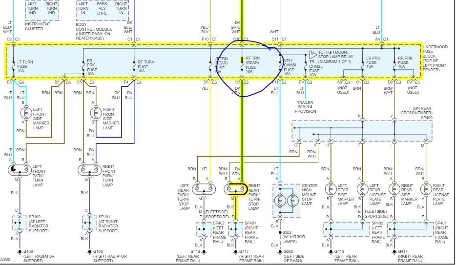

here is the wiring diagram of the exterior lights circuit to help you out, but i'm almost certain it's a faulty signal switch.

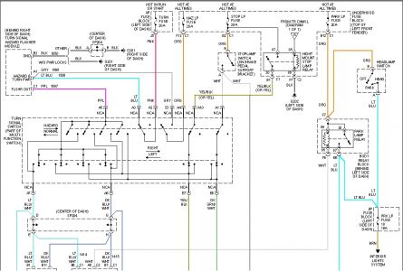

Brake lights,turn signal lights,emergency flashers quit working.Replaced signal flasher under dash,turn signals work.But emergency flashers or brake lights won't come on.
FACTORYJACK
  • 4,159 POSTS
Does the high mount brake lamp function?
DRIVER.606
No it doesn't , although I did replace the bulbs.
FACTORYJACK
  • 4,159 POSTS
If that is the case, check the STOP LP fuse in the underhood fuse box for being open. If it is good, check that power is at the fuse with a test light. If there is power there, you would need to go next to the stoplamp switch on the brake pedal assembly. There should be a total of three wires, an orange at pin A, and two whites at pin B. The orange is power from the fuse, check that there is power there. On the white wires, one goes to the turn signal switch, and the other goes to CHMSL(high mount) fuses and light. When you press on the pedal, the white wires should go hot. Theoretically, if the high mount is not working, I would suspect this switch to be bad, but that does not explain the hazard lights not operating. If you can verify the STOP LPS fuse, and power at and through the switch, You may have a turn signal switch that is faulty.

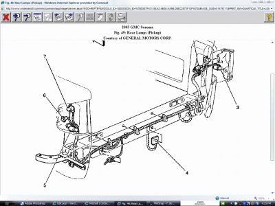

i have a 2003 gmc sonoma with 59985 miles and the brake lights on the bed of the truck dont work. i have replaced all bulbs, fuses, and the switch on the brake pedal. the cab light comes on when the pedel is pushed. everything else works what can i do and were should i start to fix this
Mar 10, 2021 at 10:48 AM (Merged)
MERLIN2021
  • 17,250 POSTS
If you have replaced these parts, you need to trace the wires. Is the check engine light on? If so it may have store a "B" for body code, if not on could be a wire...
https://images.2carpros.com/forum/automotive_pictures/62217_RearLamps_1.jpg
Might be damaged at trailer hitch area...
