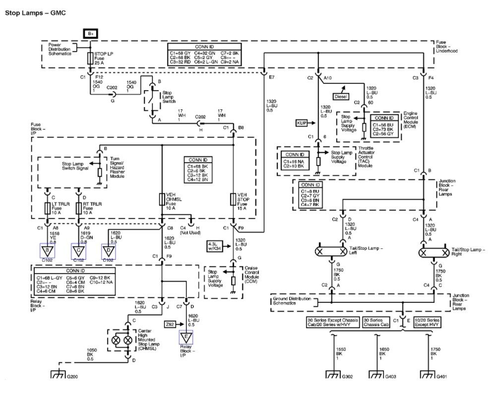

Also, the cruise control stopped working. I replaced the brake switch and it didn't help.

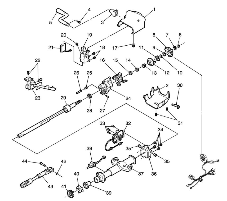

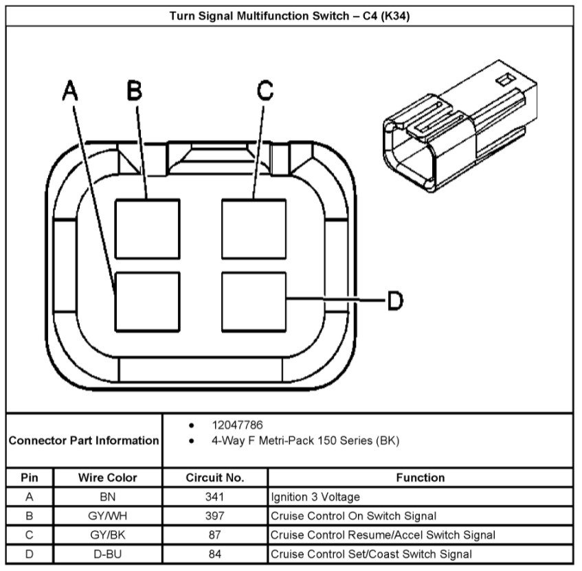

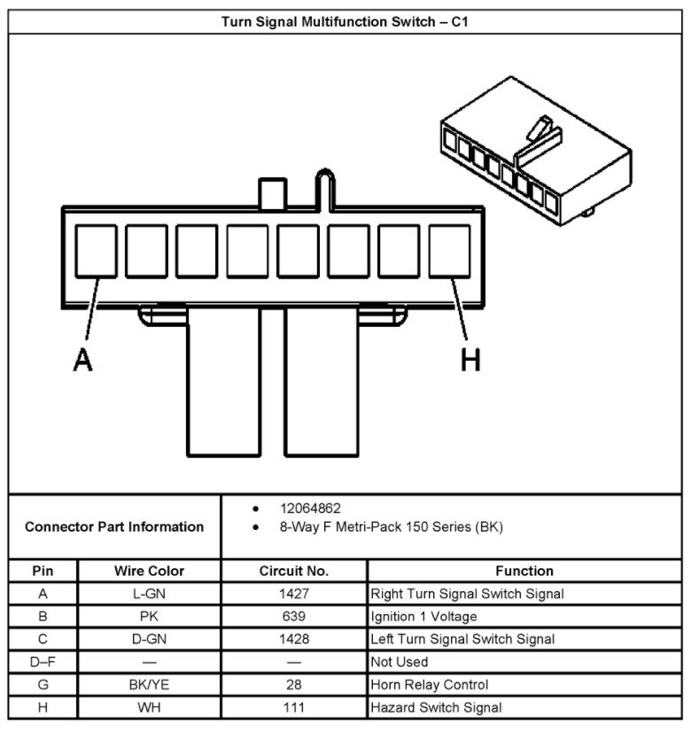

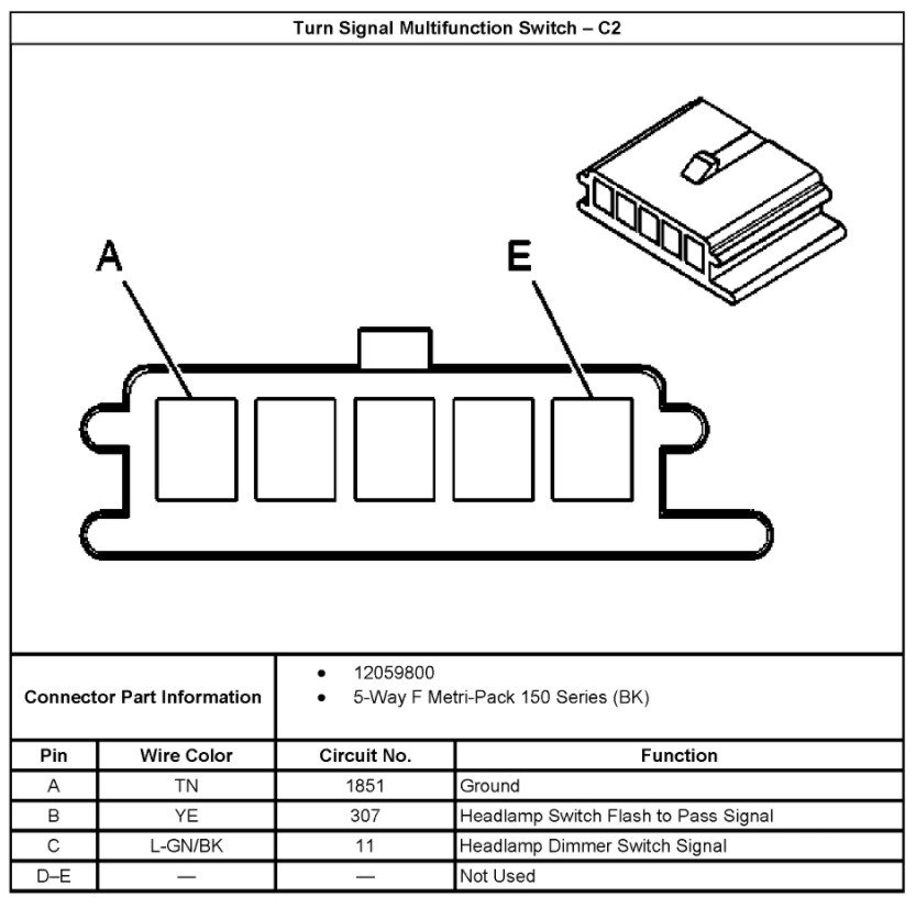

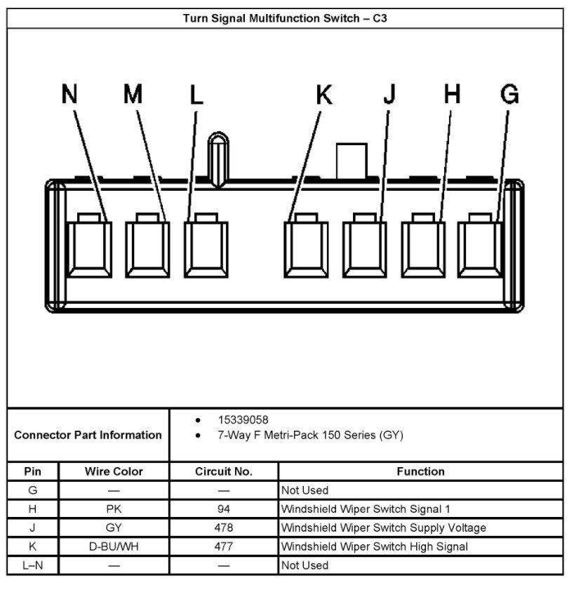

It sounds like there could be a fault in the turn signal multifunction switch which could be passing voltage through from the brake light switch to the stop lamps, even without the brake pedal being pressed. This could also interfere with cruise control operations. I've attached the stop lamp schematic for your reference.
This multifunction switch is located in the steering column and is labeled #23 in the component diagram. Please check out the diagrams (below).

JRAY1979
Thank you for your reply. It wasn't that, but I was finally able to track it to a faulty trailer brake box. Thank you for your reply and your help.
