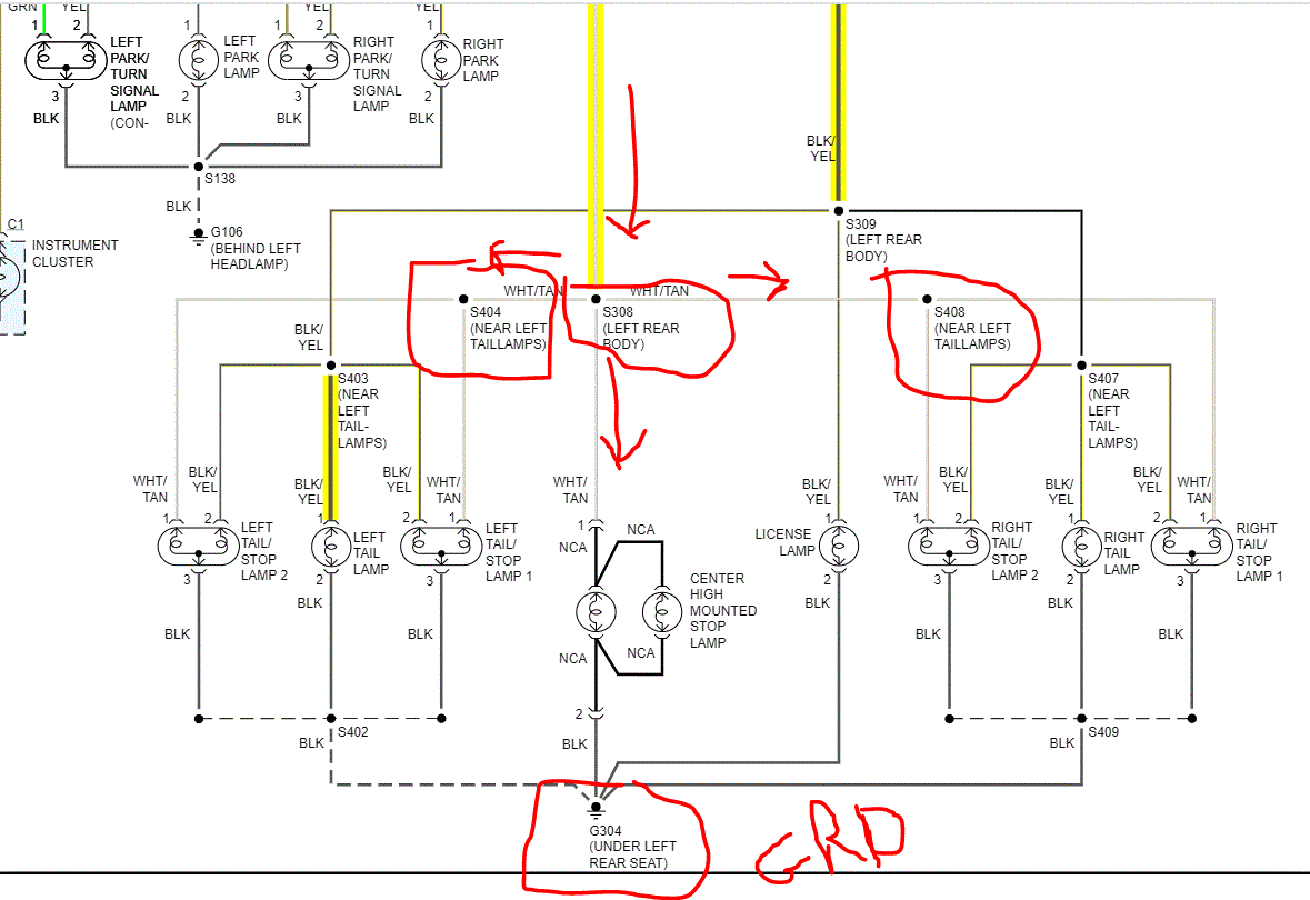

Just replaced master brake cylinder and just replaced brake booster.
Now, just the third brake light works.
Lower brake light bulbs are good and fuses good.
Also, i reset brake light switch.
Still, only third brake light is only one that works.
Turn signals work.
Backup lights work.
Hazard lights work.
Could this just be bad brake light switch or possibly multi function switch?

If the third brake light is working and the bulbs are good, you need to check a couple things. If you look at the schematic I attached, you will see the brake light wiring. I have arrows showing where the power comes from and where it is going. Note that the third brake light gets power from the same wire as the tail lights, so if they aren't working, either you have a bad splice in the wiring (which I circled their locations), or a bad ground for the side lights.
Here is what I need you to do. Note the power supply for all brake lights is a white wire with a tan tracer. I need you to locate that wire on each side and check if there is power to it. If this happened all at once, I suspect the first splice is the issue or the ground. But we need to check for power at the lights and work backwards to see if we can determine where power is lost.
Additionally, if you find when using a test light or volt meter there is power, you will have supplied a new ground. In this case, check the black wire for continuity to ground.
Sorry about the sloppy writing on the schematic GRD is the ground. I can't write with a mouse pad. LOL

Thanks! I will test tomorrow with Volt/Ohm meter and let you know!

You are very welcome. Let me know what you find. Also, does my reasoning make sense to you? If the third works, there has to be a break down between the two where they splice or where they ground.

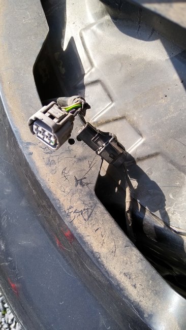

Hi, found 11.5v at white/tan.
Grounded to a bolt.
High winds today! Pic of left side.
Apr 10, 2020 at 2:18 PM

11.5v at both white/tan.

Is that when you provide the ground via your test light or multi meter? If it is, did you check for continuity to ground via the black wires? If you have a good ground, then the problem will be the socket itself. If there is no ground, then we need to check that.
