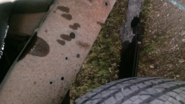

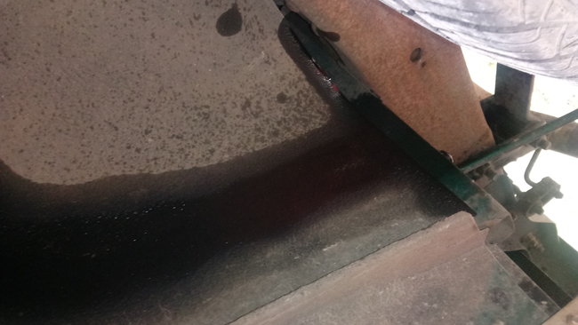

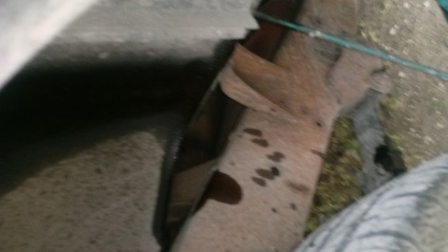

Checked oil level it was low. Filled light still on. Inspected for leaks, noticed rear passenger side indicated a leak. What component needs replacement?

I appreciate the photos, but I can't tell what is leaking. If it's near the right rear wheel, it is going to be the wheel cylinder or the steel line going to it. That line sits on top of the axle housing. If the line has rusted through, you will see brake fluid spurt out when a helper pushes the brake pedal. The fluid will run to the bottom of the housing, then onto the ground.
If the wheel cylinder is leaking, the brake drum and backing plate will be wet, as well as the inside of the tire. If that leak is bad enough, fluid will spray from the spinning brake drum onto the inner wheel well. You probably will not see additional fluid running out when your helper pushes the brake pedal. It takes a little while for it to run down that far.
Regardless of the cause, the red "Brake" warning light will turn on due to unequal pressures in the two halves of the hydraulic system. That light will turn off once the leak is repaired, . . . unless the master cylinder has been damaged. On any master cylinder that is more than about a year old, crud and corrosion build up in the bores where the pistons don't normally travel. When you push the brake pedal all the way to the floor, either when surprised by a leak or during improper bleeding procedures, the pistons are run over that crud and it can rip the rubber lip seals. That will cause a slowly-sinking brake pedal, and that often doesn't show up for two or three days. If it looks like the master cylinder is still okay, just use gravity-bleeding after the leak has been repaired. If you resort to pedal-bleeding with a helper, be sure to stress they never push the brake pedal over halfway to the floor.
