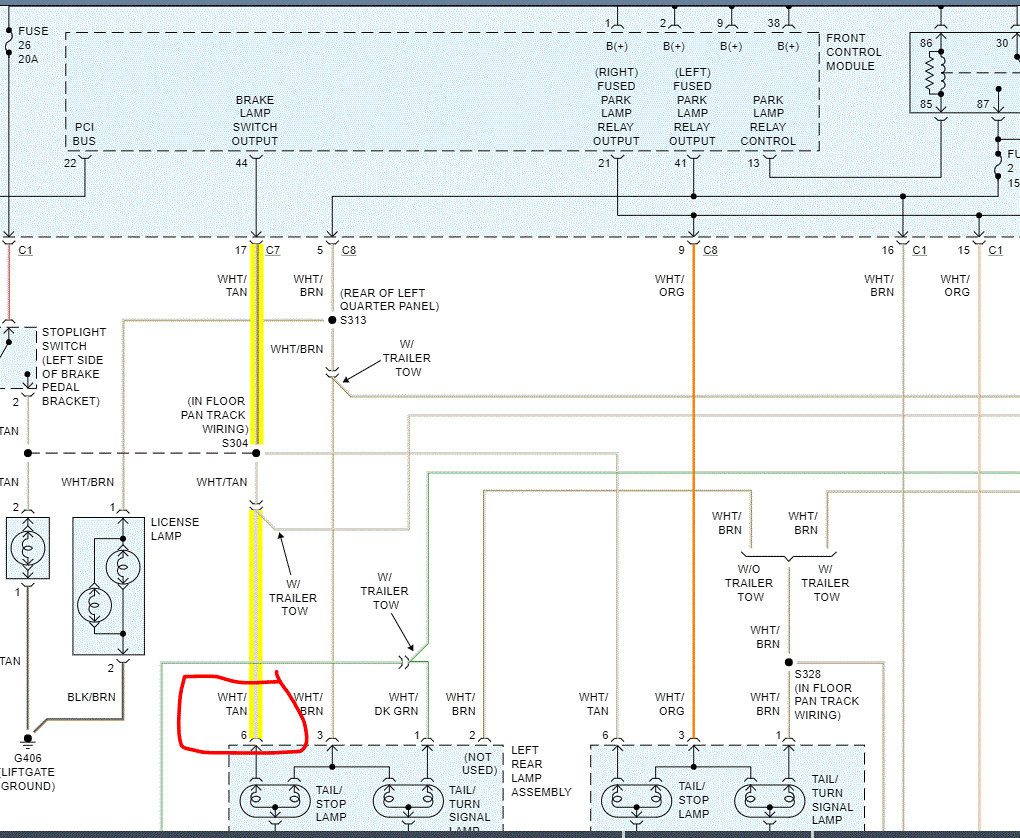

I replaced the bulb, all the other lights work fine, turn signal running lights flashers. No impacts at all, just stopped one day and can't find any continuity issues in wiring harness for light assembly, but not totally sure because I can't find a clear wiring diagram.

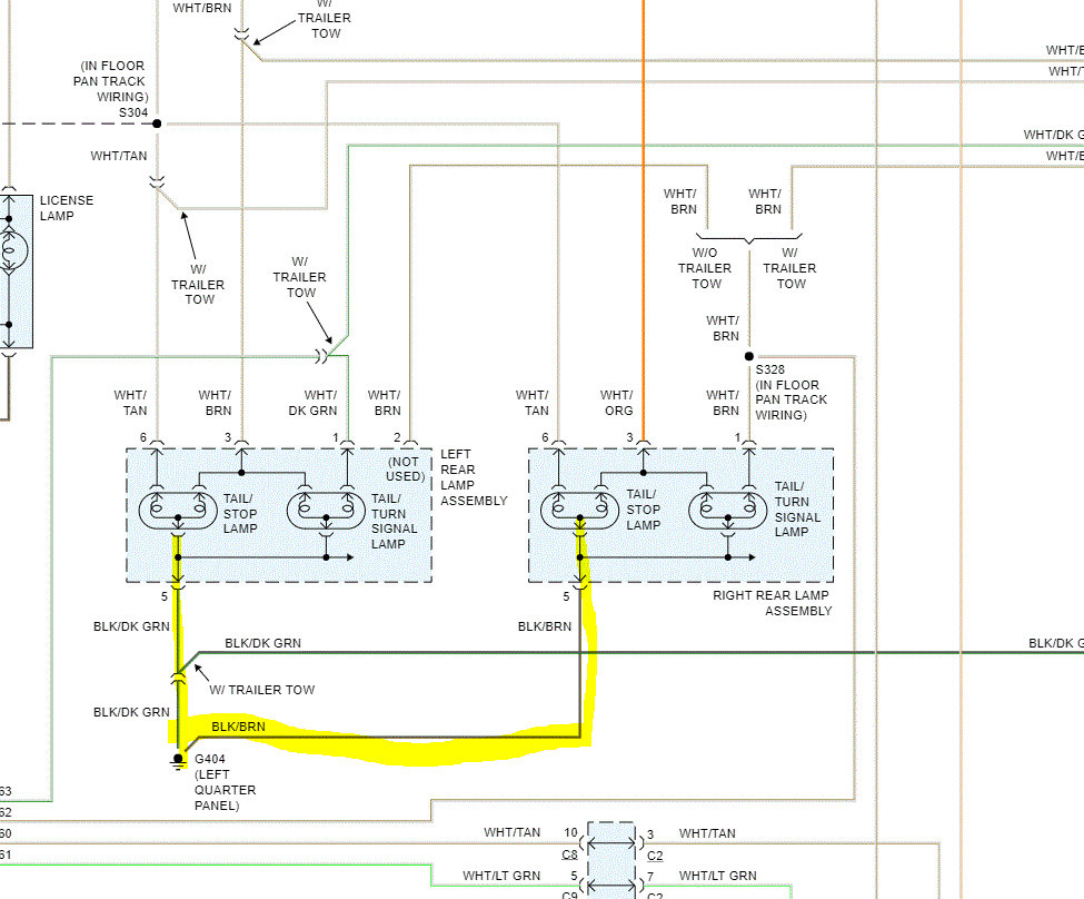

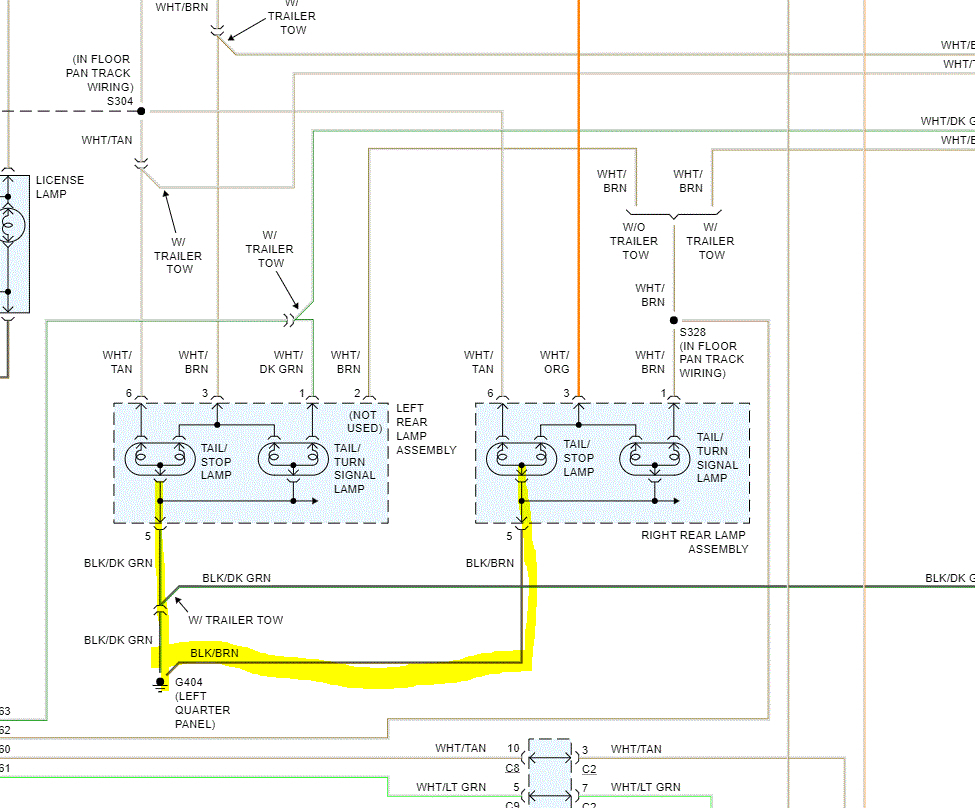

I'm looking through the wiring schematic. It can't be a ground issue because all rear lights share a common ground. None of them would work if that was the issue. (see pic 1)

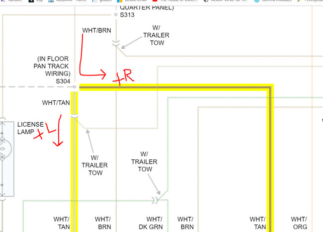

Next, have you checked to see if there is power to the light socket when the brake pedal is depressed? There is a white / tan wire that is the power supply to the left rear brake light direct from the brake light switch. Confirm if there is power to that wire. (see pic 2)

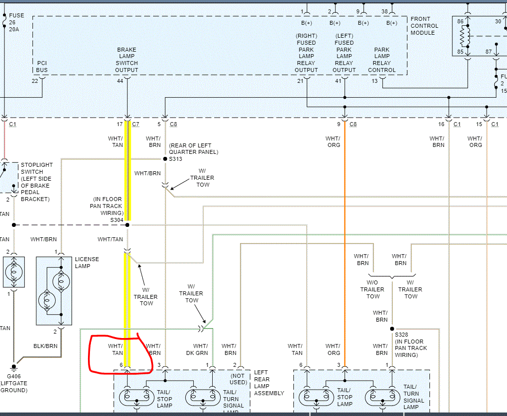

If there is no power and the right brake light and center mounted brake light work, chances are there is an issue at the wire splice (S304). See pic 3 In the picture, I have an arrow and letter indicating power flow to the left and the right. Power could be lost at that splice, or if you have a factory trailer tow package, it could be the second junction to the left light right below the splice.
The first thing I would do is simply confirm there is or isn't power to the light socket. If there is power, replace the socket. If there is no power, then there is an open (break) between the splice and light. At that point you will need to trace the indicated wire back until you find where power is lost.
