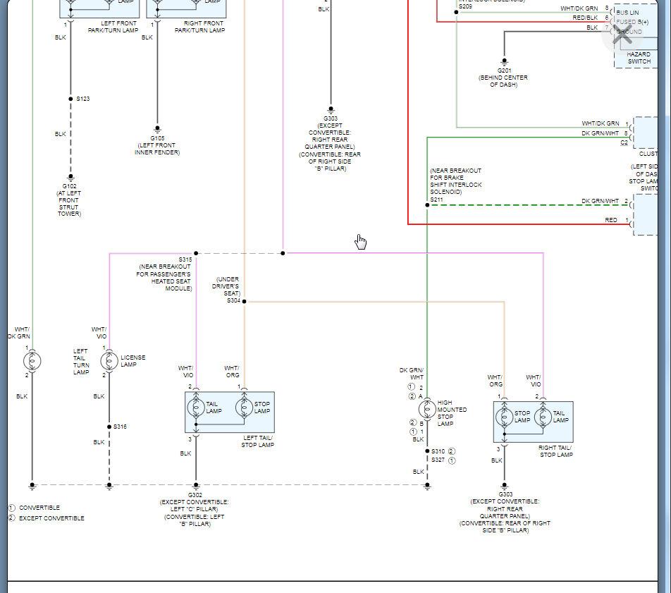

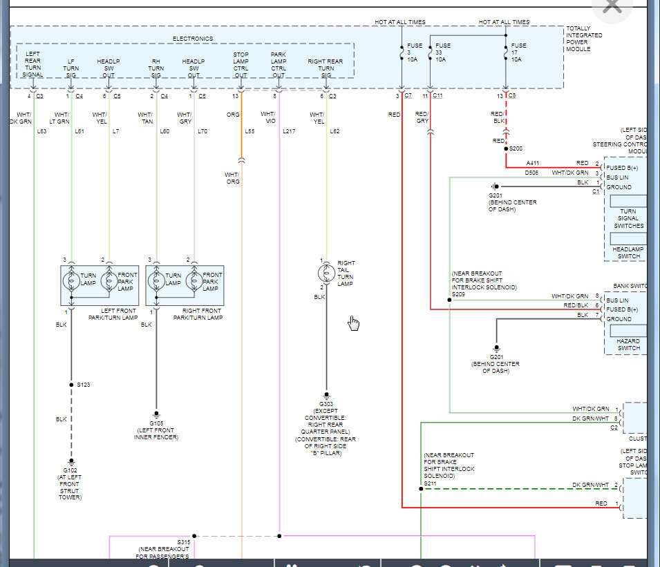

Below is the wiring diagram from the manual that will show the detail that we need in order to test these circuits. We need to check power at the bulbs and go backwards from there in order to find out what the issue is.
I suspect this is a TIPM issue as it is not uncommon for it to cause these types of issues.

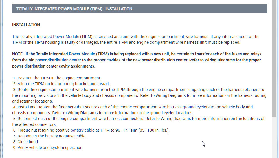

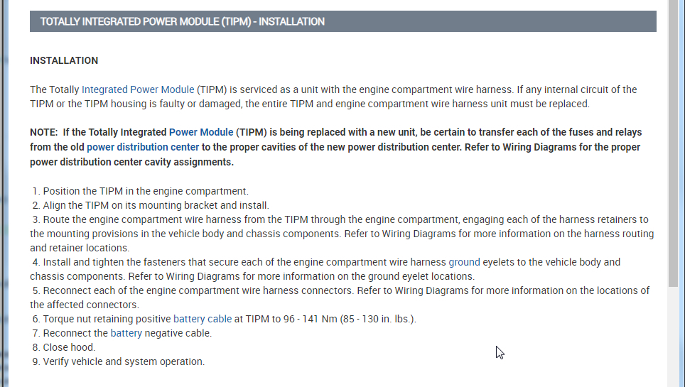

I attached the process to replace the TIPM as well. Please let us know what you find with this. Thanks
