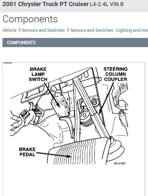

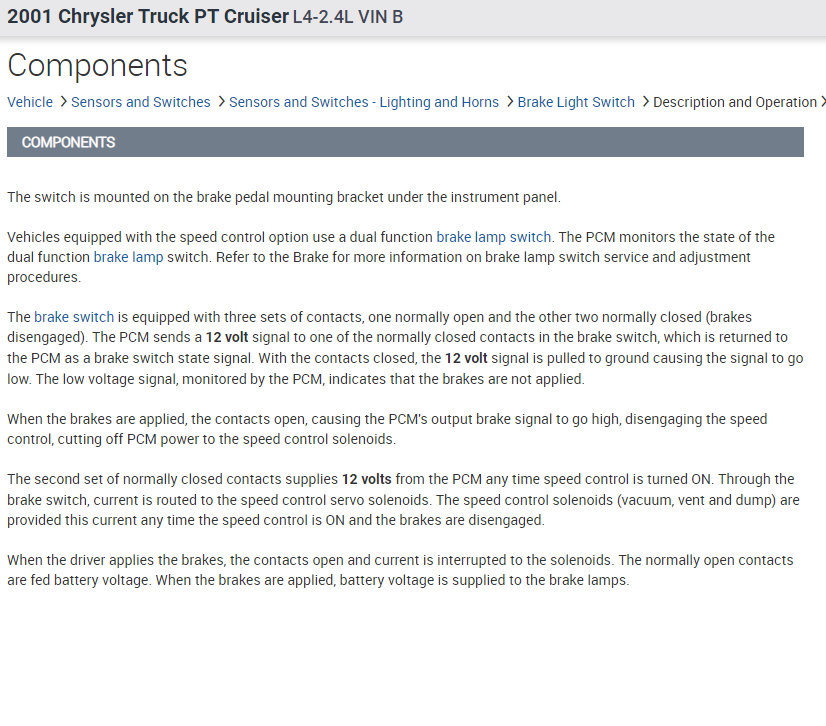

brake lights will not work. bulbs have been checked. interior fuses and fuses under the hood have been checked.
May 2, 2009 at 4:44 PM
SQM
  • 6,383 POSTS

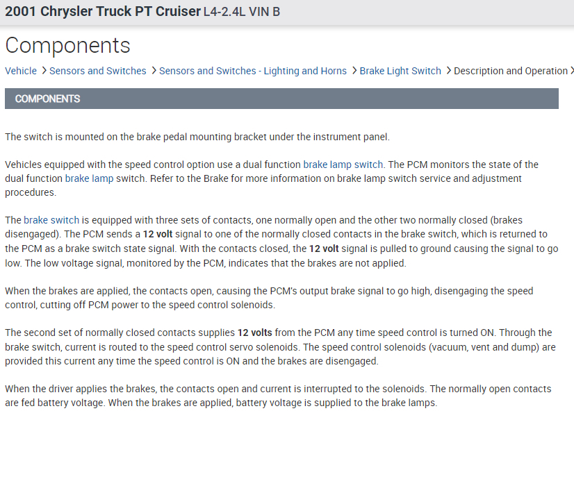

If none of the brake lights will illuminate and you have already verified the fuse are good. The next item to check is the brake light switch. It is a switch that goes under you brake pedal. When you depress the brake pedal, the switch gets pressed and make the brake lights come on.
You might find this article helpful:
https://www.2carpros.com/articles/brake-lights-not-working
https://youtu.be/RBCDVfzNQGk

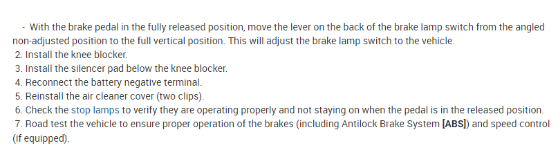

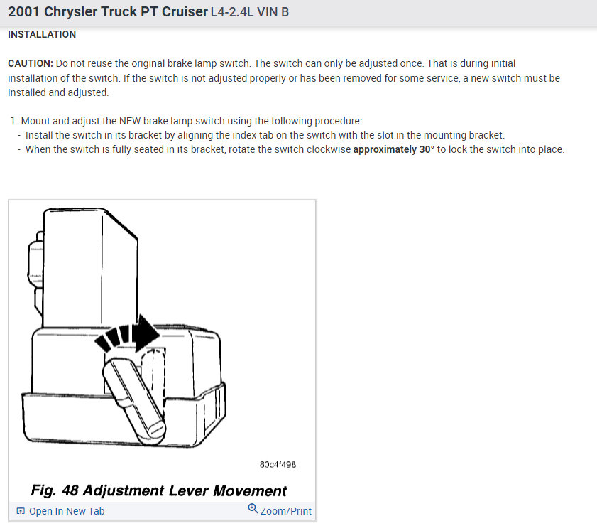

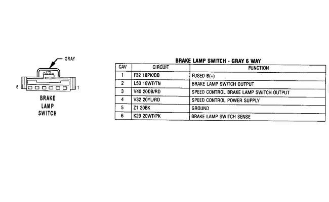

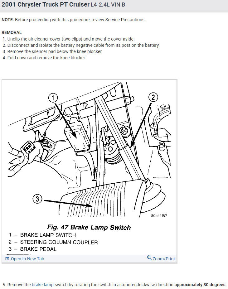

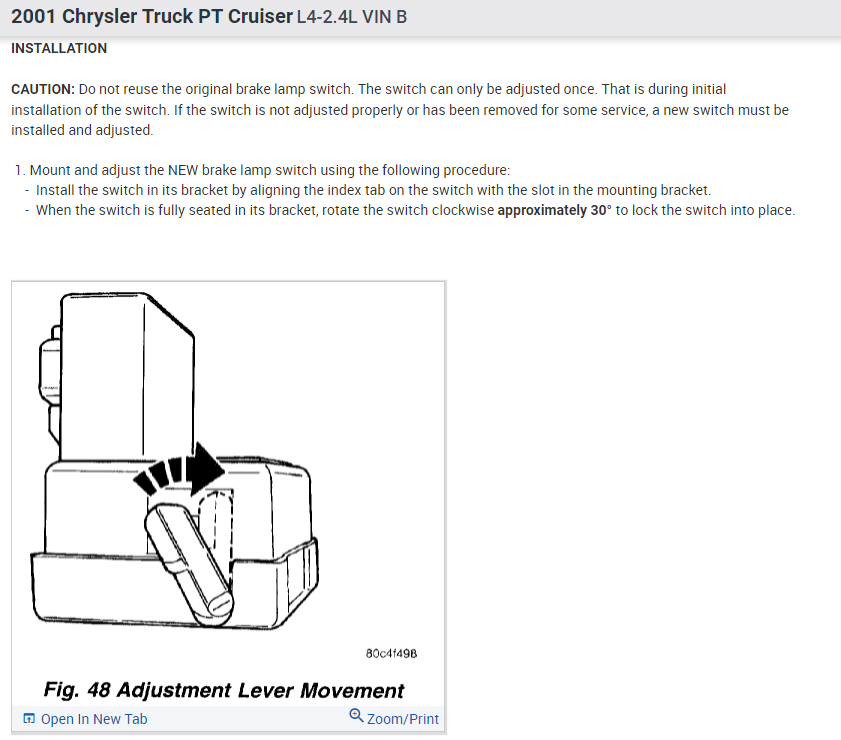

I have also attached the brake light switch replacement procedure for your vehicle.
