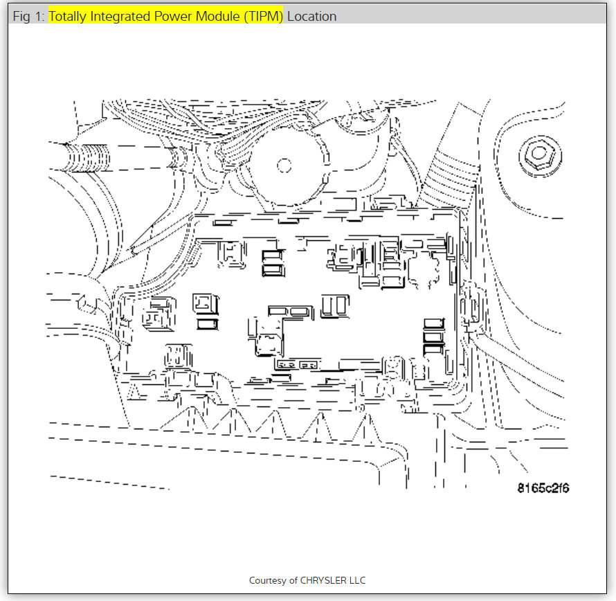

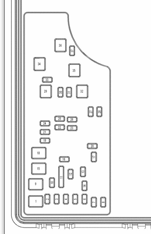

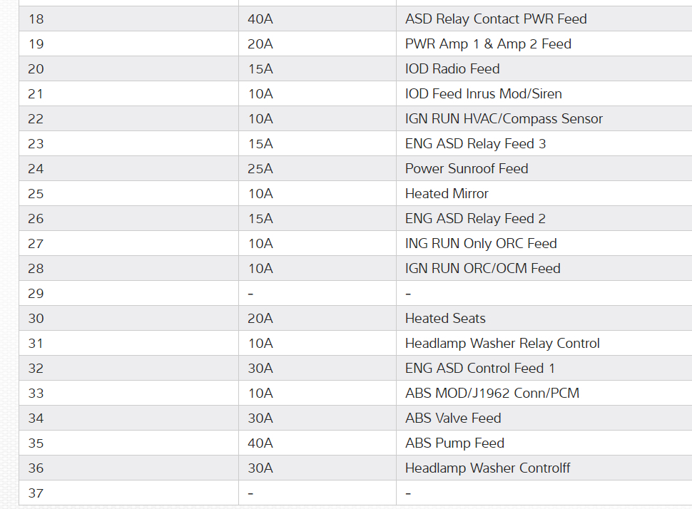

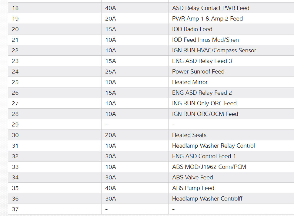

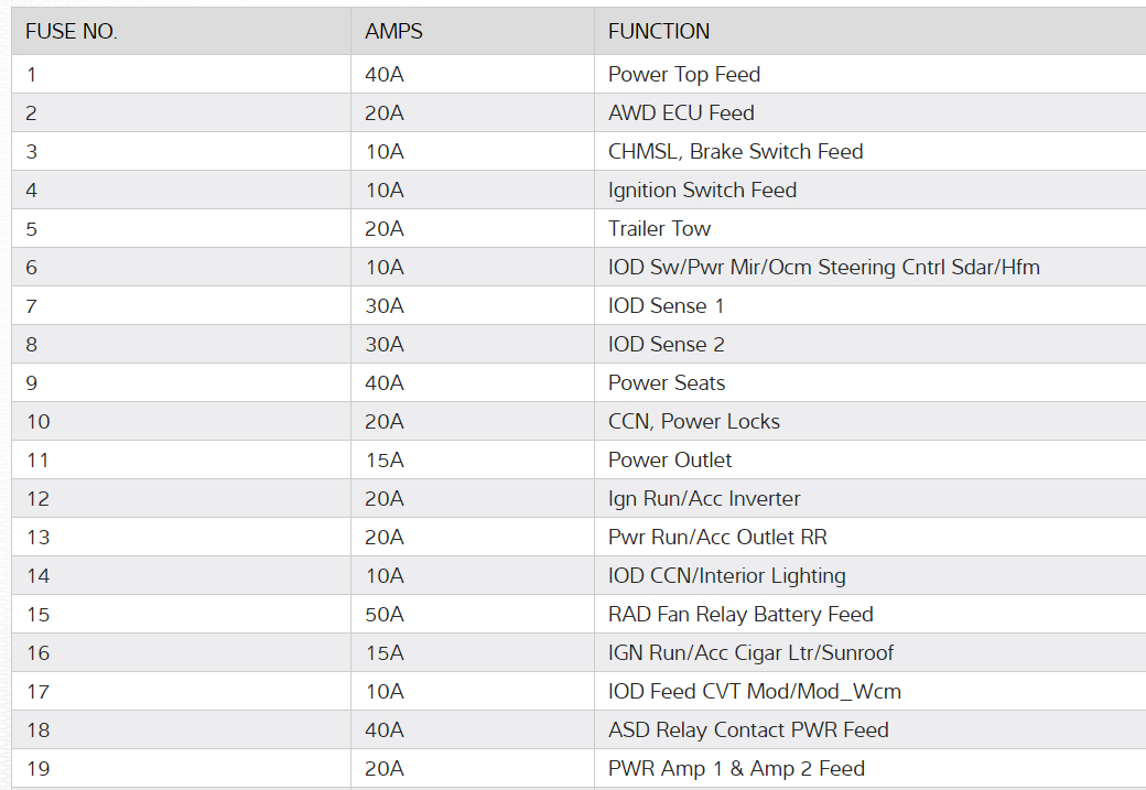

It sounds like you may have a fuse out here is a guide to help you check

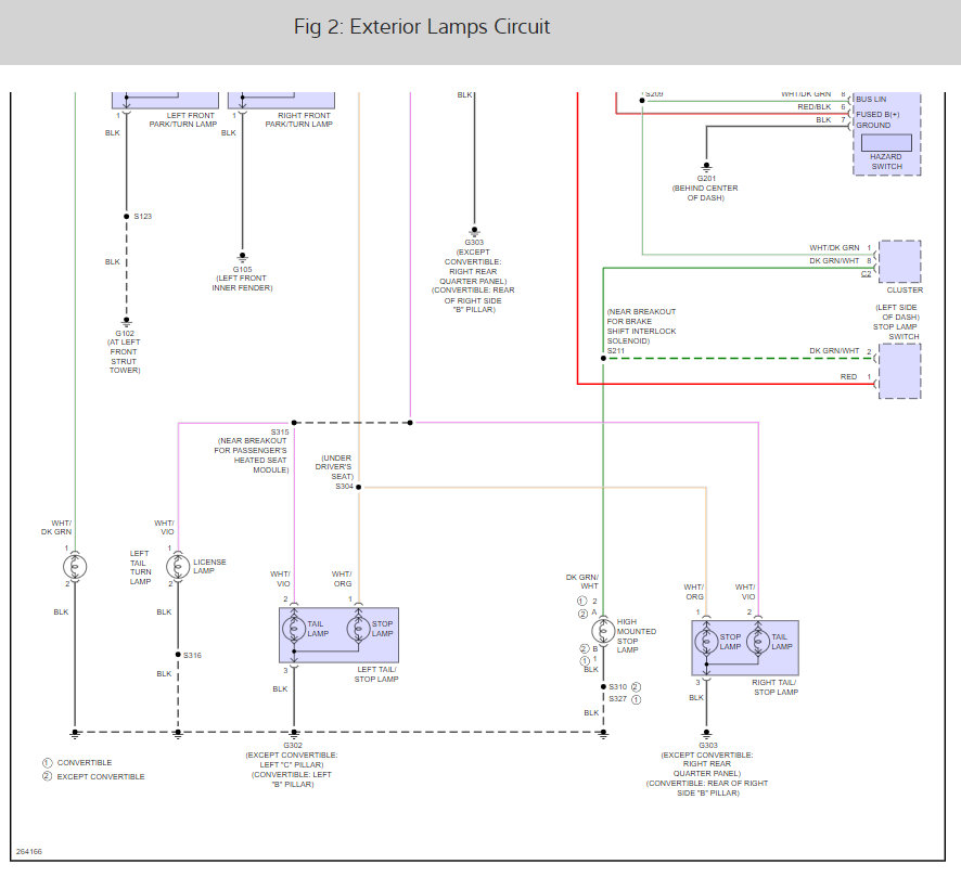

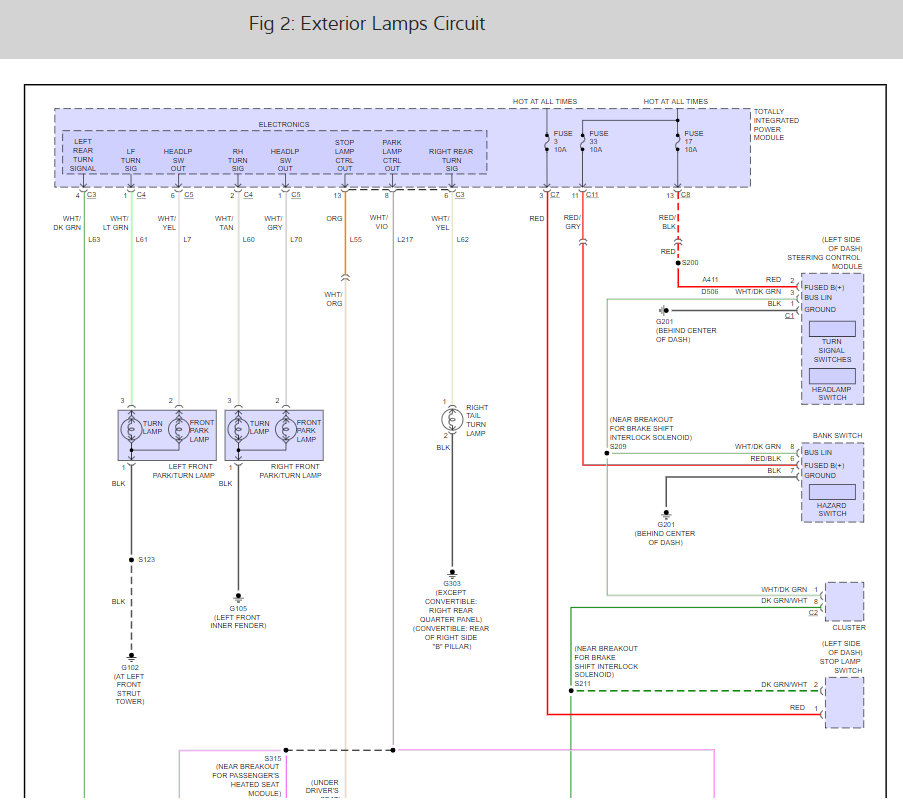

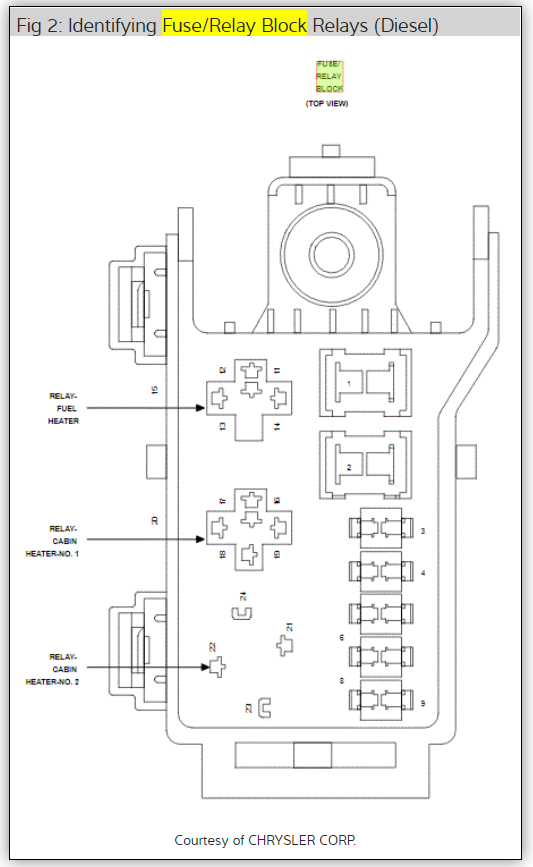

Here is a wiring diagrams so you can see how the system works. If the fuses are okay check the system grounds I have seen the TIPM go bad which will also cause the issue.
Please run down these guides and diagrams and report back
