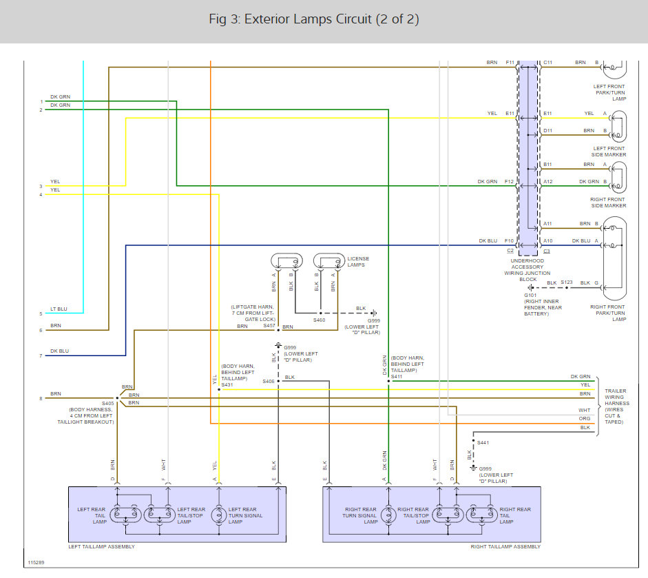

NATGRACEAB
brake lights wont work even when I change them
Sep 30, 2020 at 8:59 AM (Merged)
FREEMBA
  • 1,152 POSTS
Remove the taillight assemblies.
Unplug the wire connector going to them and inspect both the connector and the tail light where the connector plugs in.
These ventures have, what the manufacturers call "circuit boards" that the bulb plugs in to.
The circuit boards often burn out at the connector and then you have no lights or lights on at all times or some other crazy problem (I have a Venture and have experienced this twice).
If the connectors are burned, replace the circuit boards and buy a wiring harness (pigtail) for the tail lights. You may find then at most auto parts stores, but even the dealer price isn't too bad. Rewire the tail light and then you're good (for a while).

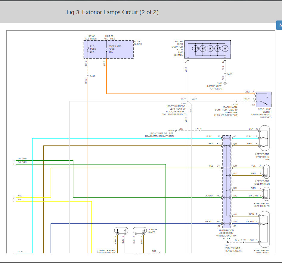

The upper brake light ( in the rear hatch) works, and the bulbs are all good. The running lights (same bulb as the stoplights) work, but no brake lights. fuses are all good, bulbs are all good. what could this be? since the hatch stoplght works, it can't be the switch under the pedal. what can i check next? i'm at a loss.
  • 75,992 POSTS
It sounds like a connection problem at both brake lights because if the center light works then the others should work as well because they are wired together. You may have a broken wire somewhere here is a guide to check for power and the brake light wiring diagrams so you can see how the system works.
Cheers
SHELLYBELLYMATT
I found it! it was a broken wire in harness where it got rubbed through. Once I fixed it the problem is solved! thanks for the brake light wiring diagram it really helped.
I love this site, all for free I cant believe it.
