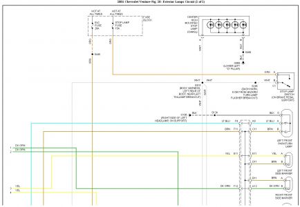

About 2 months ago my wife said that when she pressed on the brakes that the turn signal indicators on the dash came on and when she tried to use the right turn signal it flashed like it was burned out. I replaced the bulb but it still did it. I checked voltage at the bulb and everything was ok. Then it went away. She mentioned that it did it a couple of times since then, but when I went to drive her van today. I turned the lights on and the turn signal indicators came on immediately and now neither blinker, tail light or brake lights work only the middle brake light in the back window will work. If you press on the brake with the car off, the same thing happens.I checked the plugs that read the brake pedal is actuated and they seem ok and the wiring going into both tail lights looks good, does anybody have suggestions or at least an idea of where to start looking?

Two areas I would focus on would be if any aftermarket wiring was adding for towing, if okay, then check the multifunction switch. Sometimes just playing with the switch can cause a change in symptoms.

thank you for your quick response. I don't have any towing wiring and I just got done replacing the multifunction switch. Still no go. The brake lights do now work but if I have the lights on, press on the break, and have the left side blinker going it doesn't work properly/ The brake light and the blinker dim out and alternately flash. I am assuming I have a short somewhere.

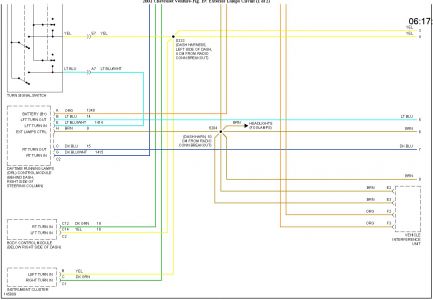

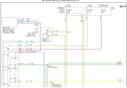

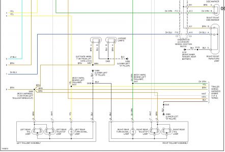

https://images.2carpros.com/forum/automotive_pictures/30961_v1_1.jpg

Thank you very much for the wiring diagrams. They will be very helpful. I did find a corroded probe on the top of the drivers side lighting assembly. I swapped the two tail light assemblies around to see if the problem would move to the passenger side and when I did it the lights worked fine. I moved the drivers side assembly back to it's normal side and the problem came back. I ran to the local salvage yard and got a new one and put it in and so far so good. Hopefully that is all it was. FYI for anybody interested. The multifunction assembly and switch (the turn signal switch) cost almost 300 dollars from a dealer (apparently an auto parts store cannot order one) so if you can find one they are rather common at salvage yards because the same assembly is used on all Ventures from 95' to 05'. With removal it only cost me $60. I also got a whole tail light assembly for $30 instead of the $80 that the dealership wanted to charge me. Once again, thank you for all of your help.
