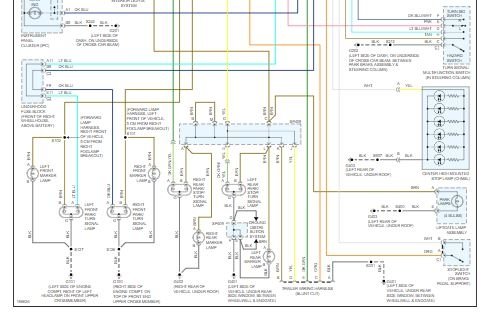

My back right rear brake light and turn signal isn't working, however my tail lights are. What could the problem be? I replaced the bulbs and checked the fuses and they're good. All lights on my left side work front and back and also front right turn signal works.
Dec 7, 2019 at 4:44 PM
MOTOR MASTER
  • 279 POSTS
Hello my name is Dave.

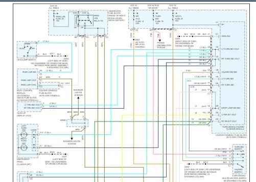

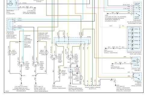

It sounds to me like the most likely culprit would be the turn signal/hazard module, it is located in the floor console. I have attached a diagram of the exterior light wiring for your car. I am also including a link to our tutorials for both using a volt meter and how to test wiring.
I would test for power on the circuit going to the right taillight when the brakes are applied and if you have power then I would test the circuits between the module and the lights, if you don't have power then your module is the culprit and will need to be replaced. Please keep us up to date on your progress and than you for using 2CarPros!
Dec 8, 2019 at 8:38 PM
BLANCAM
The end that holds the plug was corroded and not getting a good connection. Cleaned it and now works.
