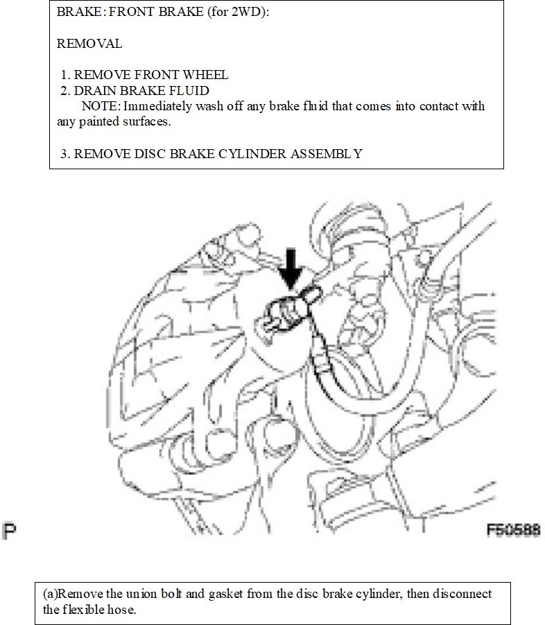

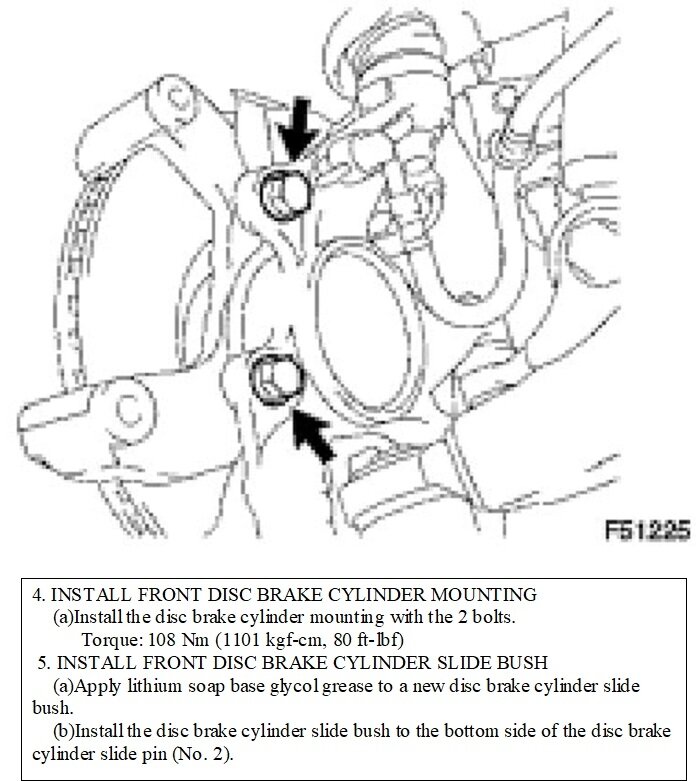

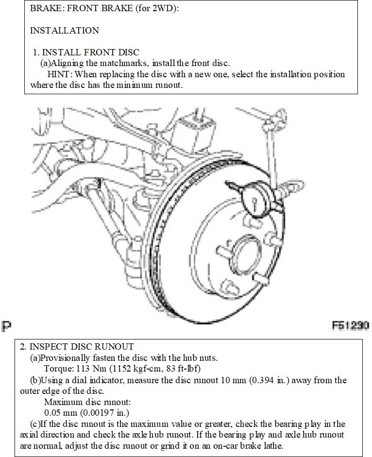

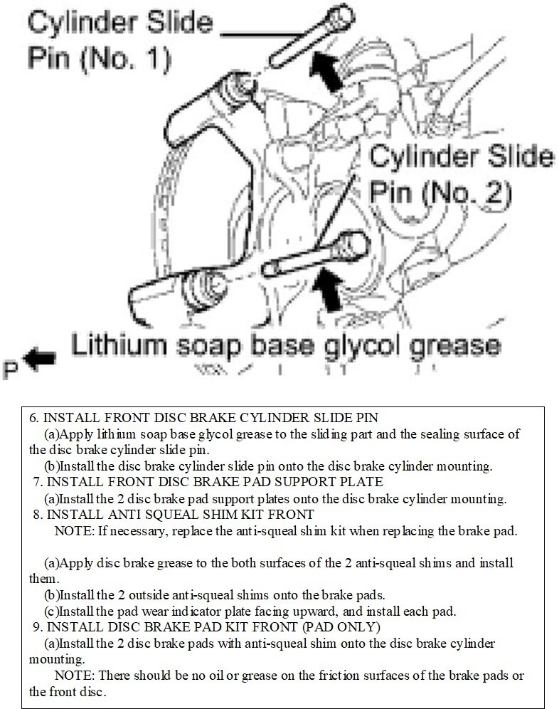

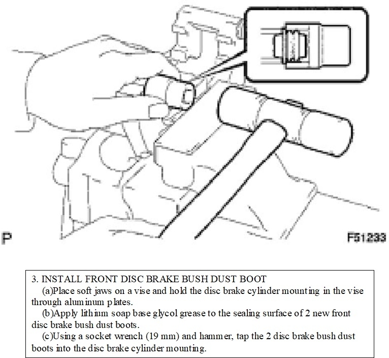

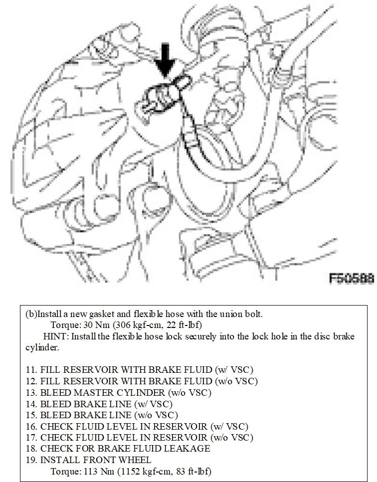

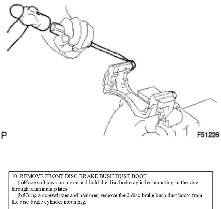

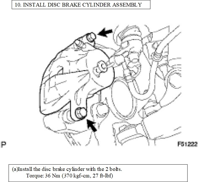

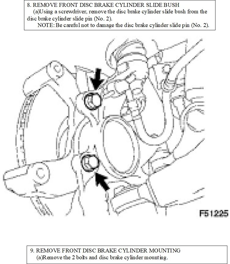

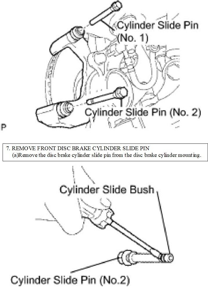

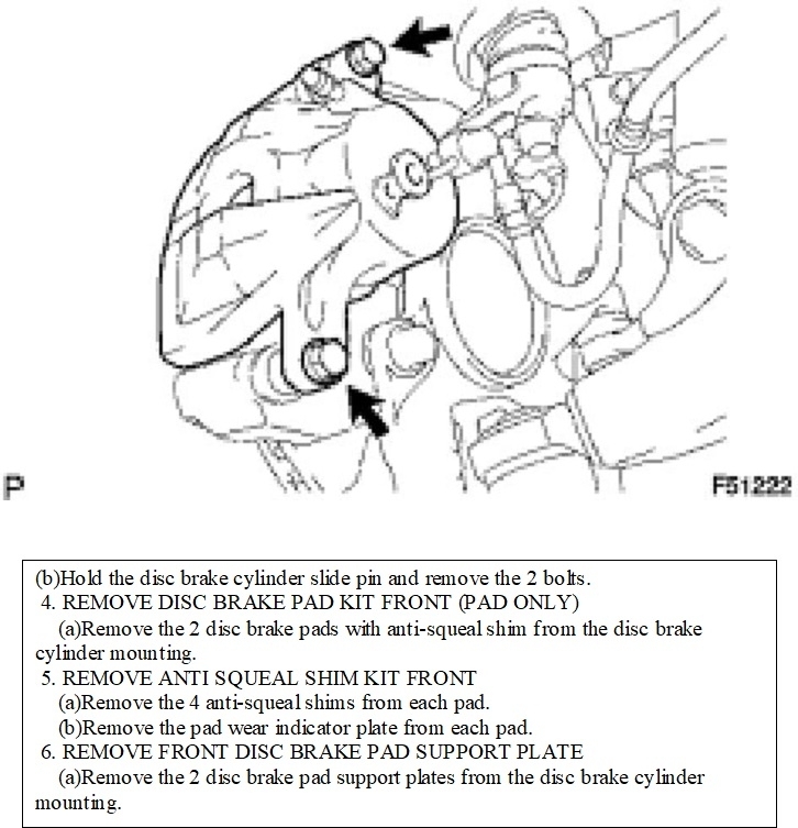

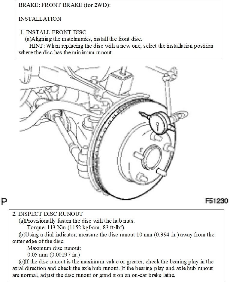

This is where slapping in a new set of pads differs a lot from a professional brake job. New pads can get you back on the road, and usually will not compromise safety, but it can impact customer satisfaction. First let me post the instructions from Toyota for the 2wd model. Read through that all the way first because there's a lot of information that is confusing. I'll elaborate on that next.
Right off the bat, skip steps 2 and 3a. They're preparing to replace the caliper. What you should look for next, once the pads have been spread, is to see if brake fluid has overflowed in the reservoir. Pushing the piston in pushes all the brake fluid behind it back up to the reservoir. If someone topped off that fluid previously, like during a routine oil change, the system will be over-full. Wash that brake fluid off any painted surface with water to prevent damaging that paint.
You'll need to watch the placement of anti-squeal shims and anti-rattle clips. When I run into an unusually-complicated setup such as this, I take just one side apart first so I have the other one to look at for reference.
These next steps are part of every professional brake job, but usually aren't included in manufacturer's instructions. The first is to support the caliper with a piece of stiff wire hooked to the coil spring or something else that will hold it. There must never be any substantial weight on the flexible hose. That weight can tear the inner liner.
Inspect the caliper slide pins for signs of dirt or lifting of the chrome plating. Dirt or impacted grease can be washed off. Lifted chrome will have rust under it. That must not be cleaned or lubed. That pin must be replaced. The rust spot will prevent the caliper from sliding freely to self adjust and to release when the brakes are released.
During reassembly, those slide pins must be coated with special high-temperature brake grease. "Rusty Lube" is one product I'm familiar with, but there's a lot of others. You'll find that at any auto parts store, and often at hardware stores.
That same brake grease is used on the backing plates of the pads too, but it gets more involved with this design. Normally that grease is applied to the outer fingers of the caliper where they contact the outer pad, and to the end of the piston that contacts the inner pad. The pads are going to vibrate; nothing can stop that, but the grease reduces how much that vibration is transferred to the caliper where it would be amplified and become annoying. Toyota tried to stop that squeal with extra shims. Those might help, but you'll still want to lightly coat all the surfaces that contact each other.

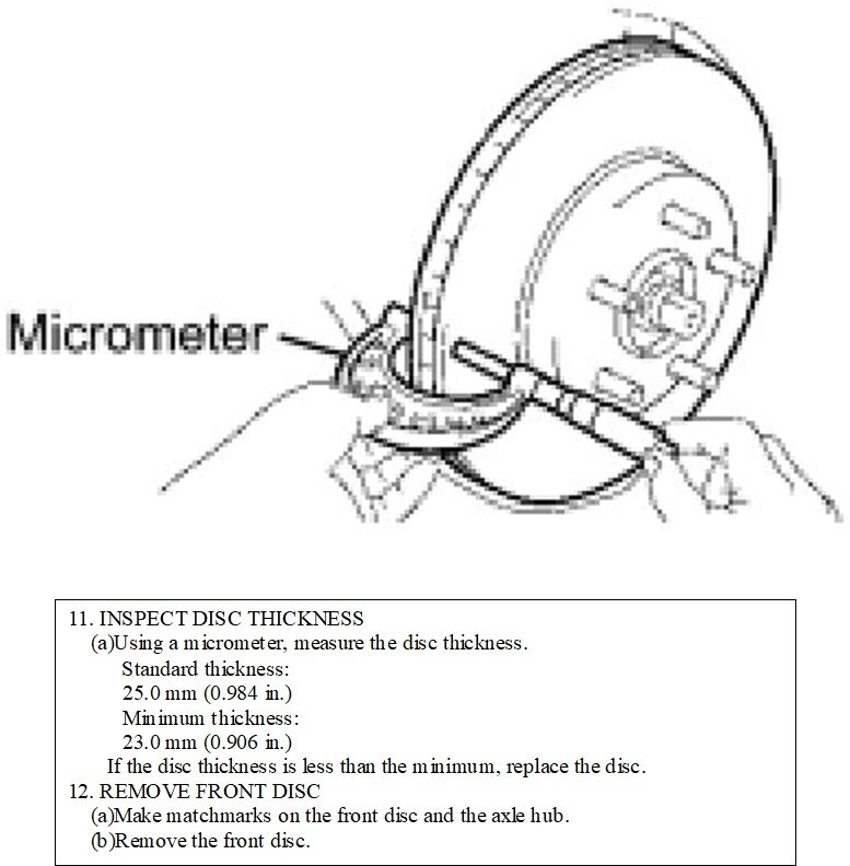

Checking the rotors is next. If you had any pulsation in the brake pedal, the rotors have excessive thickness variation. Machining them will take care of that, but you must also consider the overall thickness. Every model has a published legal thickness the rotors can be machined to, then often there's a slightly smaller dimension they can be allowed to wear to. Those specs are called the "machine to" spec and the "discard" spec.
Rotors start out really thin today to save weight, but that means they may be under the legal limit if machined just once. The good news is new rotors have come down so much in cost, it's often a better value to just install new ones. One word of warning though. Most new rotors come from China. There's nothing wrong with the quality, but when we make parts from cast iron, we set them aside for three months to "age" before they get their final machining. Those made in China are cast, machined, packed, and shipped, then they age on your car. It's real common for them to warp in that first 90 days. A light machining at the store where you bought them will take care of that. People who demand new rotors under warranty usually run into the same problem in another three months.
Check the hub and the rotor's mounting surface to be sure no rust, scale, or debris gets stuck in there. Same with the rotor's outer mounting surface where it contacts the wheel. Any debris that gets in there will cause either a wobble in the wheel or a wobble in the rotor and wheel. Use some of that brake grease around the rotor's center hole and the hub it sits on.

Dec 7, 2022 at 6:25 AM
TEDANDJEAN
To answer your question, I am just trying to replace the brake pads. I am not trying to replace any broken parts. Starting in the fifth paragraph you said, "First let me post the instructions from Toyota for the 2wd model. Read through that all the way first because there's a lot of information that is confusing. I'll elaborate on that next... Right off the bat, skip steps 2 and 3a." I don't think you posted these instructions from Toyota, so I imagine I need to read these in order to proceed. Can you please post them? Thanks.
Dec 7, 2022 at 11:55 PM
TEDANDJEAN
Oh, I just realized that the images with instructions at the bottom of your post must be the "instructions from Toyota." I'll try to figure that out and re-contact you if I need more help. Thanks.

Dandy. To be able to post the instructions, I have to copy and paste them in sections into my MS Word typing program, format them for size where I make them larger for easier reading, then they have to be copied into MS Paint where they can be saved in a format that can be uploaded. When I have extra time, I fix some of the indents and numbering. Other times I just try to get as much information to you as possible, and let you deal with making sense of it. I used to try to read through the instructions first, but that led to more confusion and the chance of accidentally inserting a mistake. Now I just leave what the manufacturer posted alone.
These drawings and instructions are right out of the manufacturer's paper service manuals, so if you become confused, imagine how mechanics feel.
There's also a lot of blue links that lead to side notes or how to do part of a job. It's pointless to try to include all of those. Finding all of them could take days and really make it confusing. Instead, you simply need to ask for any clarification, or ask me to find one of those notes and post them for you. I'm here almost every day and will be happy to do that for you.
