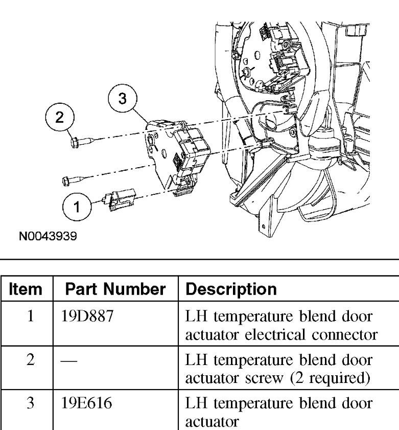

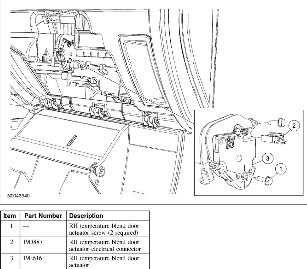

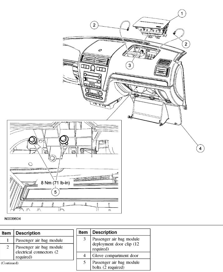

Are both behind glove box? I am trying to do this with a bad shoulder. Any advice would be greatly appreciated. Thanks
Mar 8, 2021 at 9:55 AM
STEVE W.
  • 15,349 POSTS
The left side actuator is on the left side of the HVAC case, you can get to it from the drivers footwell. It's above the accelerator pedal. Remove the screws and it comes free. Install the new one and tighten the screws. The right side is a bit harder. It's behind the airbag module. To get to it you open the glove box, remove the two bolts that hold the airbag in the dash and push up on the air bag module. With it held out of the way you remove the screws from the actuator, reverse the process to install the new one.
Mar 8, 2021 at 7:32 PM

Would messing with the airbag make it go off?
User comment: No because on are 2007 Ford Fusion they’re both on driver side. The passenger side is on top of the driver side.
Mar 8, 2021 at 9:03 PM
STEVE W.
  • 15,349 POSTS
Nope. The bag itself has no sensors in it. If you wish you can pull the fuse for the bag system, it's in the fuse block under the left side of the dash. It's fuse F25. With it out the bags will not have trigger power. Just be sure to reinstall it.

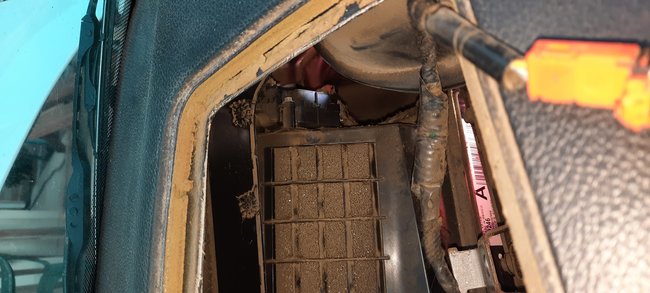

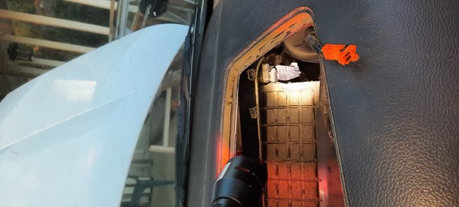

Take a look in through the glove box opening. The actuator you are looking for will be on the left side of the opening. Behind the area the airbag was mounted.
Mar 11, 2021 at 9:29 AM
DRYNOODLE
  • 28 POSTS

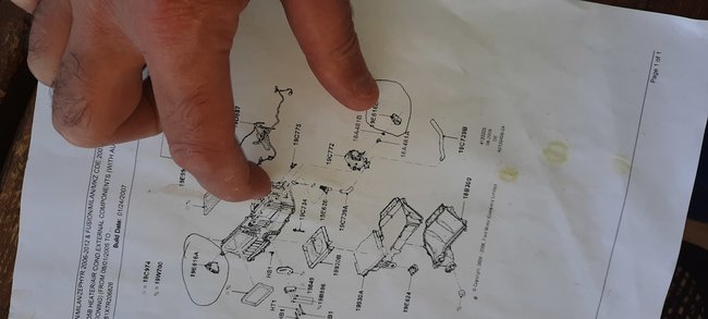

I promise you there is no actuator where you're telling me. It's where that picture is and one above gas pedal. I have looked and looked. Wish it was where you're saying it is but it isn't.
Mar 11, 2021 at 10:35 PM
DRYNOODLE
  • 28 POSTS

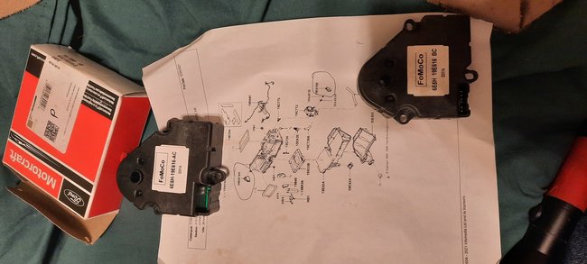

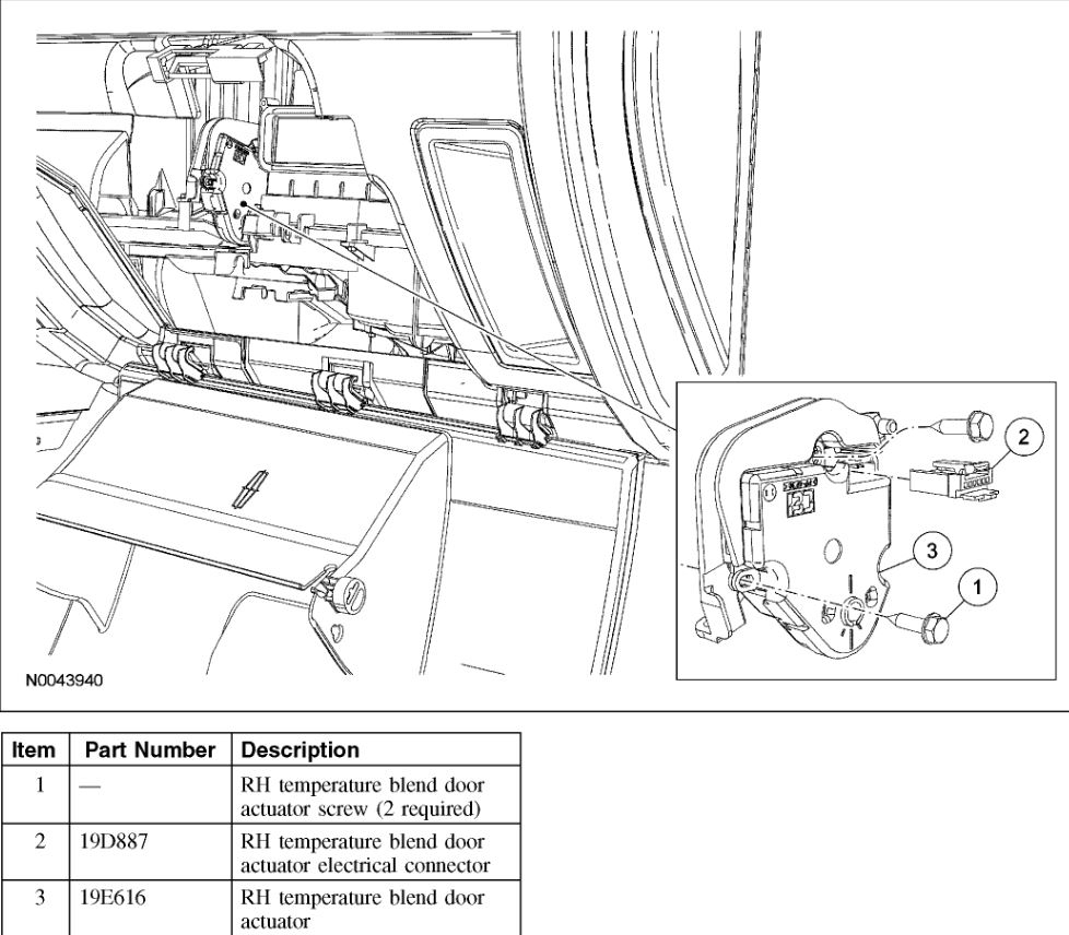

This is from Ford when i picked up parts. Thumb is actuator and index finger is where it goes.
Mar 11, 2021 at 10:52 PM
STEVE W.
  • 15,349 POSTS

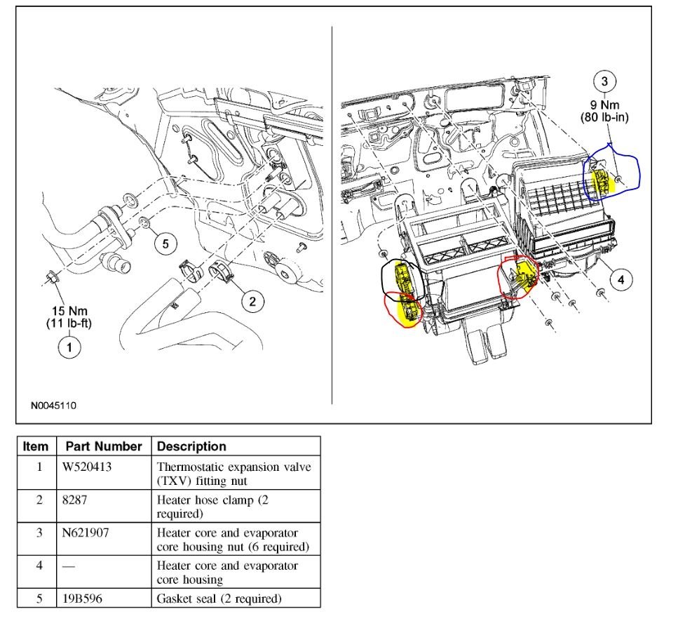

There is one on the end where you show but that is the recirculate actuator. The image shows looking at the rear of the dash. The one you have in your pictures is the recirculate actuator at the far left of the image. The temperature actuator is farther over. It should be visible in the top left of the glove box opening. The second image shows the blend door at bottom left, mode actuator above it. Then the passenger blend door on the opposite side of the case and the fresh/recirculate actuator at the top right.
BUT something I didn't ask and just assumed from you asking for both blend doors, Does your car have dual zone heating where you can set passenger and drivers sides at different temps? If not then that is the problem, it only has the single blend door actuator above the gas pedal. Then the mode door above that and the recirculate on the other end.

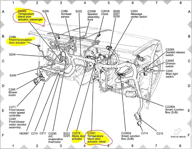

STEVE W.
  • 15,349 POSTS
Okay, if it's single zone there are a total of three actuators. There are two on the left end of the HVAC case above the gas pedal. The bottom one is the blend door which controls the air temperature out of the case. The one above it is the mode actuator, it controls where the air goes, either floor, dash vents or defrost (or mixes of those depending on setting) the one on the far right that you took a picture of is the recirculate actuator. It controls where the air comes from. With it in the normal position the air comes through the outside vents and into the case, with it in the other position it pulls air from inside that cars body and runs that through the case.
If you cannot select floor/dash/defrost air then it's the top unit over the gas pedal.
If it's that you cannot control hot/cold air temp then it would be the lower one on that same side.
If you cannot control if it's outside air or inside air then it would be the one that you had in your picture.
The sheet you got from Ford shows the blend actuator on the left side and the recirculate actuator on the right.
What is the actual issue you are having with the heat/AC?

It now blows hot when the A/C is on and the defrost quit blowing. Both started at same time. I have hot air coming from vents but no defrost and no cold air.
Mar 12, 2021 at 8:36 AM
STEVE W.
  • 15,349 POSTS
Okay, that would be the two actuators on the drivers side. The blend and mode. You should be able to watch the linkage on the mode actuator and see if it's moving as they use external plastic pieces to move the various doors. The blend one however just slides over the shaft behind it so nothing to really see.

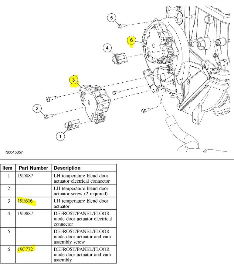

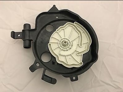

The passenger side would be the recirculate door and it's working. Except if you had the dual zone heat/AC. then there would be an actuator as I originally said.

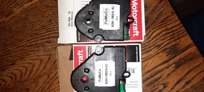

The blend door number for your car should be # 6E5Z-19E616-B and is in the second image while the mode door unit is # 6E5Z-19C772-A and the last two images
The blend door part is a bare actuator but the mode door has a cam assembly attached and those like the come off or break.
To replace them you need to remove the lower motor first, so the blend door, then the mode actuator. To reinstall you want the mode door pins to fit into the slots on the cam on the back of the actuator.

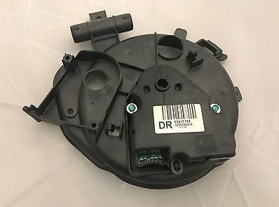

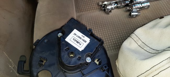

Do i pull the actuator off of this before i install? It's hanging on that in between steering column to get off.
Mar 20, 2021 at 3:54 AM
STEVE W.
  • 15,349 POSTS
You have a temperature issue correct? The part you have pictured is the mode door part, selects between floor/dash/defrost. The temperature control part is the one below it that comes as a bare actuator without the cam housing.

Both are not working. I pulled the temp out. The mode is another one not working. It blows hot air and defrost doesn't work. They both are getting replaced. The mode is unscrewed/unwired but isn't coming out due to that darn steering wheel column being in the way. Any advice on getting it out and new one back in? I mean brake lever not steering column.
Mar 20, 2021 at 4:39 AM
STEVE W.
  • 15,349 POSTS
Okay, you already removed the blend door at the bottom correct? With it out the mode door takes a bit of wiggling around to move it, worst case you could disconnect the pedal from the hanger and pull it sideways, or just brute force it out a bit. Just be aware of the switches on it.

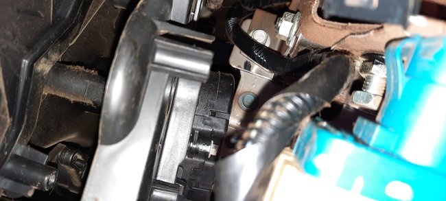

It keeps hanging on the levers that opens up/shuts it etc. How much would an able-bodied mechanic usually charge to do this?
Mar 20, 2021 at 4:54 AM
DRYNOODLE
  • 28 POSTS
Here it is. It's hitting the welded bracket.
Mar 20, 2021 at 4:56 AM
DRYNOODLE
  • 28 POSTS
Got it in but the defrost still not kicking on. It's stuck on the vents blowing towards me. It gets cold/hot but no defrost. Any advice?
Mar 20, 2021 at 8:57 AM
STEVE W.
  • 15,349 POSTS
Sounds like the mode cam isn't seated properly. It moves all of the doors in sequence and can be a pain to get just right when you're standing on your head because of the pins and levers that need to follow the correct tracks inside the cam. I normally try to look at the timing marks on the cam and then set the arms to match them. Even then it can take a couple tries when they don't cooperate.
